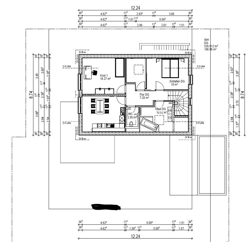

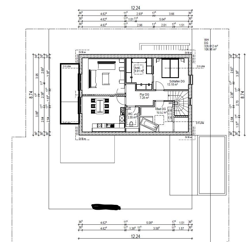

Topic Granny flat / Living on the ground floor:
I think we now have a good opportunity to live comfortably on the ground floor in old age.
The balcony is planned as an option and can easily be built with 1-2 support columns (on the west side).
On the upper floor, there is an option to live as a couple, possibly with a (small) child.
This would be a nice 2-3-bedroom apartment with kitchen/dining area, living room, and bedroom with walk-in closet.
We don’t want more than that anyway; I certainly don’t want to create a proper granny flat of 65sqm (700 square feet) for 5 people, who would end up living on top of me.

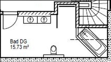

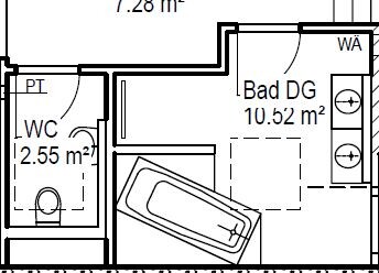

I sketched out our ideas for how the house might look for us as we get older, entirely by myself, just using copy and paste—nothing from the architect.
I like it this way; perhaps the load-bearing wall could be moved to create a large living/dining area.
Also, I’ve been reconsidering the placement of the toilet inside the bathroom. I’m still a bit undecided.
I’ve uploaded one blank bathroom layout and two designs with the correct dimensions. The wall on the north side can, of course, be extended, and the wall on the east side can be removed or left as is.
Maybe someone has an idea of how to best solve this.
What’s important to us:
A built-in shower with a spiral or at least 1m*1.4m (3.3ft*4.6ft)
Bathtub
Double sink with at least 2m (6.6ft) clearance to the back wall
Toilet (preferably somehow separated with a door to the hallway and the bathroom)
Laundry chute must be accessible.
