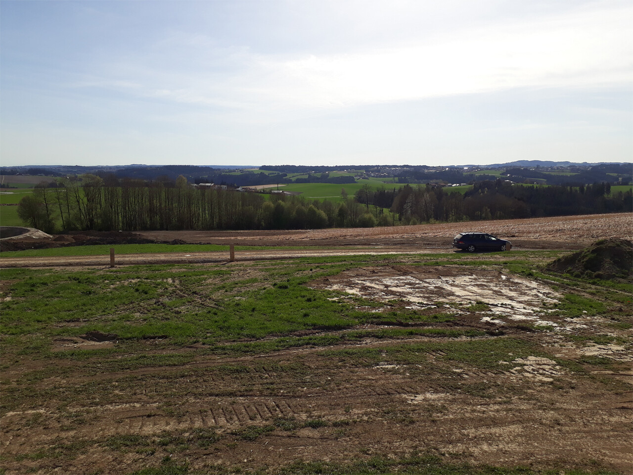

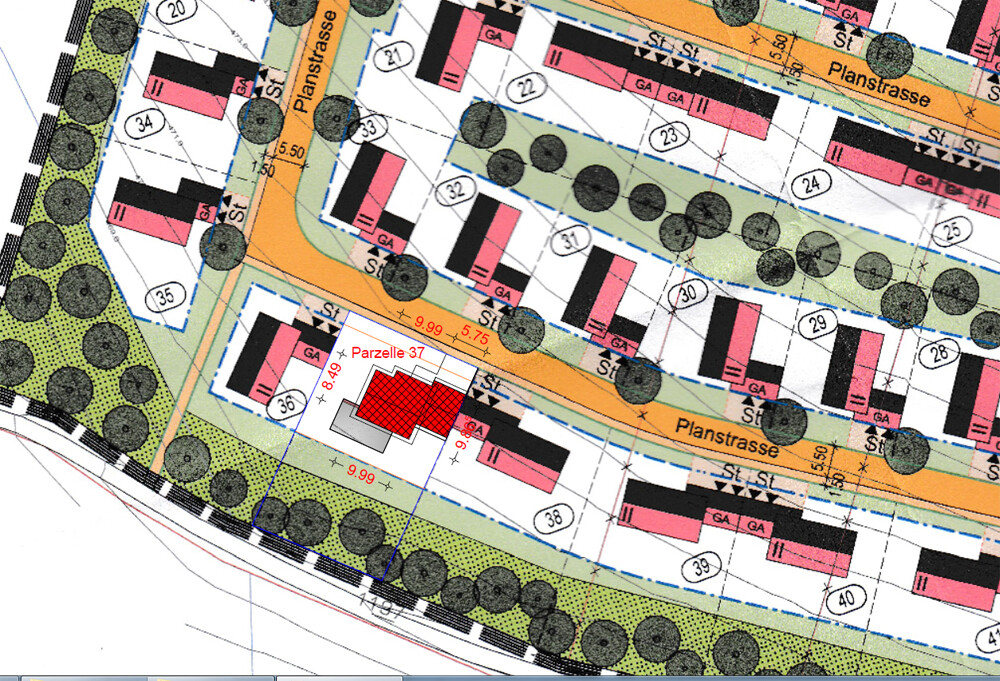

Attached are the site plan and a photo of the earth mound where the house will be built, looking south. The roads are currently being constructed—the development will take about another 2-3 months.
