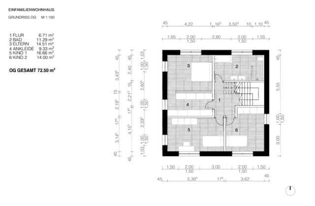

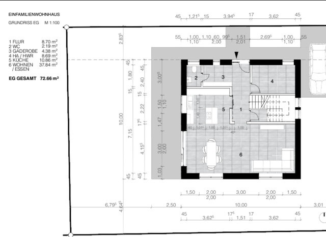

After what felt like forever, we finally received the floor plan (without exact dimensions) today from our preferred general contractor. Although the planner noted our requests during the meeting, some of them don’t seem to have been fully incorporated.
The price offer will be prepared once the floor plan is finalized, especially if the size increases.
I would like to share the floor plan with you and hear your suggestions for improvements!

The general contractor’s planner asked about our preferences and created the floor plan accordingly. Apparently, an office didn’t fit. The requirement was that we ideally don’t want more than 150sqm (1615 sq ft), a kitchen size of at least 13sqm (140 sq ft) would be nice, and if possible, no straight staircase.
What makes it particularly good or bad in your eyes?
The hallway seems to take up too much space without much utility, the kitchen feels too small.
The walk-in closet is “enclosed” and should be accessible via the corridor.
We like that the children’s rooms are exactly the same size. The future child planning is currently flexible.
How can we make the kitchen accessible through the hallway and semi-open, without making it too small?
Would a different staircase allow for a better layout?
Or are our wishes not feasible within 150sqm?

The specification was a maximum of 150sqm (1,615 sq ft), currently the architect has planned about 140sqm (1,507 sq ft). I would make the house 1 meter (3.3 feet) longer. For your room requirements, 140sqm (1,507 sq ft) is too little. You can see it here: the living area feels cut off.
The staircase could use 20cm (8 inches) more space, with the rest added to the living area.
The wardrobe is not sufficient for 4 people: simply deepen the niche by 30cm (12 inches) (at the expense of the adjacent room, but a kitchen can also benefit from that). Behind a sliding door, there will then be plenty of storage space, which can hold your shoes on two rows in the lower section.
The kitchen layout should be roughly planned directly in the drafts with workable options (it is missing again), including a patio door where it is actually needed, right at the kitchen workspace.

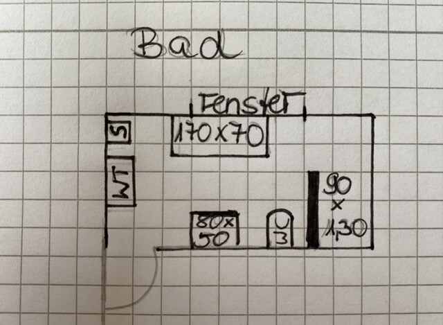

Upstairs, I would place the children’s rooms facing south and west. The bathroom needs to be rearranged – as it is now, you stand with your back to the daylight and the toilet is on full display.
Ideally, the bathroom should be positioned above the downstairs toilet. The shower spot is poorly chosen, which makes the bathroom quite small.

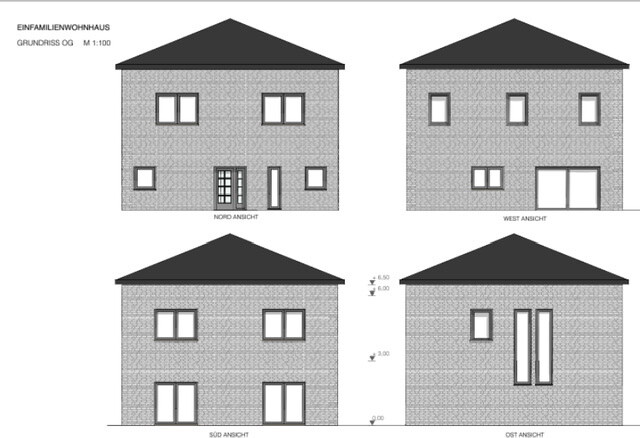

The elevations are not the worst. However, more attention should be paid to the eastern sunlight. Maybe consider fixed glass walls in the kitchen.
I would make the house 1 meter longer (3 feet 3 inches).Personally, I would prefer to completely rethink the design – it clearly focuses on the facade and is obsessed with a square shape.https://www.instagram.com/11antgmxde/
I would prefer to completely scrap the design – it is clearly focused on the facade and obsessed with square shapes. Good thing I’m not obsessed with squares..

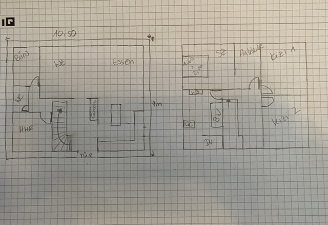

I gave it another try myself..
And tried to draw it on paper..
Would the staircase work without hitting your head when going to the bathroom?
