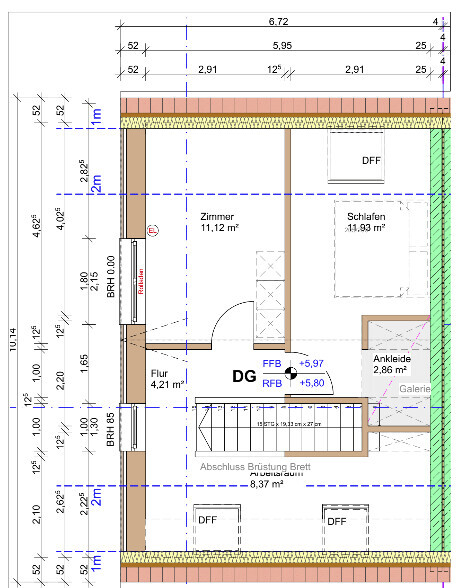

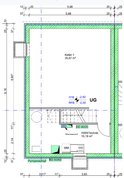

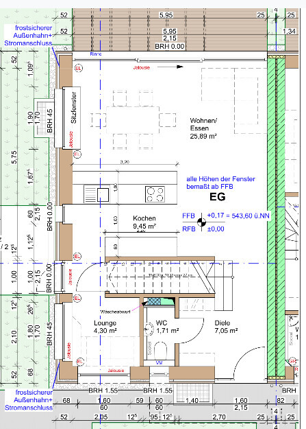

True, you can’t tell from the resolution. The staircase is 3.75 m long (12.3 ft).
The lounge is intended as a small retreat space—for reading a book, taking a nap, or similar.

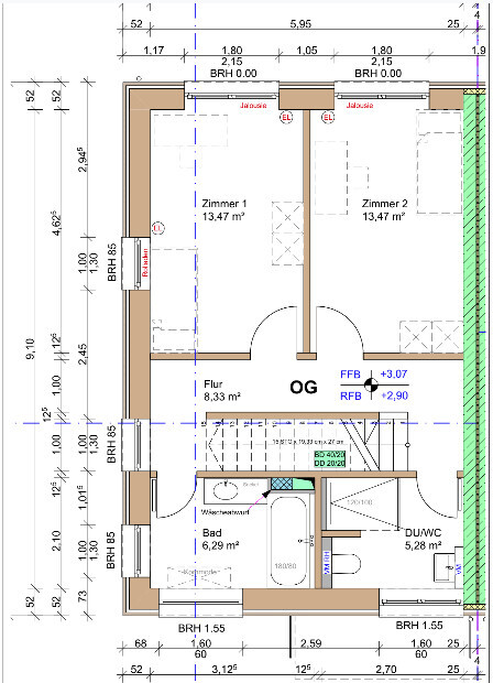

A bathroom in the attic created a conflict with the sloping roof. There was consideration to design a bathroom accessible from the bedroom. However, this would limit use for everyone else.
In the workspace, a countertop runs along the entire length. It serves as an office, craft, and sewing area. There was a nice example of this online.
The staircase is too short. One more step wouldn’t be a luxury. I would consider a different staircase design. Somehow it divides the house into two parts. The first part feels a bit like leftover space to me.
The workspace is nice, but definitely not 5 meters (16 feet) long. Also, cabinets and storage space are missing. To me, it seems more like a makeshift solution.
The shower should fit upstairs, though. Instead of a walk-in closet, you could have a small bathroom.
I find the lounge very small, and the kitchen could use a bit more space. Especially since you have your quiet retreat upstairs.
I find the floor plan unusual, but unfortunately not necessarily for the better. You don’t want something standard, which I appreciate, but this isn’t really working either. What is the purpose of the second room in the attic?
Hmm, I think the workspace in the attic is fine for parents' hobbies, like crafting, setting up PCs, the sewing machine, etc. The kids should stay downstairs since they already have their own floor. I would also try to fit a shower bathroom upstairs because I don’t want to have to go down the stairs if I need to use the bathroom at night.
The biggest drawback I see is actually in the living room — don’t you have a TV? Where would it go? There is also basically no storage space there. Or do you not have any furniture? That can happen too.
