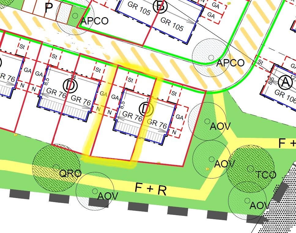

Building window, building line, and boundary according to the development plan
Edge development: a green strip with a sidewalk, otherwise only paved roads and public parking spaces

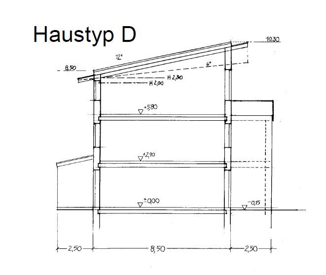

Orientation of deep gutter: slope to north-northeast, 12° pitch
Maximum heights/limits: low side 8.50 m (28 ft), high side 10.30 m (34 ft)

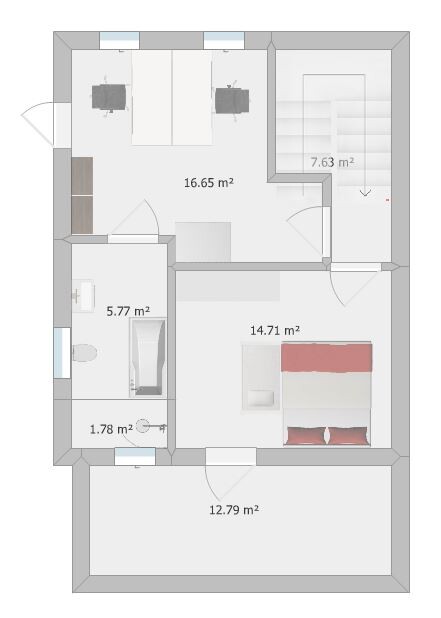

Originally, we set the wall thicknesses much too thin in Roomsketcher (the program used to create the sketches). After adjustment, we had to redesign everything, including the stairwell location. We have not yet planned the basement for the new design since the architect appointment is soon anyway.
Also, the bathroom door’s layout and position are not ideal; we might still swap the office and the master bedroom. The idea was to avoid the home office getting too much afternoon sun and overheating. The same applies to the bedroom; you don’t want to go to sleep in a heat trap in the evening.

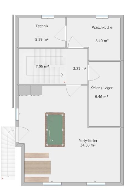

The basement will no longer be built as planned; the external stairs have already been scrapped. Only the general layout will remain roughly the same.

A few measurements would greatly improve the plan.
And why do you want to omit the exterior stairs to the basement? The basement stairs themselves are in the wrong place and don’t fit with the other floor plans.

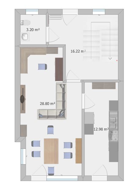

In general, I think there are far too many curves in the rooms. For example, the living room and the entrance area... but, as I said, a few measurements would be helpful. Plot of land... how wide is it? 17.5 m (57 feet)? I assume the site plan is oriented to the north.
Office... is it for two people working from home? Wouldn’t it make more sense to plan two separate offices, and then one could also serve as your playroom?

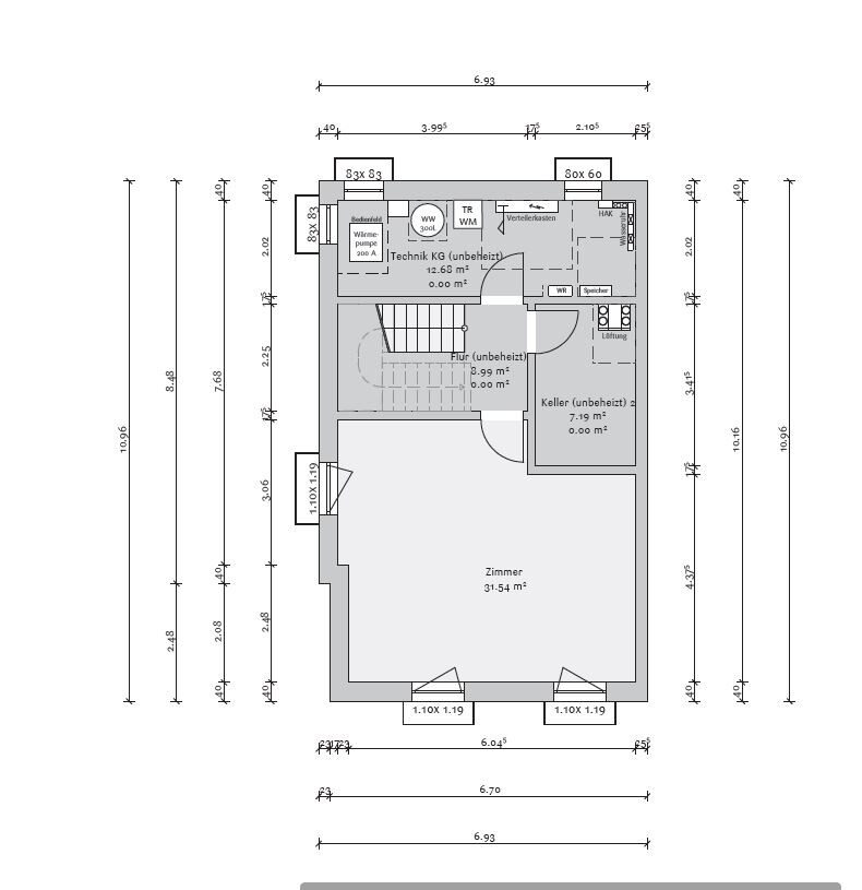

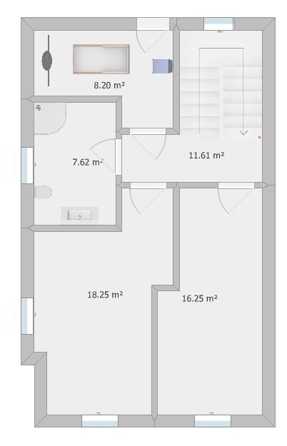

Hitokiri-19789 Sep 2022 17:49Sorry, I’m adding a floor plan that at least shows the exterior dimensions. BUT!! This is the old floor plan, and the layout there is now outdated!
In general, the semi-detached house can be 7m (23 feet) wide and 8.5m (28 feet) deep/long. Additionally, there is an extension of 2.5m (8 feet) which, due to an unnecessary offset of about 20–30 cm (8–12 inches) required by the zoning plan architect, increases the interior dimensions. So roughly, you can calculate a footprint of about 7m x 11m (23 feet x 36 feet). We could have had 40 cm (16 inches) exterior walls but decided on 34 cm (13 inches) walls instead, which only have 6 cm (2.4 inches) less polystyrene insulation. According to the U-values provided by Haas, the difference is minimal. It should provide slightly more (just under 4.3 sqm (46 sq ft) in the entire house).
11ant schrieb:I forgot to mention that. Since the contract award date, we have been in contact with them. They are also building with Haas, want to fully use all dimensions, and are also building with a basement like us. As a result, we now have a quote for the basement including excavation. We have also arranged the surveying together. The shared wall will be built more like an interior wall without additional external insulation, which means it will function for both parties more like an exterior wall. I hope you understand what I mean. This saves materials and provides a small increase in interior space.
but not with your neighbor
kbt09 schrieb:7m x 11m (23 feet x 36 feet) footprint, 34 cm (13 inches) exterior walls, maximum height: 10.3m (34 feet).
A few dimensions would really help the plan.
kbt09 schrieb:Cost factor. I would like to have them included, but sealing the last step before the door is apparently quite complex. It was said that it would cost around 7,000 euros. Plus, we would probably only use it 1–2 times a year.
And why do you want to leave out the outside basement stairs?
kbt09 schrieb:Yes, as I said… we had to redraw the floor plans and forgot the basement. Since we hopefully have the architect’s appointment soon and already know what we want, we can discuss it with him directly. I only included it here to give an idea of the room layout.
The basement stairs themselves are in the wrong place and don’t match the other floor plans.
kbt09 schrieb:Why not? I hardly ever make phone calls and almost always wear headphones anyway. Also, it feels more like a work environment that way than sitting alone in front of colorful Excel sheets right next to the PlayStation... 😉 No, it will be clearly separated. Also… who else is going to bring me coffee if not my personal assistant aka my wife 😀 :p
Office … home office for two? Wouldn’t it make more sense to plan two separate offices, and then one could be your gaming room?
Well, the dimensions would also be helpful for the other floors. It’s quite tedious to calculate the room widths and so on now. I think it’s a bit tight.
So, how wide is the plot exactly? 17.5 meters (57 feet) or so? That would leave 3.5 meters (11.5 feet) for the garage width? Is it supposed to be a prefab unit, or should it share the exterior wall of the house? And does it have to be a garage?
Basement exterior stairs... lawnmower? Bicycles? Have you thought about this?
And if you all get along well at the office, then it could also become a gaming area in the evenings and on weekends. Why such a small extra space?
