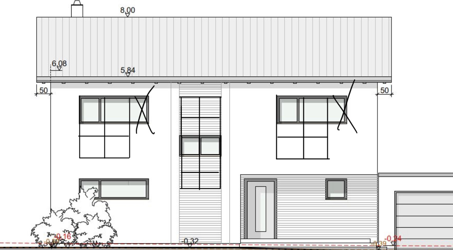

Karl-Jupp6 Dec 2022 21:01Dear forum members, today we would like to present our floor plan and hope for positive feedback and suggestions on possible improvements. Our basic wish is for a bright house with 4 bedrooms on the upper floor and a living-level basement designed to accommodate 2 offices. We see the basement as necessary, especially due to the sloping site. The ground floor will then provide a spacious living and kitchen area. We have now received the first plans from the architect and would like to optimize them as much as possible with your help. The furniture layouts are only examples and still need to be finalized. Note: The room labeled as an office on the upper floor is intended to become Child 3’s bedroom. The guest room in the basement will be a combined guest/office room. The design of the outdoor areas, such as the terrace and the shape of the new property boundary, still needs to be planned in more detail.

Sunshine3876 Dec 2022 21:12Personally, I would swap the children's bathroom and the master bathroom, and make both accessible from the hallway. I would also extend the garage to the maximum possible length of 9m (30 feet) to have enough space for all gardening tools, groceries, etc., since the utility room is quite small. Additionally, it makes sense to have the sofa area at least 4m (13 feet) wide to create a better sense of space.

Sunshine3876 Dec 2022 22:27And a comment on the exterior appearance: I wouldn’t like all these many different narrow windows at all. Some are oriented horizontally, others vertically, which in my opinion creates a lot of visual clutter. I would choose much larger windows and also a 3m (10 feet) high window in the stairwell. With plenty of natural light, the house feels much more comfortable, and you’re not just looking through narrow slits.
