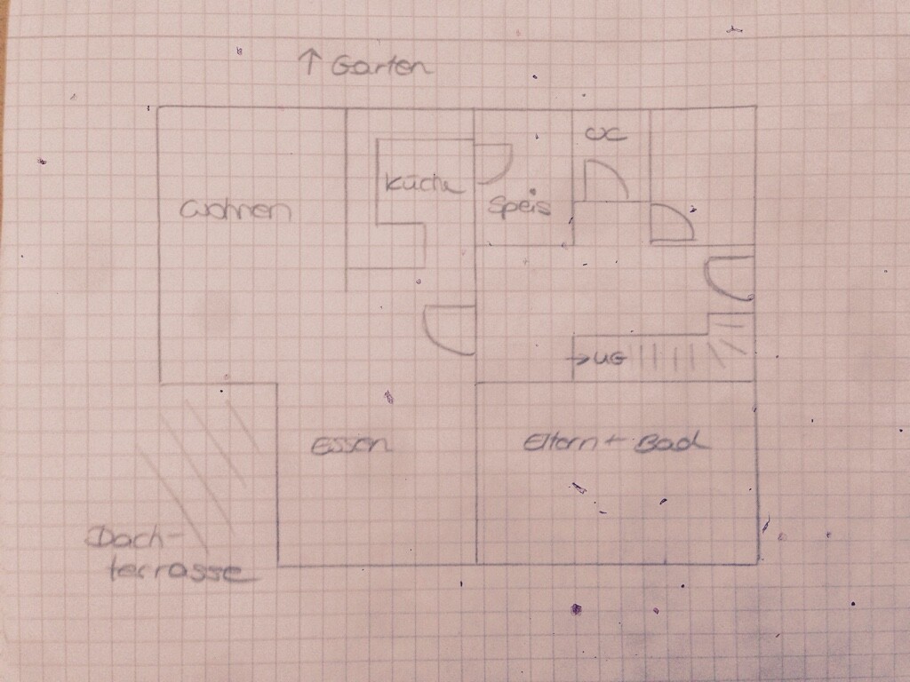

I would design the ground floor somewhat like this. Just a quick sketch... Maybe place the stairs in front of the pantry, and position the toilet more centrally?!
Definitely try to include a small room for a child on the ground floor. If space is tight, you could possibly remove the pantry and later separate it with a drywall or similar.

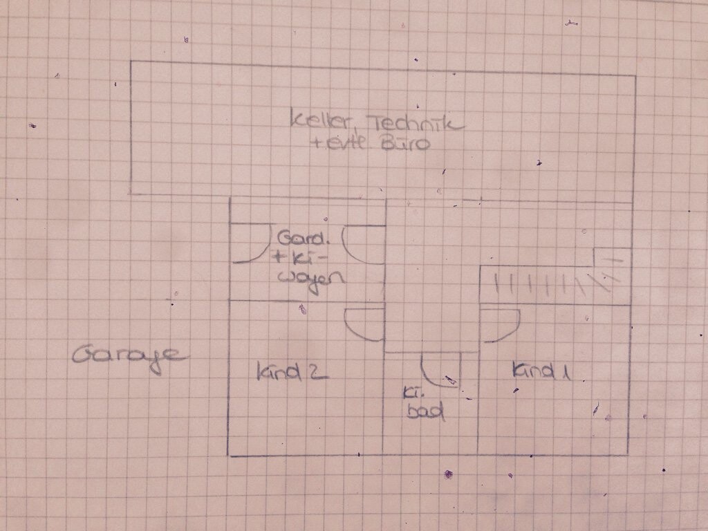

In the basement, have access from the garage to the cloakroom, stroller parking, etc.
Just an alternative layout idea – no guarantee that the space will actually be sufficient.
