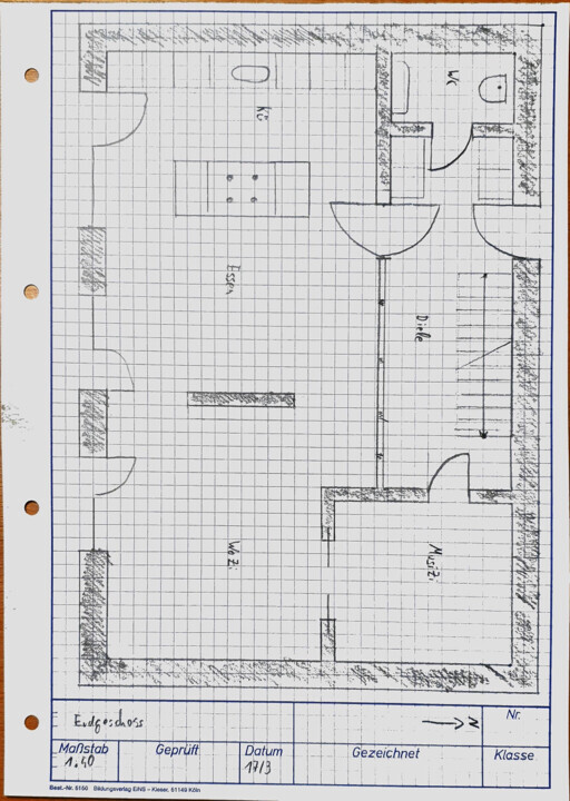

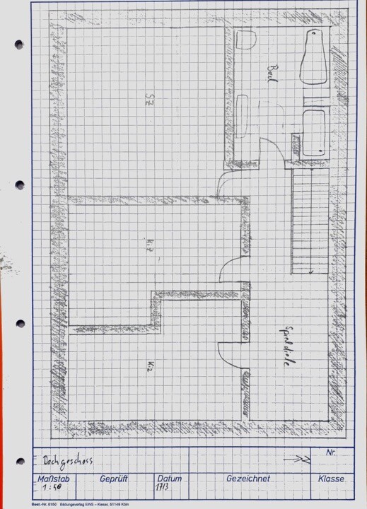

Hello!
Here are our initial thoughts regarding our single-family home. I would greatly appreciate your comments (including critical ones). I will try to answer all questions promptly.

What do you particularly like? Why? The open and transparent architecture on the ground floor, the clear southern orientation
What do you not like? Why? Perhaps it is a bit too small, so we might make it one meter longer. We can only fit the home office & guest room in the basement.

--> Perhaps a quarter-turn staircase would be better, as it would provide additional space for the music room on the ground floor and allow the play area upstairs to be separated from the staircase by a railing.
--> The basement is still not fully planned.
If you have to give up any details / expansions:
- you can do without: the design is already very simple; if necessary, the guest bathroom in the basement and the kitchen island. An L-shaped kitchen would probably also work.
- you cannot do without: the music room and the WC on the ground floor.

What do you consider particularly good or bad about it? --> The open architecture on the ground floor and the (almost) equally sized rooms upstairs.
What is your constructive critical opinion of our design? What would you do differently?

Children’s rooms 1 & 2
Master bedroom
Family bathroom

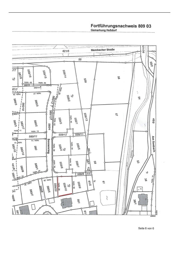

gutentag23 Mar 2022 09:58
I have drawn contour lines. Slope towards NNW at 5-6%.

RufusJWB schrieb:
We have a slight slope down to the north, about 1 meter (3 feet) over the width of the plot. My idea was to terrace it. That’s at least what our neighbors have done.
Yes, that can be done—create one level at 288 m (945 feet) and then set the finished floor level at around 288.2 m (946 feet). That way, the volume balance works out. But only if the soil is load-bearing.
However, you wouldn’t gain any daylight in the basement then, right?
gutentag23 Mar 2022 10:13
Does the development plan not specify ground floor elevations?

This causes some confusion among those replying.
I forgot to mention that I find the living room very uncomfortable due to the many openings, whether windows, doors, or passages. Too much is simply too much: the access points turn the room into a corridor.

I forgot to mention that I find the living room very uncomfortable due to the many openings—whether windows, doors, or passages. Too many openings simply make the space feel like a hallway.
Thank you for the feedback. I will discuss this with my wife. I could also imagine having fewer doors in the living room/kitchen area. Do you think the living/dining room would be more comfortable with a solid wall instead of the glass partition?

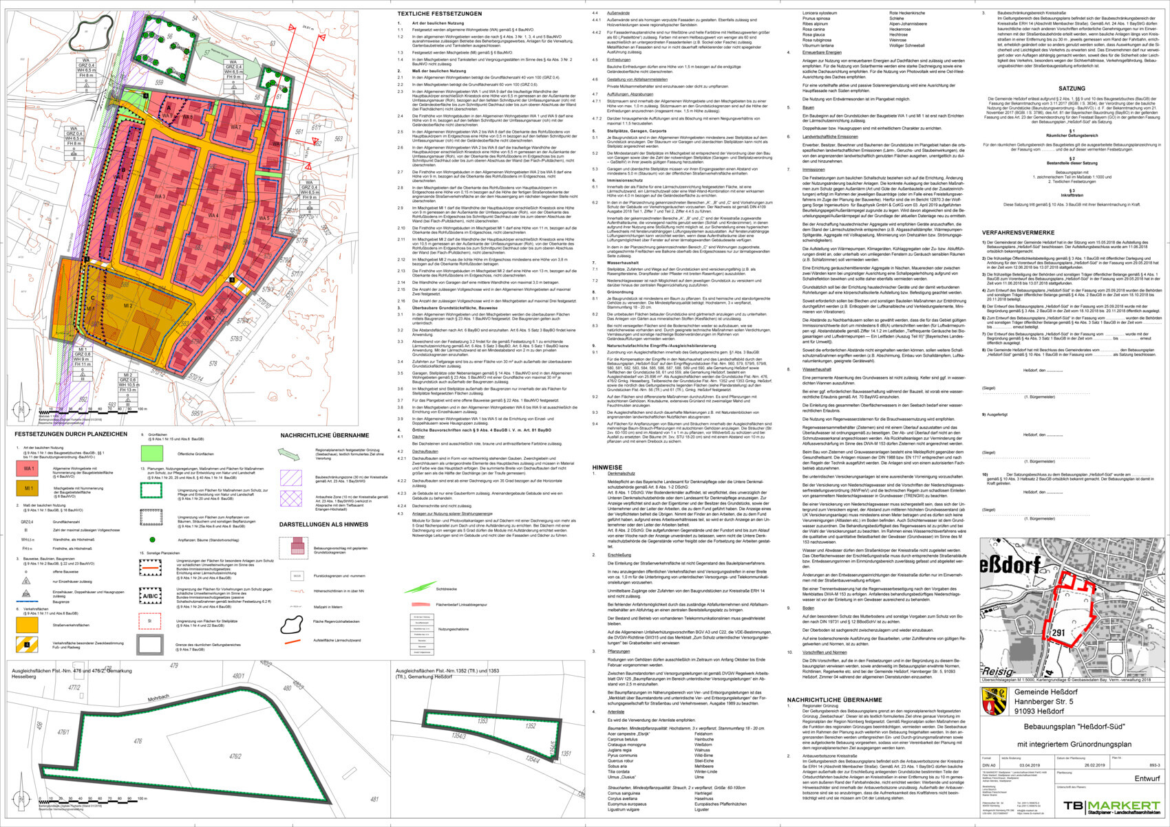

Yes, linking is not allowed here.
But you can use a snipping tool to crop the area of the development plan that includes your property and then upload that file. The same goes for the relevant text sections and the descriptions of the plan.
Good idea. Here is the development plan with the written regulations.
Land-use plan with colored zoning areas, legend, and text sections.
