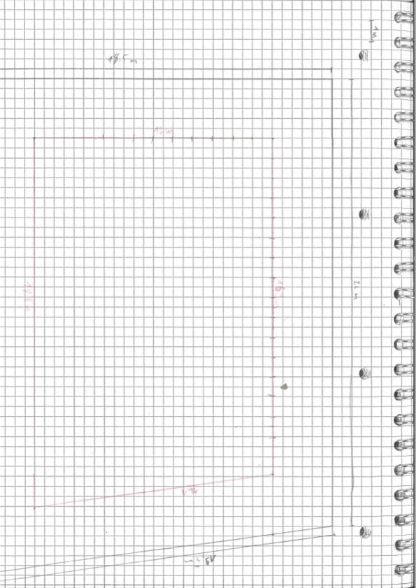

Please also show the plot with the planned house on it,
basement and upper floor,
north arrow A basement is not planned. It depends heavily on the location and shape of the stairs, so I decided not to include it in the plans. The plans for the ground floor and upper floor/attic should already be attached to the post. The roof will not be converted into living space.
The plot is marked in red in the cadastral map. Attached is a detailed view of the plot with the building envelope. North is on the right side of all plans.
I think your budget will be tight if you build with a basement. Not impossible, but definitely tight.
I find dimensioned digital plans much better, as I don’t have to manually count the grid squares on the screen. I believe you will get more feedback with digital plans.
After a lot of counting, here are my observations:
- Please upload a floor plan of the basement.
- You have one shower too few for 4 people once the children are older and spend more time in the bathroom.
- Frugality and “open and transparent architecture” are fine, but there should still be enough windows on the upper floor. Please include them in the drawings.
- The same applies to the ground floor — according to the plan, the guest toilet, hallway, and music room have no windows. I doubt that is correct.
- If I understand correctly, the hallway is separated from the living area by glass elements? That is neither simple nor inexpensive.
- The children’s rooms are narrow and elongated, making them less practical than their 15 sqm (about 160 sq ft) size (if I counted correctly: 2.5m × 5m + 1m × 2.5m (8 ft × 16 ft + 3 ft × 8 ft)?). Even a well-intentioned play corridor won’t help much here.
- You allocated a large portion of space to the master bedroom with more than 21 sqm (about 226 sq ft). Children spend significantly more time in their rooms than adults do in the bedroom, so consider whether this is balanced according to your priorities and plans.
Overall, I like the ideas for the ground floor, but I find the upper floor room layout and the proportions between the rooms unsuitable and not well thought out.
