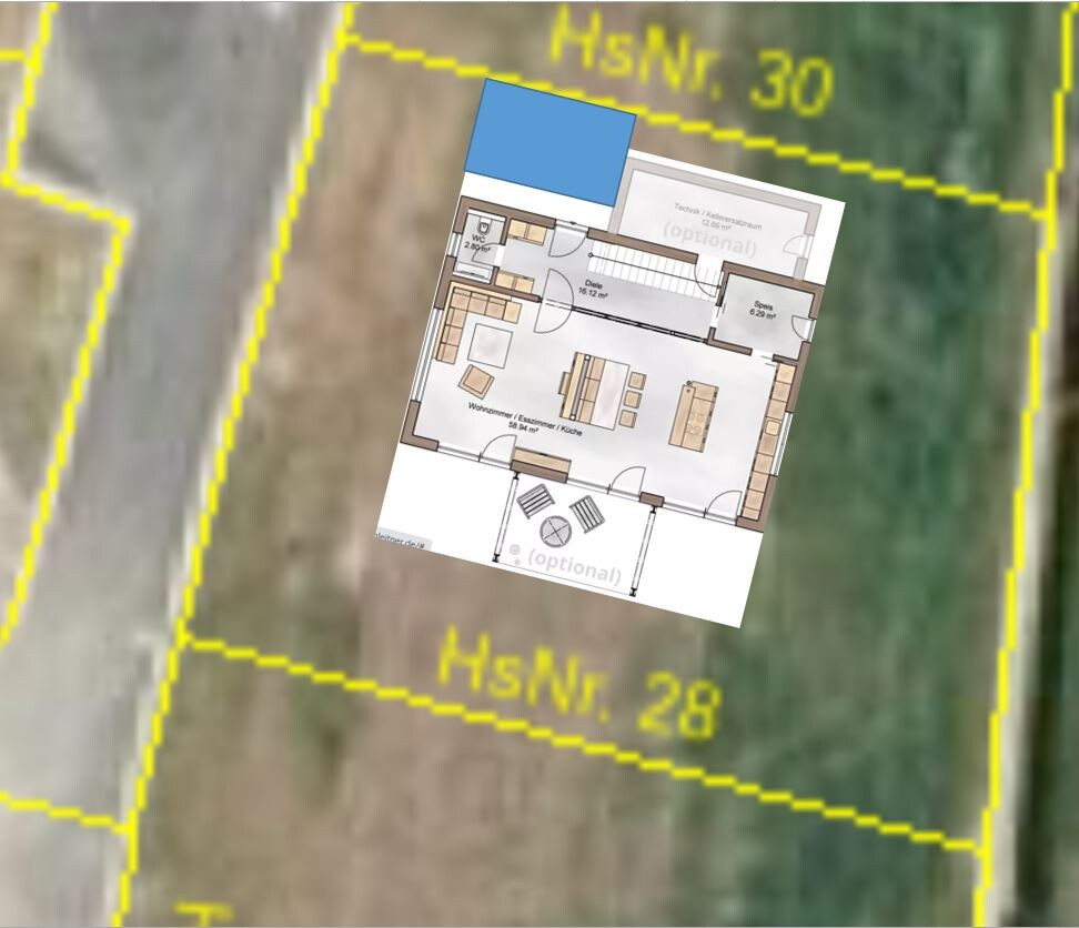

SoL schrieb:
P.S.: You could simply rotate the scan 90 degrees before uploading it here to align it with north. Just a thought... Isn't the north arrow on the plan meant for that? So you can always tell where north is without having to rotate the plan? I am just an interested layperson, though.
Joker. The text field in the drawing says the draftsman’s name is "->Z". It’s almost like brain exercise to imagine that as a rotated north arrow. Come on, really ... no way, right?Okay, that was indeed a bit confusing. Sorry for the misunderstanding.gutentag schrieb:
OK, the original poster was probably a bit optimistic with the drawing. According to the description, the linked building measures 12m by 8m (39 feet by 26 feet) externally. For a wooden house, I wouldn’t estimate the wall thickness to be 50 cm (20 inches).
@RufusJWB, do you have a quote from them?Not yet. We liked the floor plan and used it as a starting point with several suppliers. However, their proposals were not very inspiring. That’s why I started drawing myself.gutentag schrieb:
Here is a template based on the original poster’s details.
[ATTACH alt="Grundstueck107.JPG"]70401[/ATTACH]
[ATTACH alt="Grundstueck108.JPG"]70398[/ATTACH]
Is the exterior wall measured at 35 cm (14 inches)?
Short side according to the manufacturer: exterior 8.20 m (27 feet)I used the room layout as a starting point and then began adjusting the walls. The wall thicknesses are not final yet, especially since we do not know whether we will build with wood or masonry. For now, the focus is on the basic arrangement of the rooms.
