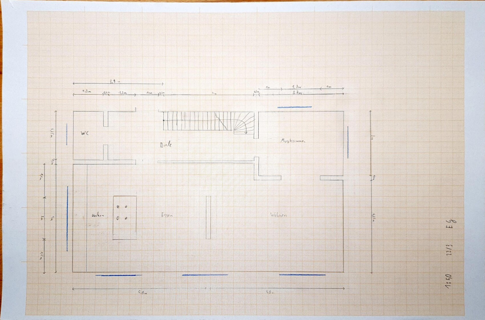

What do you particularly like? Why? The open and transparent architecture on the ground floor, the clear southern orientation
What do you not like? Why? Perhaps it is a bit too small, so we might make it one meter longer. We can only fit the home office & guest room in the basement.

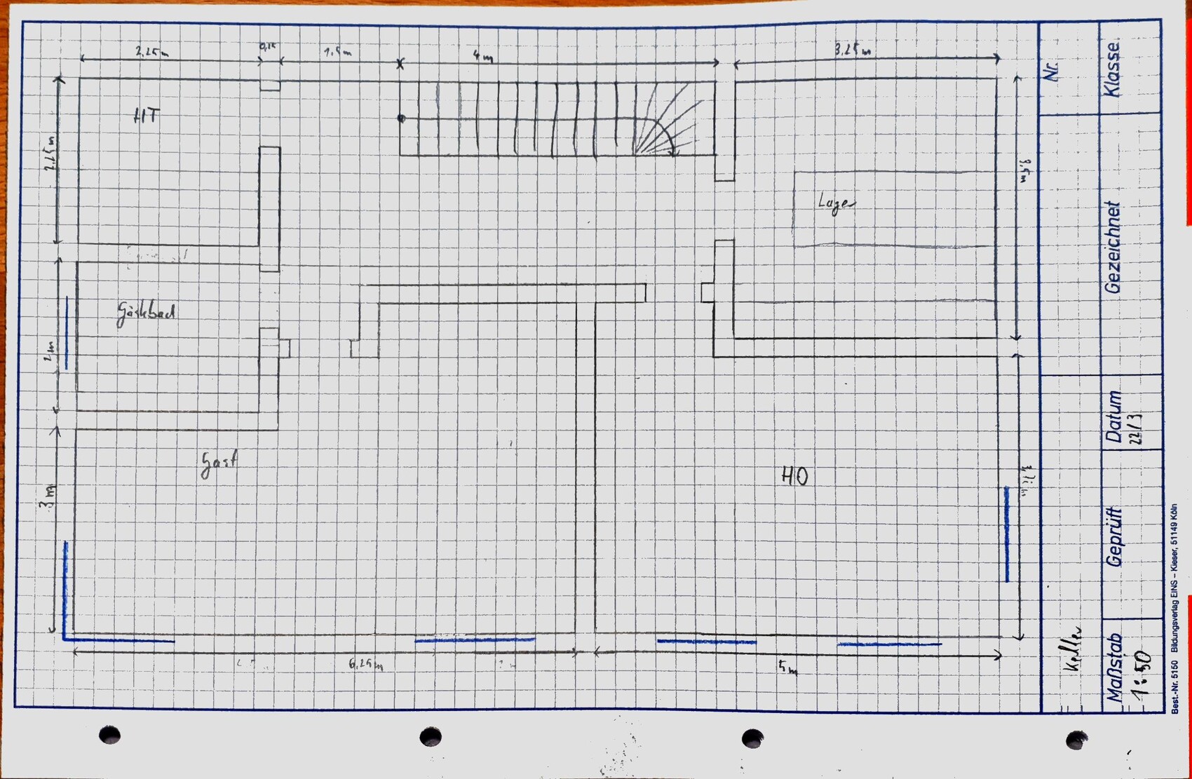

--> Perhaps a quarter-turn staircase would be better, as it would provide additional space for the music room on the ground floor and allow the play area upstairs to be separated from the staircase by a railing.
--> The basement is still not fully planned.

SoL schrieb:
I think your budget will be tight if you build with a basement. Not impossible, but tight.
I find dimensioned digital plans much better, so I don’t have to count squares on the screen. I believe you will get more feedback with digital plans.
What I noticed after a lot of counting:
- Please upload a floor plan of the basementAttached, including the revised plans for the ground floor and upper floor SoL schrieb:
- You have one shower too few for 4 people once the children are older and need more time in the bathroomThe second shower is in the guest bathroom in the basement SoL schrieb:
- Frugality and "open and transparent architecture" are fine, but there should still be enough windows in the upper floor. Please add them.
- The same applies to the ground floor: the toilet, hallway, and music room have no windows according to the plan. I doubt that is correct.I haven’t finalized the exact window layout yet. In the attached plans, I have them as SoL schrieb:
- The hallway is separated from the living area by glass elements, if I interpret that correctly? That is neither simple nor cheap.That’s correct. If it becomes prohibitively expensive, we will omit it. SoL schrieb:
- The children’s rooms are narrow and elongated, making them less practical than the 15 m² (if I counted correctly: 2.5 m × 5 m + 1 m × 2.5 m) might suggest. Even a well-intentioned play corridor won’t fix that.
- On the other hand, you took a large part of the space for the master bedroom at over 21 m². Children spend much more time in their rooms than adults do in the bedroom, so consider whether this ratio fits your planning and priorities.I have made the room sizes on the upper floor more uniform. All three rooms are now practically the same size. SoL schrieb:
Overall, I like the ideas for the ground floor, but I find the upper floor’s rooms and their proportions unsuitable and not well thought out.Do you prefer the new upper floor plan? SoL schrieb:

gutentag schrieb:
In my opinion, 12.5m (41 feet) by 8.5m (28 feet)
Exterior wall 50cm (20 inches)?
Without a basement, the utility room is definitely missing.The utility room ended up in the basement.gutentag schrieb:
According to the building coverage ratio (BYA), the plot is about 21 m wide. Where did you get the 18.5 m from? There is a 1 m slope towards the north, slight incline.I took the measurements from the cadastral extract.ypg schrieb:
Where is the wardrobe? I mean the cabinets with a depth of 60cm (24 inches), not the hooks for temporary clothing…
Thanks <3 for drawing on graph paper 🙂They are supposed to go to the right of the entrance.Similar topics
