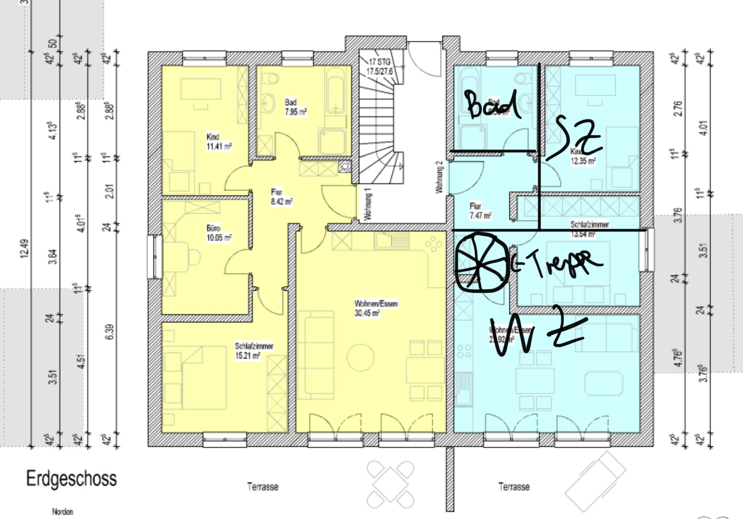

Good evening,
I am planning to build a multi-family house with 4 apartments about 30 kilometers (19 miles) west of Munich.
The house is designed to be 16 x 12.5 m (52.5 x 41 feet) and will include 4 apartments, each with 3 rooms and approximately 75 sqm (807 sq ft).
A basement is also planned, with space for the heating system, laundry rooms, and storage rooms for each apartment.
Unfortunately, the municipality requires 2 parking spaces per dwelling unit.
Plot size: 600 sqm (6,458 sq ft) available
House type: solid construction with 2 full floors and a basement
Heating: air heat pump
Ventilation system: yes
Photovoltaics: planned
What do you think of the floor plan? Suggestions for improvements and criticism are welcome.

WilderSueden16 Nov 2022 18:39Robii84 schrieb:
and then I have a new build and I’m the boss of my own plot and don’t have to coordinate with other owners, etc.But don’t forget that you will be a landlord and still have tenants in the building. You have to expect that someone might ring your doorbell right on time for the TV evening because of some problem.I have another idea. So far, the apartments are only on the ground floor and first floor, but maybe it’s also possible to sensibly place an apartment in the basement. The view of the parking lot isn’t great, but the slope should roughly allow windows without the need for light wells. Then you could distribute the apartments as 2 + 1 + 1.
Sunshine38716 Nov 2022 19:40The idea is not bad at all, but I doubt that the demanding Munich rental market would want to live exclusively in a basement at €15 cold rent per m2 (about $1.40 per square foot). However, what I think could work well is a kind of basement maisonette. You could convert the small 3-room apartment into a spacious 2-room apartment on the ground floor plus one room in the basement with a bathroom and storage. This way, you would definitely have around 90m2 (970 square feet) and could save some of the unnecessary basement space, since with 4 apartments plus technical rooms and bicycle storage, you really only need about half of the original basement area.
WilderSueden16 Nov 2022 20:21I wouldn’t focus only on people moving out of Munich. There are also people who have lived in the area before. One idea would be to design it as a studio apartment since it only gets natural light from one side anyway. It’s perfect for young people who want to move out of their parents’ home but don’t want a shared flat. If the size stays under 25cm² (270ft²), it would only require one parking space 😉
Sunshine38716 Nov 2022 20:42However, the ground floor apartment would then be 150 m² (1,615 sq ft) in size, and the original poster only wanted a 3-room apartment. I think that two 2-room apartments and two 3-room apartments fit the original poster’s wishes best. This way, you also achieve a decent rental yield and don’t end up building an apartment of 150 m² (1,615 sq ft) that you would never be able to rent out again at a good price. The more compact the apartment, the higher the rent per m². So it’s better to have more rooms within a smaller living area than the other way around.
