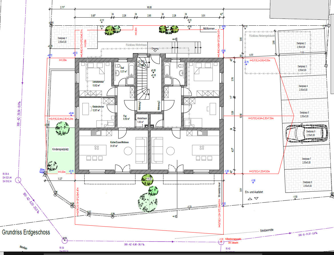

Good evening,
I am planning to build a multi-family house with 4 apartments about 30 kilometers (19 miles) west of Munich.
The house is designed to be 16 x 12.5 m (52.5 x 41 feet) and will include 4 apartments, each with 3 rooms and approximately 75 sqm (807 sq ft).
A basement is also planned, with space for the heating system, laundry rooms, and storage rooms for each apartment.
Unfortunately, the municipality requires 2 parking spaces per dwelling unit.
Plot size: 600 sqm (6,458 sq ft) available
House type: solid construction with 2 full floors and a basement
Heating: air heat pump
Ventilation system: yes
Photovoltaics: planned
What do you think of the floor plan? Suggestions for improvements and criticism are welcome.

As I said, I don’t personally place much importance on living space. A 50 sqm (540 sq ft) two-room apartment is sufficient for me.
I will also move to the upper floor… Regarding the parking spaces, Climbee is right. I checked the community’s parking regulations again.
From 25 sqm (270 sq ft) of living space, two parking spaces are required.
According to my acquaintance, the plot with a house size of 16 x 12.5 meters (52.5 x 41 feet) is fully utilized… no more is possible due to setback requirements, etc.

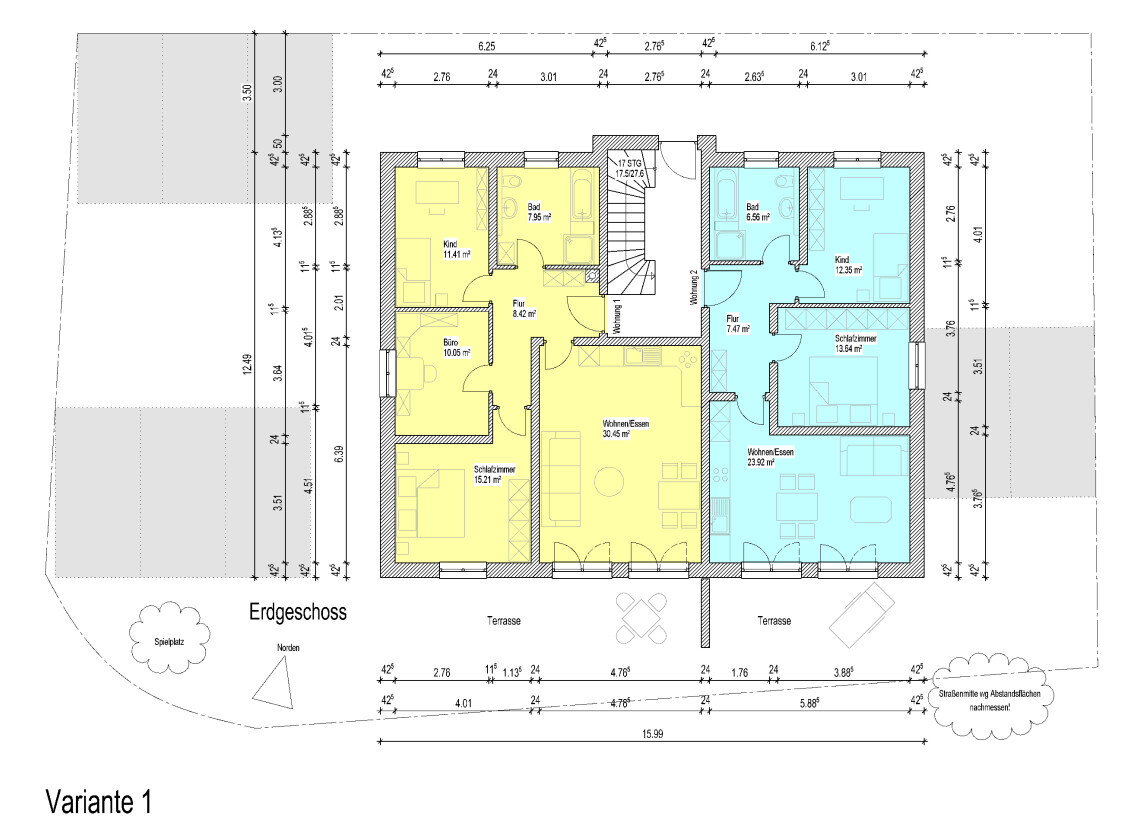

Here is a draft with two different apartment sizes per floor. This is, of course, also something to consider…
Sunshine38716 Nov 2022 16:50This is what I meant with my first floor plan: two apartments of different sizes, with you using the larger one. Personally, I find this the most practical solution, as it gives you more space. And one more thing regarding the previous post: the more unusual the house design, the more expensive it is, and the other three apartments are still investment units. That’s why I would stick to a practical floor plan like the one above. Also, skip the elevator or underground garages, as they are far too expensive and not proportional. An elevator for two apartments is not worthwhile. The first floor can also be accessed with a stair lift if necessary. For a new build in the Munich area, you don’t even need to consider such extras, since apartments can easily be rented out for €15 per m2 (approximately $14 per sq ft). If you like the floor plan above, I would keep the idea of two different apartment sizes but optimize the layout again. A living/dining area with only two windows isn’t pleasant. It’s better to have guests walk through the living room than to have hardly any natural light near the kitchen because of missing side windows.
Yes, the floor plan is not yet optimal. I would say the larger apartment of about 85 sqm (915 sq ft) will be a 3-room unit, and the smaller one of about 65 sqm (700 sq ft) will be a 2-room unit. As Sunshine already mentioned, the budget is not unlimited... If the land wasn’t already available, I wouldn’t even consider this. With the current construction costs, it’s simply not worthwhile. But if I can build the entire house for around 900,000 (nine hundred thousand), then each apartment costs me 225,000 (two hundred twenty-five thousand)... you can’t get anything like this in the area, not even second-hand and outdated... and then I have a new build, I am the owner of my land, and I don’t have to coordinate with other owners, etc.
