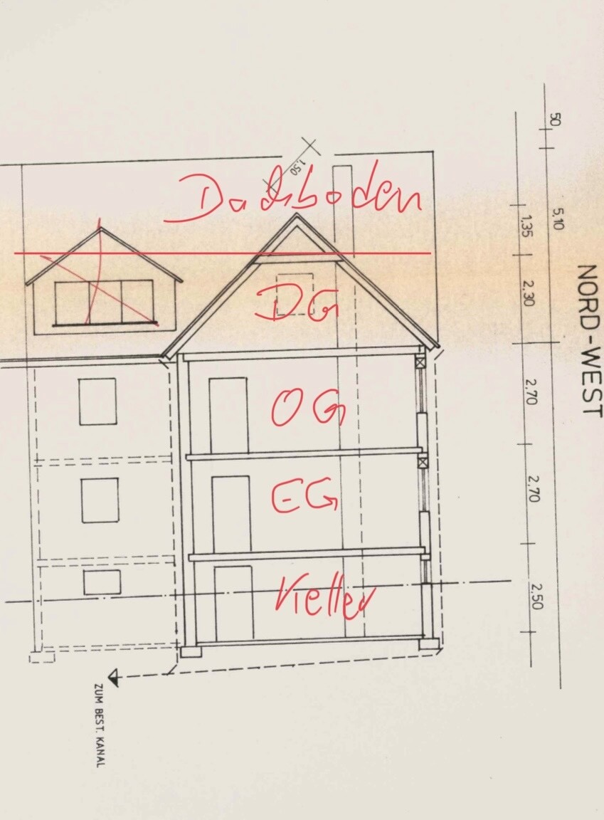

Since many of you have been asking about the new construction, I want to share the background of this idea and ask for your feedback.
I hope the reasoning is understandable.
More information about the house will also help with understanding.
- It is a semi-detached house with the mentioned extension
- My mother lives on the ground floor (with a right of residence)
- We live on the upper floor (myself, my wife, and three girls aged 5 months, 4 years, and 6 years)

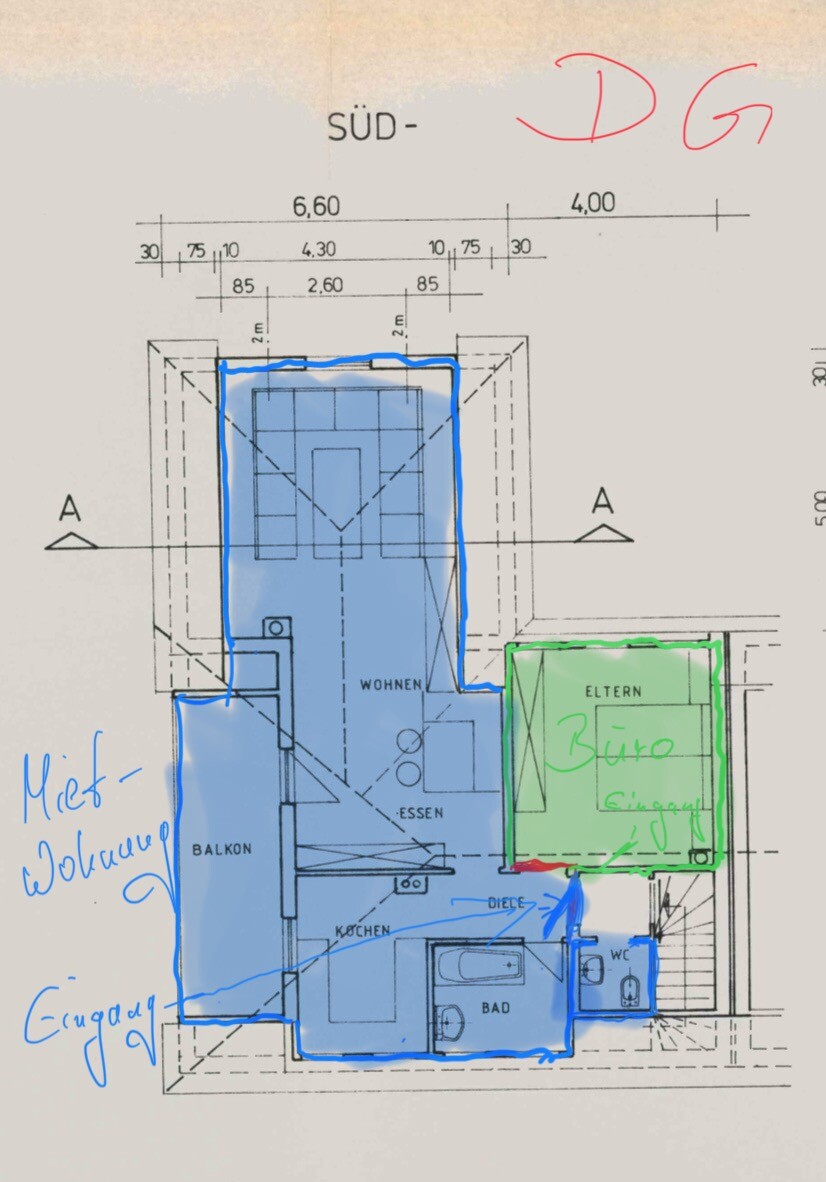

- The tenant lives in the top floor (attic). The room layout is poor and developed historically. At some point, the former master bedroom in the attic became a separate room outside of the rented apartment. The access from that room to the rental unit was closed and a new door was installed. So, when you arrive on the attic floor, there are three doors: on the left the bathroom, straight ahead the entrance to the rental unit, and on the right the access to the office.
Above that is the old pull-out door to the attic storage.
Of course, the layout is absolutely terrible. I didn’t build it.

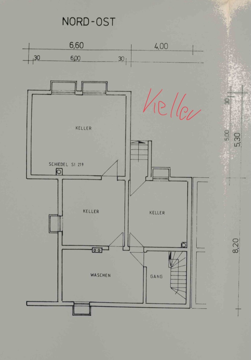

Here is the basement:
Here are the ground floor and upper floor:

Enlighten me, I can’t follow.Just to get some suggestions about size and necessity.
I’ve never built a house before. I didn’t realize a utility/technical room is required. Now it makes sense, but you have to figure that out first.
The same goes for the size of rooms, bathrooms, etc.

hanghaus2023 schrieb:
I would terminate the tenant due to personal use. That way, you will have enough space.Oh ... look, the good is so close! 🙂https://www.instagram.com/11antgmxde/
