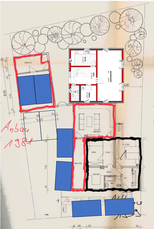

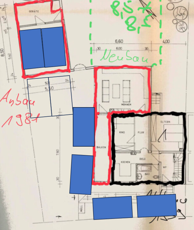

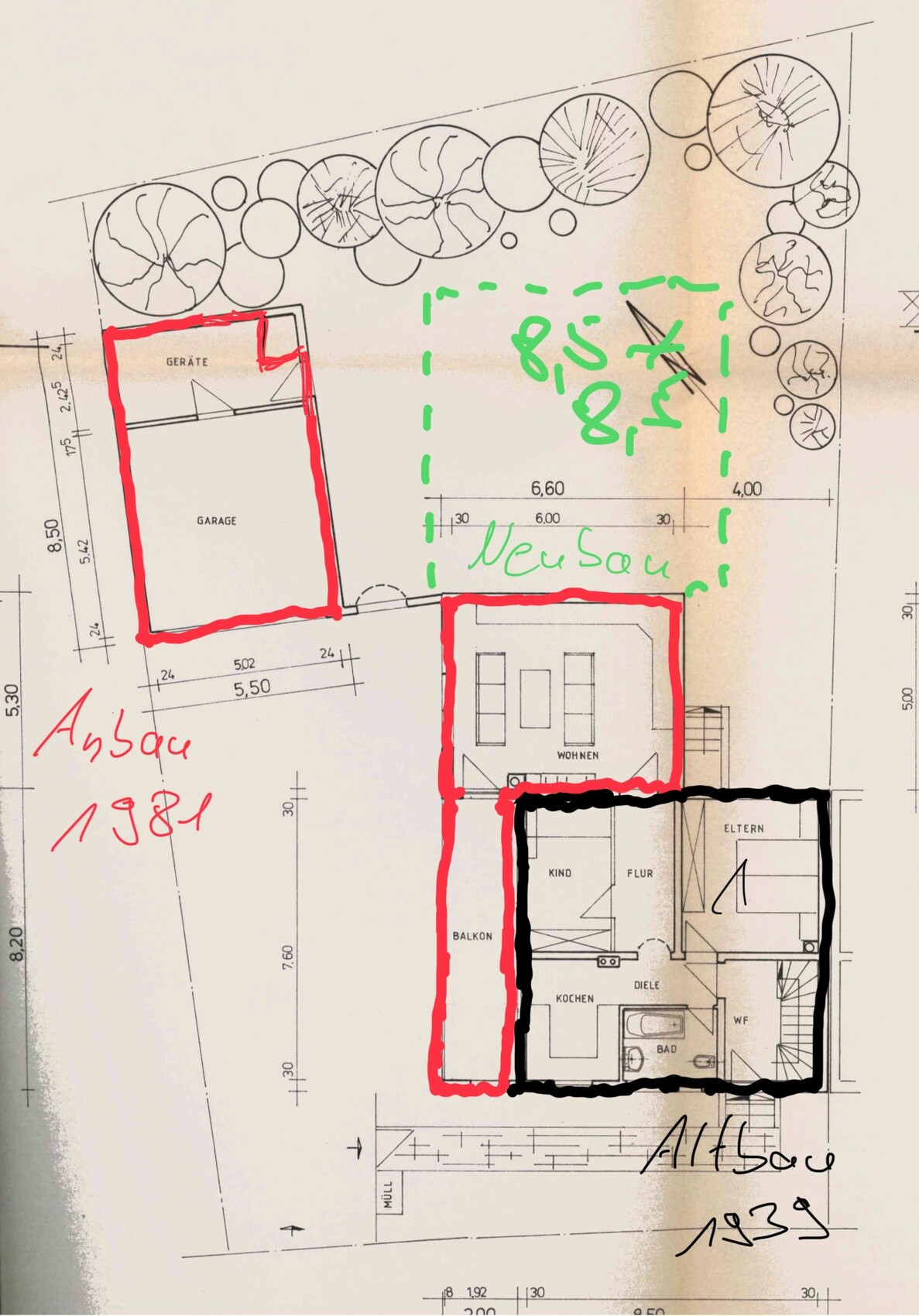

The plot size is 515 sqm (5545 sq ft). Attached is the plot plan with the old building and the colored plan for the new house.
The size results from the setback requirements.
If I keep the garage and build onto it, just like on the existing house, I have 8.5 x 8.5 m (28 x 28 ft). That’s not a lot, of course. But I have room for 2 full floors plus attic.
Alternatively, I could demolish the garage (which is of course a cost factor), which would give us 2.5 m (8 ft) more in width. So without the garage: 11 x 8.5 m (36 x 28 ft).
I have penciled this in on the plan without the garage.

Attached are the
- floor plan: green is the garden, black is the old building, and blue is the floor plan for the new house.
- view from the north of the old building, where the new house is planned
- view from the house towards the garden (north).

I understand that. You want to turn a single-family house into a semi-detached house. Or rather, it already is a semi-detached house. Regarding that, the first thing I would check (or have checked) is whether this is feasible on the property. A second dwelling unit, house number, possibly dividing the lot, floor area ratio still fitting, etc. That’s what the building authority is for. Home builder companies don’t usually check this initially; they first calculate a general house price, and only much later do they try to fix problems. I am already in contact with them. The floor area ratio is 0.6, with access and so on it is 0.8. A sketch from a developer with an extension measuring 8.5 x 8.5 meters (28 x 28 feet) would also be acceptable.
I actually thought you needed the rooms yourselves. So why the _rental_? The apartment has been rented out for years. It’s only now with the children that space is becoming tight.
Is that in the existing building or the new house? And how is everyday life supposed to work? Children sleep in the new building, you in the old one? Then constantly going back and forth between two entrances and houses? No one is going back and forth anywhere. It’s meant to be a separate house with its own entrance, which is only attached due to avoiding setback requirements.
Are you referring to the age of the basement? I estimate the house itself is younger, as previously mentioned, and your sketched overall building would reach a construction depth of 22 meters (72 feet)! Attached is a sketch of the property. Hopefully that clarifies things. Black shows the semi-detached house from 1939, red indicates the extensions from 1981 (balcony, “living room” and double garage).
Regarding the depth, you are right. But I can’t find anything contradicting that in the building plan, and the planning office has not raised any objections.
Are you planning to move the basement from the existing building? Demolish the old building? Or how do you want to use the existing basement? There’s a house above it! No moving. The new house will have a slab foundation next to the existing one. If I need to access anything in the basement, I use the old building; it’s basically my house. I’m the only one using the “living room basement.” There is a separate garden entrance for that (marked on the plan above, to the right of the extension).
There won’t be much left of it then. The little girls will still have the balcony. Unfortunately, that’s true. The 3 meters (10 feet) to the property boundary remain. A roof terrace over the balcony could be an option. I have to accept some compromises.

According to the planning office, it fits. I just shouldn’t build any more, otherwise it becomes critical. 8.5 x 8.5 meters (28 x 28 feet) should be okay.
The bigger problem seems to be the parking spaces. If I can somehow fit 6 in total on the existing site, it’s fine.
But that will probably be difficult. The statement from the office is worthless. Your building application should demonstrate compliance with the floor area ratio. Likewise, compliance with the required number of parking spaces.

The problem is obvious and lies in your planning, as you are mixing things up. While an extension is usually part of the existing dwelling, you want to build an independent house as an addition. Strictly speaking, for complete independence, the plot would need to be divided, possibly legally subdivided. Storage space and technical rooms belong to a house and connections are made to the house system. Of course, you can privately keep using the cellar of your old house, but economically this creates a dependency. Simply using technical installations from the old building and later demolishing it is not feasible. A new building must comply with the Renewable Energy Act regulations. A house should also be functional for possible later separation (sale, rental... whether old or new).
I assume the 8.5 x 8.5 meters (28 x 28 feet approx.) result from a calculation based on the floor area ratio or plot ratio?

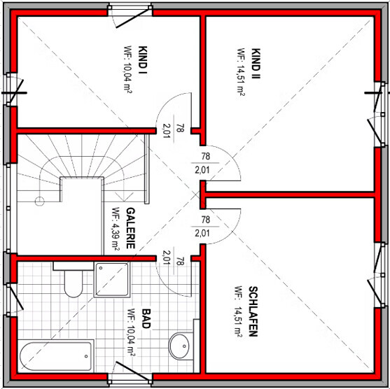

At 8.5 x 8.5 meters you get about 55-60 sqm (600-650 sqft) of living space per floor. Have you calculated how the room layout would look, assuming you are not planning a three-story tower? It’s not like you need 50 sqm (540 sqft) of open-plan living area. But 4 bedrooms of about 12 sqm (130 sqft) each, a small bathroom with tub and a small shower room together about 12 sqm (130 sqft), a utility/storage room of 8 sqm (85 sqft), a small hall closet of 2 sqm (20 sqft), an office of 8 sqm (85 sqft), and hallways including stairs of 20 sqm (215 sqft) leaves about 22 sqm (235 sqft) for kitchen, dining, and living areas.
Also, the plot would be severely compromised, so you would hardly have any garden left. Where is the added value in that?
Ben_des schrieb:
The area is 64 sqm (690 sqft). The toilet is in a separate small room. The attic above is even finished. The remodeling idea itself is good. If the costs were not so high that I could almost build a new house, and if it wasn’t such a “never-ending” construction site. That actually sounds ideal: the size is perfect for 3 children’s bedrooms. It is the most logical, environmentally friendly, and with subsidies the most economical and ultimately the most straightforward solution to finish the rooms upstairs for the children, even if it means moving temporarily into a holiday apartment for half a year and making everything perfect during that time.
I personally wouldn’t want to live in such a cramped space with just two people, and by definition, a garden is more than a 3-meter (10-foot) strip.
