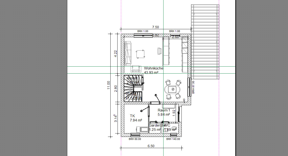

I’m not sure how to arrange the remaining part of the floor plan. The front door must be on the side.
Our requirements are:
  • a utility room as large as possible (since we don’t have a basement)
  • a WC with toilet and washbasin (small but practical)
  • a reasonably comfortable entrance area, meaning not too narrow when a few people visit... not too tight and not too dark.
  • a cloakroom niche that isn’t immediately visible when guests come over. Ours usually looks quite messy.
How would you use the remaining 20m² (215 sq ft)?
I appreciate any tips and ideas.

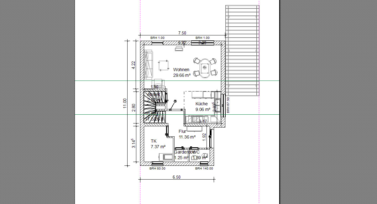

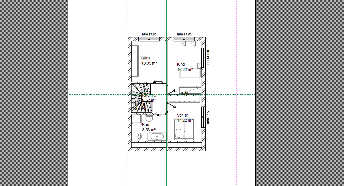

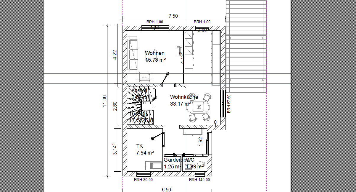

23 Jan 2015 22:51

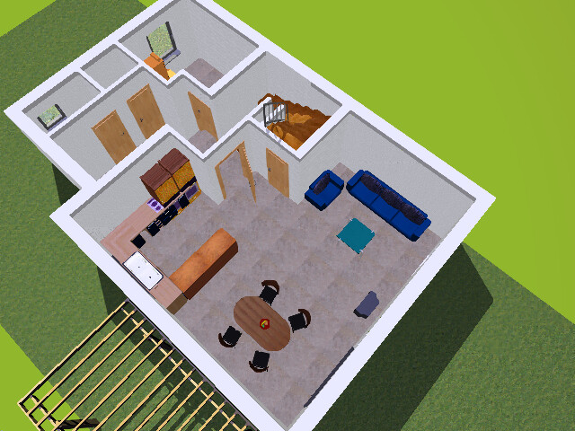

So, I have a few suggestions.
This semi-detached house is a challenge because a) the knee wall of one meter (3.3 feet) on the north side is not very impressive, and b) the staircase position, which in any semi-detached or terraced house has to be in an inconvenient spot to allow good access to the attic. I have planned a staircase from the upper floor to the attic because the attic offers 33 sqm (355 sq ft), which should not be underestimated.
Everything should also be bright; the bathroom and toilet locations are predetermined by the desired position of the bedroom, namely in the northeast with a problematic slope and a roof window.
In version 5, I tried to design a different staircase – this failed because space is tight here and there.
From around version 4, I think, I switched to a different type of window to gain more flexibility in the upper floor layout. I couldn’t come up with a sensible alternative design for the upper floor plan. I considered that while you could move a child or parents into the attic, finishing it financially isn’t feasible for now. So: you can extend upwards, but you don’t have to.
Furniture is only used as placeholders.
I neglected details (colors and floor coverings), and the windows could probably be revised. Most likely also the door swings, but I have included some important dimensions. Exterior walls are 34 cm (13 inches), interior walls 12 cm (5 inches) or 24 cm (9.5 inches)... anyway: I’m not an architect and had to reactivate my husband’s old PC since my program doesn’t run on a Mac. I emailed the BMPs from my computer so tichu has something to work with.
Basically, I think there is a favorite design. At least for me.

Floor plan of a house: living room 29.66 m² (319.7 sq ft), kitchen 9.06 m² (97.5 sq ft), hallway 11.36 m² (122.3 sq ft), staircase, balcony.

Floor plan: office 13.35 m² (143.7 sq ft); child’s room 16.82 m² (181.0 sq ft); bedroom 14.22 m² (153.0 sq ft); bathroom 8.53 m² (91.8 sq ft); stairwell.

Floor plan of a house: open-plan kitchen, dining area, room 1, cloakroom, staircase, terrace.
