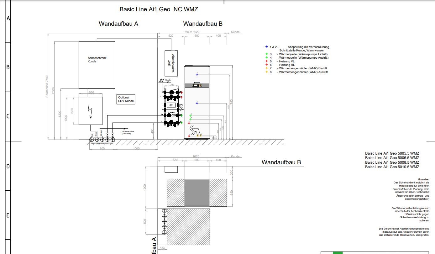

I was more thinking about explanations of the two images (on the left, what is the thick line in the middle of the picture, on the right, the labels of the items with the numbered red dots, etc.). And/or you could say (careful, no link!) where this information can be found...It wasn’t easy to find more information about the technology in the utility room. Today, I had to call the local utility company three times before a technician provided me with this drawing...

It wasn’t easy to find more information about the technology in the utility room. Today, I had to call the municipal utilities three times before a technician finally sent me this drawing... Unfortunately, it only makes us a little bit wiser; at least it’s now “clear” that the thick line probably indicates a corner...
Unfortunately, this only gives us a small piece of the puzzle, but at least it is now "clear" that the thick line probably indicates a corner...Unfortunately, I couldn’t get any more information over the phone today. I was told that for further questions, I should arrange an in-person consultation on site. I plan to visit the local utility company in the next few days; hopefully, we will get the answers we need then.I visited an architect today, who was recommended to me by acquaintances. He reviewed our plans and, like everyone else here, he was also bothered by the staircase in the secondary apartment—so that wasn’t a surprise. When I asked how this issue could be resolved, he had to think for a while. Unfortunately, he didn’t come up with any immediate solutions until I suggested that maybe the utility room could be moved to the garage (which is too small for two cars and perhaps oversized for one). He liked this idea. The parents’ bedroom should be extended further west (to where the utility room is currently located), and a shower bathroom should be placed along the east wall of the parents’ bedroom. This would increase the parents’ living area to about 26m² (280 sq ft), and the staircase could remain where it is. Furthermore, he suggested reversing the staircase in the main apartment so that one would enter the first floor from the living room. This would have the advantage of allowing the guest toilet to be placed under the stairs, thereby freeing up additional space for our kitchen. Are you able to follow me? Unfortunately, I don’t have any floor plan software, and I hope I have described it clearly enough. I still need to check with the utility providers whether the technical equipment can legally be installed in a separate room within the garage.
