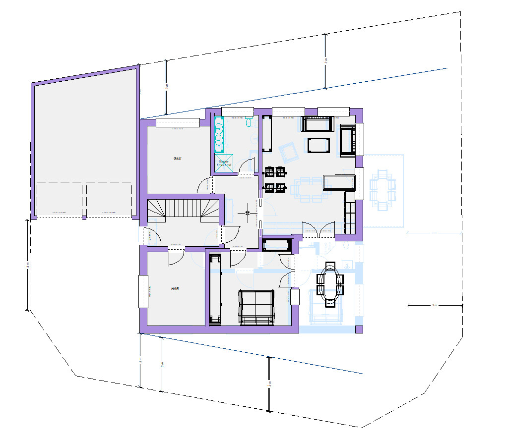

... I also interpret your design in post #100 as a stepped building form similar to the Tuscan stepped multi-level villas, so I don’t recognize it in the elevation shown in post #113.Ah, confusion. The question clearly referred to #104 with a direct link. But you’re probably right, the reference was to the experiment in #100. Yes, that is a stepped floor. In terms of design, I would also follow the Tuscan style simply because the building form suggests it. Visually, it is probably even more appealing than other designs.Of course, you could also experiment with a flat roof and maybe score some points with the building authorities by including a green roof. But I think the roof would already be expensive enough as it is. With this design, however, I do have some structural concerns about the kitchen located above the dining table. But I guess that option won’t even make it into the “option box.” Here’s a diagram to clarify what I mean:
or if I had changed my attitude a few months ago,I don’t mean months... but never mind. I’ll remind you when you start complaining about imaginary stone spreads again 😉Anyway, on the topic: when I lose motivation and don’t know what to do next, I start decorating my designs :-D
But that’s a good thing, because it shows me what I’ve forgotten. In this case, it was the guest toilet for the 5 people.

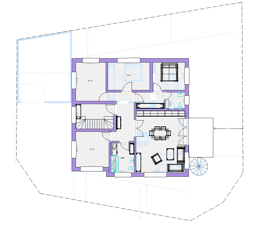

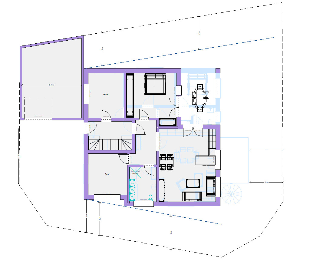

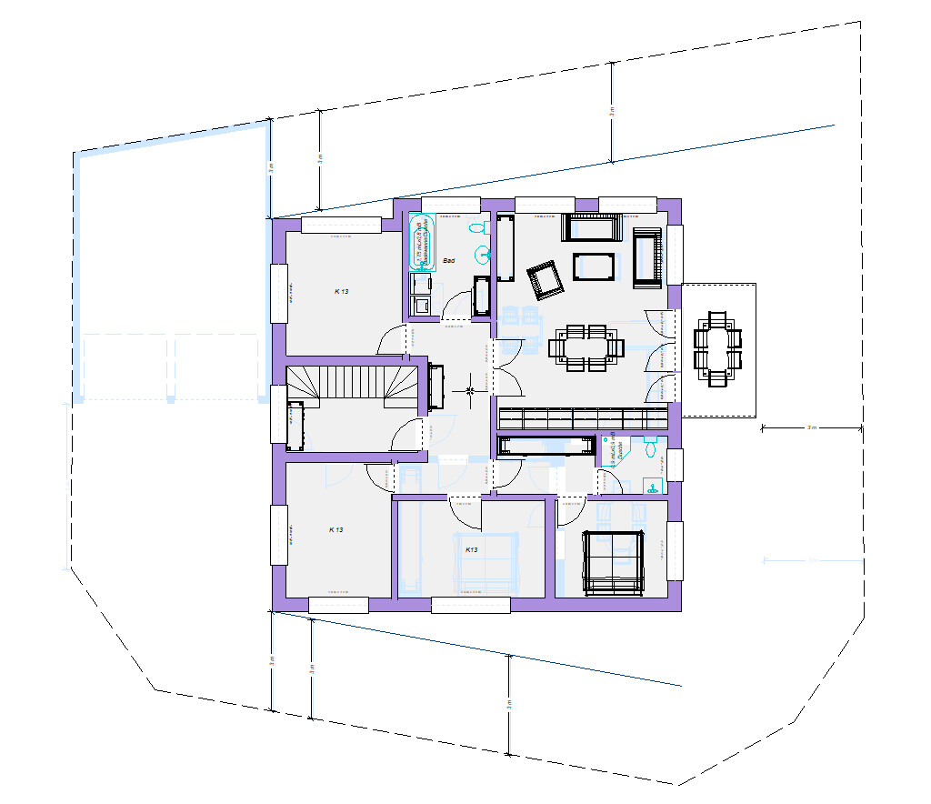

I’m sharing the floor plans and two views.
Of course, the parking situation is not ideal. You could do without the whole courtyard setup, position the HVAC system differently, and shift the house a bit due to the reduced width, as Katja did. But you already have those suggestions, so I’m just adding this idea here.

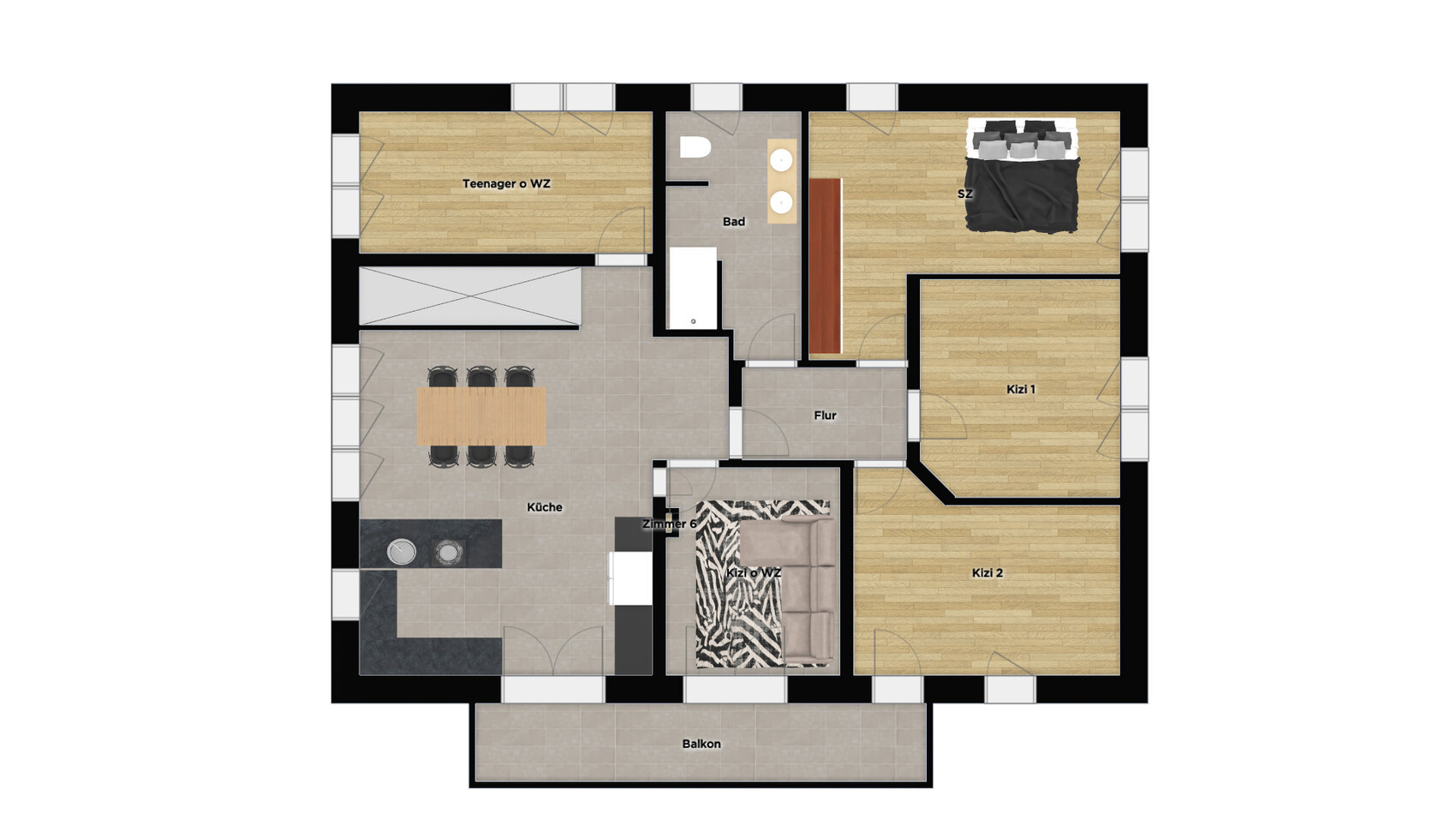

I’m sharing the floor plans and two elevations.I like it. I would swap the teenager room / living room with the kitchen and, of course, open it up completely. The room shape at the back seems suitable in my opinion. Or did you really want the kitchen facing south? Light from two sides is enough anyway. By opening it up, you also get light from the living room, and it’s pretty cool to come up these stairs. 😉 The windows would need some adjustment then. ypg schrieb:
So, on the topic, when I lose motivation or get stuck, I start decorating my designs :-DI feel the same—it’s kind of like setting up a dollhouse. 😀 ypg schrieb:
Of course, the parking situation is not ideal. You could skip the whole courtyard setup, place the septic tank crosswise, and shift the house a bit by making it narrower, just like Katja did. But you already have those suggestions, so I’m just adding this idea.I don’t quite understand—what happens to the staircase then?K a t j a schrieb:
Swap the teenager’s room / living room with the kitchen and, of course, open it up completely. What do you mean exactly? Then the kitchen wouldn’t have an exit, or do you mean moving the child back to the sofa, kitchen at the top of the plan, and living room at the bottom?
K a t j a schrieb:
Or did you definitely want the kitchen facing south? I wanted access to the terrace/balcony.

I don’t quite understand—what happens to the staircase then? It would be positioned sideways then 😉

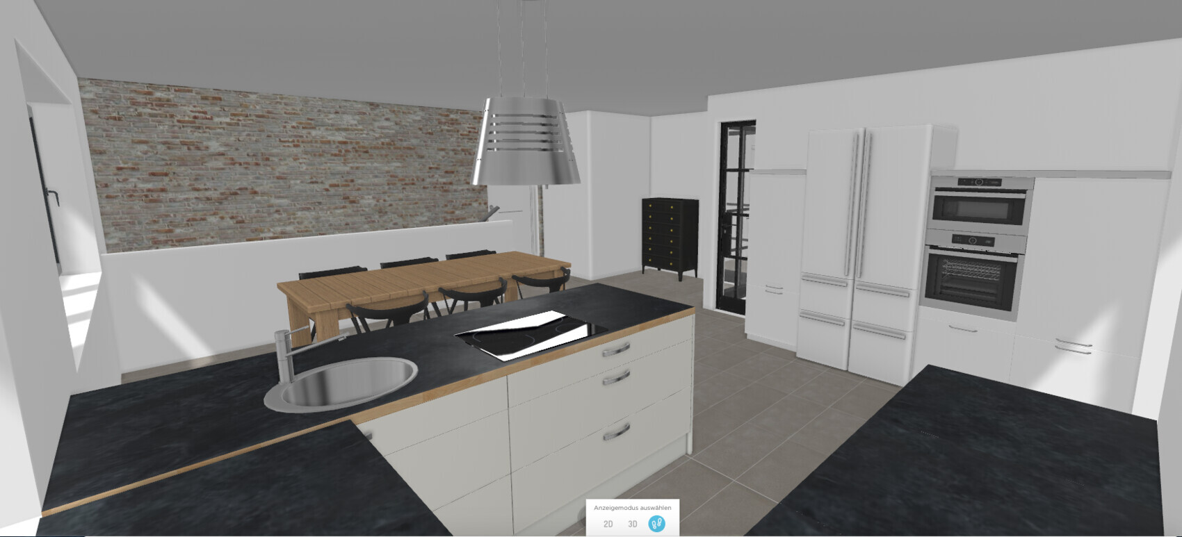

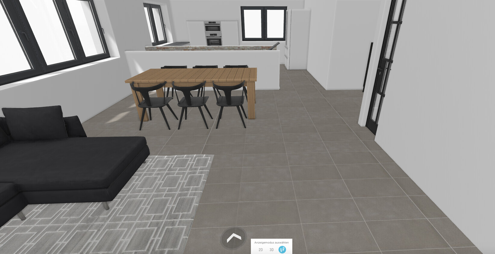

Here is a view of the upper room and the courtyard (oh, I always fall totally in love 8))
Do you mean it like this, @K a t j a? Yes, exactly. I also really liked your kitchen, but I find the sense of space with the opening and the staircase even nicer.
Maybe the north-facing window could be incorporated as a narrow strip in the kitchen between the countertop and the wall cabinets. There are also great ideas involving kitchen herbs and so on.
