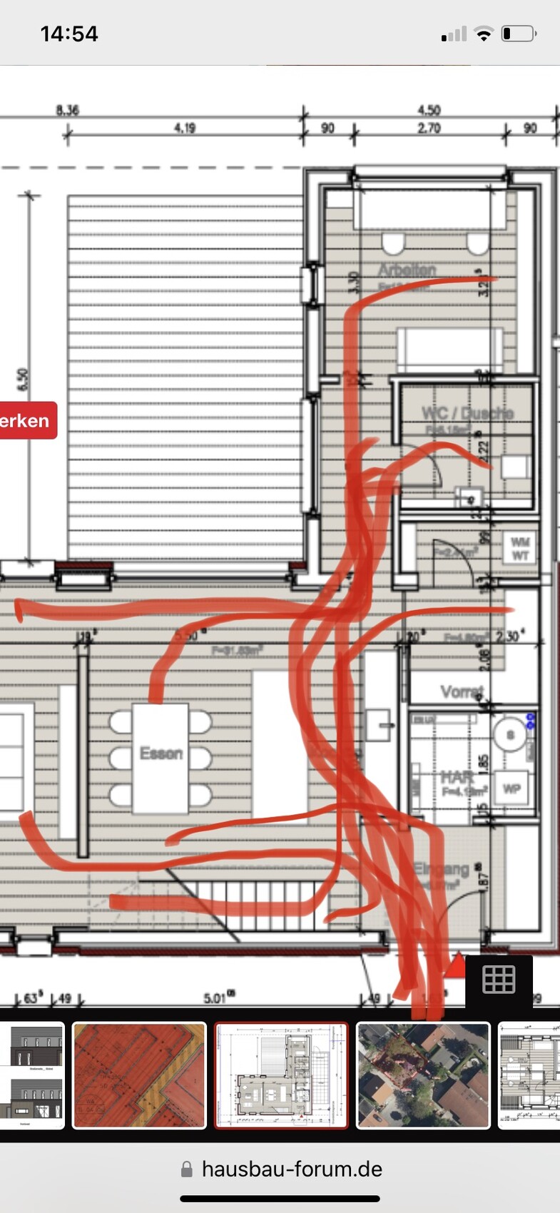

Myrna_Loy8 Jul 2022 13:38Okay, everything seems fine then. I don’t understand why a floor plan is being put up for discussion.
And yes, especially if the kitchen is supposed to be THE CENTER OF LIFE, I would definitely not make it the main traffic area. If I spend a longer time somewhere or with several people, I don’t want others constantly walking through. With two teenagers and their friends, this would definitely be a problem.
You’re turning the central place into the busiest and least comfortable area.

North-facing windows – we have several – and you quickly notice during the winter months that it’s darker and you need more artificial lighting. But in hot weather, they are great. No sun glaring in your eyes or heating up the rooms. We’ll see :-D. Basically, it’s meant to be used (although we will probably opt for a carport). And yes, it is narrow. That’s one of the compromises we consciously accept due to the very small plot.
Which changes from YPG? I didn’t find the redesign of the upper floor much better. I want to avoid a bedroom on the south side. I do agree with the door orientation.

And yes, especially if the kitchen is THE CENTER OF LIFE! then I definitely wouldn’t make it a main traffic area. If I spend a longer time somewhere with several people, I don’t want people constantly walking through. Especially with two teenagers and their friends, that would not be fun.
You’re turning the central space into the busiest, least relaxing area. Hey, sorry if something came across the wrong way. I’m actually trying to respond constructively to your concerns. I want to explain my position and clarify the current situation as well as my reasons. That’s why I’m addressing most of the arguments raised. I hope this doesn’t seem stubborn, but of course you can’t always be easily convinced or open to everything. Written discussions always leave room for misinterpretation. I think the discussion so far has been quite successful. I’ve already noted several points that I still need to resolve in the design. Thanks for that!
Regarding the kitchen, I guess I’m just different from most people. For cozy, quiet relaxation there’s the separate living room. For communication and so on, the lively kitchen. I’m happy when I get to see the other family members there. Admittedly, I don’t yet have experience with teenagers, so maybe I’m misjudging that, but at the moment traffic through the area is fairly limited.
Myrna_Loy8 Jul 2022 14:58The kitchen area isn’t very large. With the current layout, the furnishing isn’t really feasible. A 60 cm (24 inch) counter, plus a 1.30 m (51 inch) walkway, plus an island of 1 m (39 inch) already adds up to 3 m (10 feet), and then the dining table at 2.50 m (8 feet 2 inches)? That’s actually quite tight. Also, consider typical movement patterns – your work area is the high traffic zone of the house.
I would suggest swapping the dining table and the kitchen island instead.
Myrna_Loy8 Jul 2022 15:11The ground floor layout simply looks like it’s designed for DINKS rather than a family with children. I can easily imagine it as a set for a crime drama in an affluent suburb of Munich. 😉
