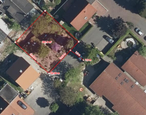

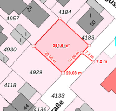

Plot size: 381 m2 (4100 sq ft)
Slope: No
Site occupancy ratio: 0.4
Floor area ratio: 0.6

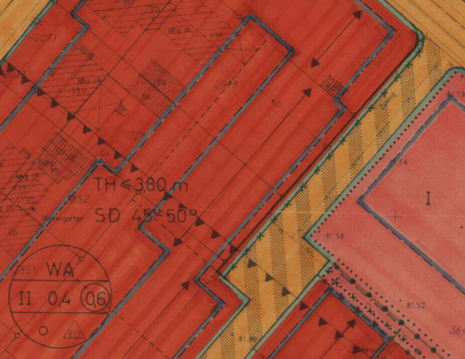

Building envelope, building line and boundary: The current design fully uses the building envelope (except for the terrace area) at approx. 13 x 14 m (43 x 46 ft)
Setback: max. 9 m (30 ft) per side (carport/tool shed fills this), 15 m (49 ft) total
Number of parking spaces: 1
Number of stories: 2 (according to development plan)
Roof type: Gable roof with 45-50° pitch (design currently planned at 50°)
Architectural style: ?? It would be nice if it looks at least architecturally appealing
Orientation: Terrace faces west
Maximum heights / limits: Max eaves height 3.8 m (12 ft 6 in)
Other requirements: - Red/brown brick is mandatory on the main building; 2 m (6.5 ft) minimum distance of roof structures from gable edge required

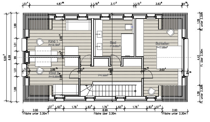

- Unequal size children’s bedrooms (not ideal but acceptable), and one is borderline small.
- Master bedroom could be slightly smaller. Overall, we haven’t found a better arrangement.

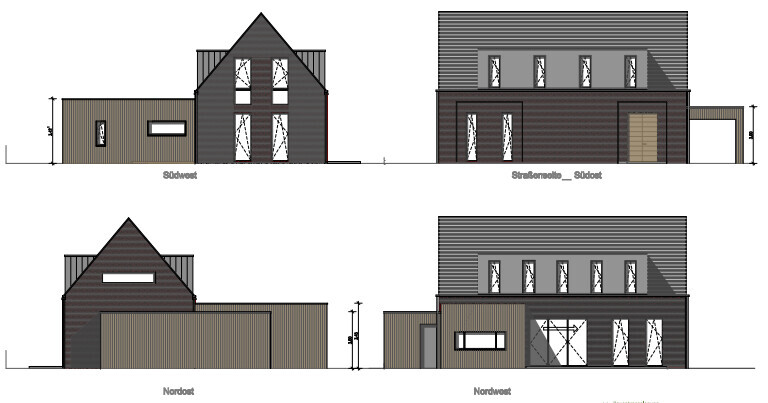

- I don’t like the street-facing elevation yet. It needs lighting near the entrance and the large blank area bothers me.

I quite like the changes you have already planned. I think the southeast-facing windows in the dining area and the skylight in the guest bathroom are important. If necessary, I would even consider making the former fixed glazing behind the staircase—no compromises there. But maybe your architect has more elegant solutions.

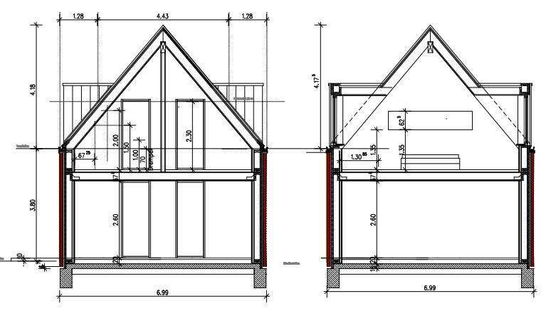

The main issue for me is the too small children’s bedroom and the entire upper floor. In comparison, the office on the ground floor seems relatively oversized. Is that necessary? One might wonder whether it would make sense to move the bedroom downstairs from the start and find a different layout upstairs.

To me, this already looks like an architect’s design. Someone hoping to at least get featured in a design magazine. 😉 As evelinoz mentioned, it strongly resembles atrium bungalows and also reminds me of some Case Study House adaptations. A floor plan more suitable for about 50 sqm (540 sq ft) larger spaces, to create built-in wardrobes and other fixtures for the desired look. Okay, the bathroom on the ground floor is in an unusual spot and the house has an extension. Otherwise, I don’t find the design particularly special or spectacular. It’s a gable roof trying to maximize space with bay windows. Can you explain what exactly makes it so unusual?

The main issue for me is the children’s bedroom being too small, or rather the size of the entire upper floor. On the other hand, I find the office on the ground floor comparatively oversized. Is that really necessary? You might consider moving the bedroom downstairs right from the start and finding a different layout upstairs. Yes, you’re right. Another window is needed on the southeast side plus better lighting for the entrance area. It’s not ideal, of course, since the street runs just 3m (10 feet) away. Maybe a strip window at ceiling height?
Having the bedroom downstairs could be a perspective to consider. Right now, with a small child, it’s not practical. That’s why the office needs to be a decent size – so it can potentially be repurposed later. I don’t think the children’s room is too small. It’s about 11.5 m² (124 sq ft) of floor space and, thanks to the steep roof, it can be used early on. One more square meter (about 11 sq ft) would be enough for me. I didn’t have more space when I was younger either. It doesn’t bother us if junior plays in the living room. He’s quite good at tidying up (for a child ;-) ).
