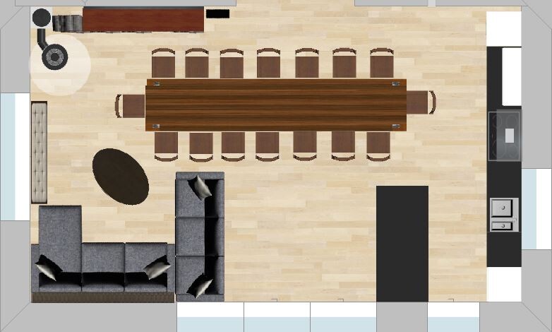

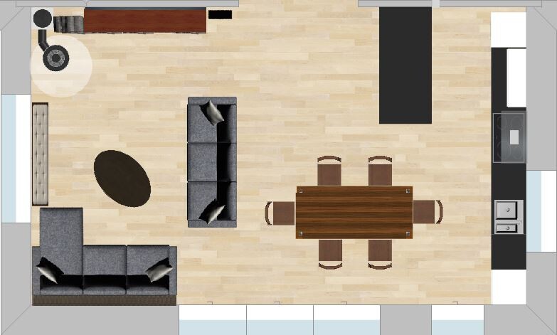

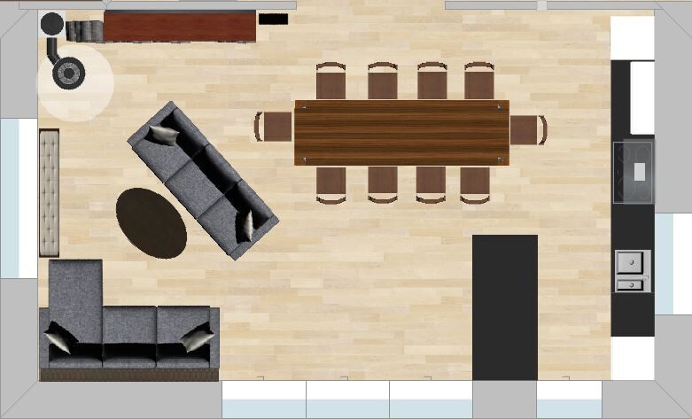

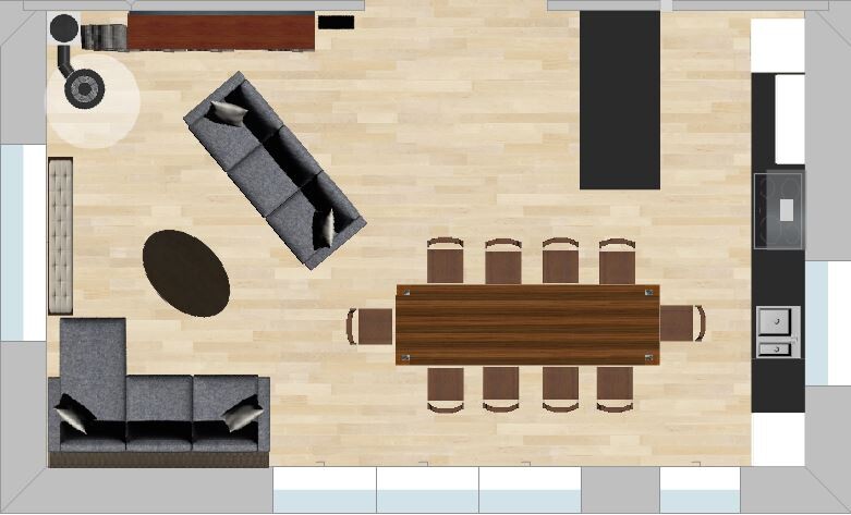

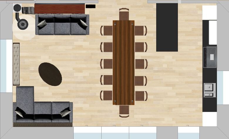

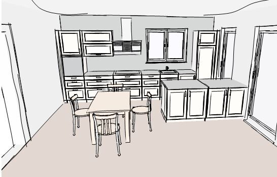

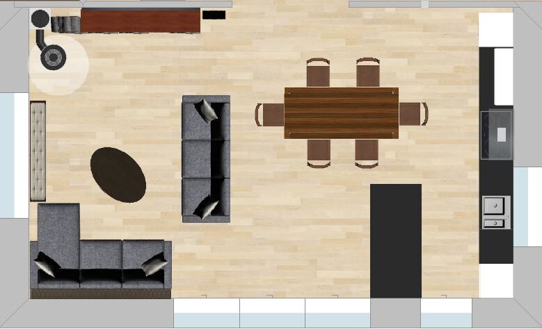

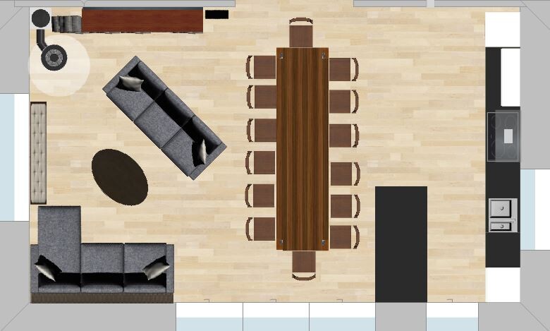

After extensive discussions, we have ultimately decided against an L-shaped kitchen layout. This now leaves us with two different options for the kitchen island. What are your thoughts on these two variants? What advantages and disadvantages do you see for each?
Details:
- No door between the hallway and the room, only a 2m (6.5 ft) wide passage with a lintel
- Dining table size: small variant 2m (6.5 ft), medium variant 3m (10 ft), long variant 4.5-5m (15-16.5 ft)
- Distance between the kitchen run and the island: 0.95m (3 ft)
- The window on the right side of the plan should not be moved; patio doors could be shifted if absolutely necessary
- Kitchen run layout from top to bottom: oven, stove, dishwasher, sink, freezer, refrigerator
Why choose a kitchen island at all?
1. More countertop workspace
2. Additional storage is needed
3. At least a partial separation between the kitchen and the rest of the room
Variant 1 – island at the top of the plan:
- The dining table is closer to the windows, which might be more pleasant
- The main workspace is far from the refrigerator, sink, and trash bin, so it might not be used as intended
- The first thing you see from the hallway is the kitchen island (which doesn’t feel very welcoming to me)
- Good amount of open space when entering the room
- Table and chairs partially block the patio doors, making opening and passing through inconvenient
Variant 3 – island at the bottom of the plan:
- The dining table seems more accessible, also due to the permanent opening to the hallway
- The dining table is about 2.5m (8 ft) away from the patio doors
- Opportunity to set up a very long table for celebrations

@Bamue89 .. also a practical idea, together with the L-shape I sketched above, also practical. The drawback with the L is that you can't extend the table endlessly, nor rotate it because of the wall. Without the L and with a changed window position (because the workflow is simply better there), I would still find the kitchen too small.

I don’t quite understand your approach. You planned the living room with these dimensions, so why are you only now arranging the dining table and kitchen furniture? If the living room were a bit wider and correspondingly narrower, it would be much easier to place the kitchen, dining, and living areas in a row. With just over 8 meters (26 feet), that’s not possible. You need at least 4 meters (13 feet) for the living area and about the same for the dining area. So you really have no choice but to place the dining table almost directly in front of the kitchen unit or reconsider the idea of the low wall to possibly create a more separated living area. Why does the drain area of the sink have to be on the left? That shouldn’t make a difference, right?
