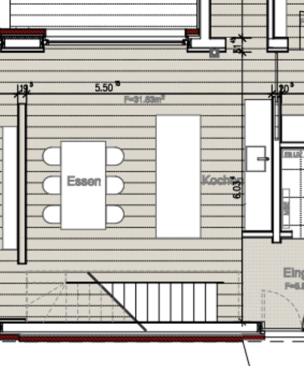

I have been quietly following along for a while. Since our project is starting to take shape, I wanted to tap into the collective wisdom here and ask for feedback on our early design. Many details are not finalized yet, but the basic structure is becoming clear. Thanks!

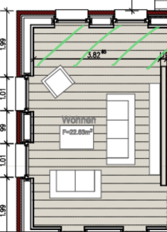

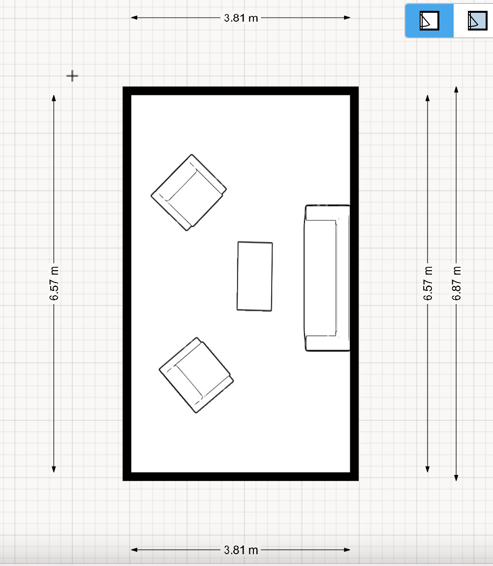

Myrna_Loy12 Jul 2022 20:17By the way – the furniture shown in the living room plan is not to scale. I have now marked standard furniture dimensions, and the 3.82 meters (12.5 feet) quickly fill up without leaving space for shelves or walkways. The sofa is 80 cm (31.5 inches) deep, the coffee table 60 cm (24 inches) deep, and the armchairs are 80 cm (31.5 inches) deep. Plus you need the usual clearance space for movement.

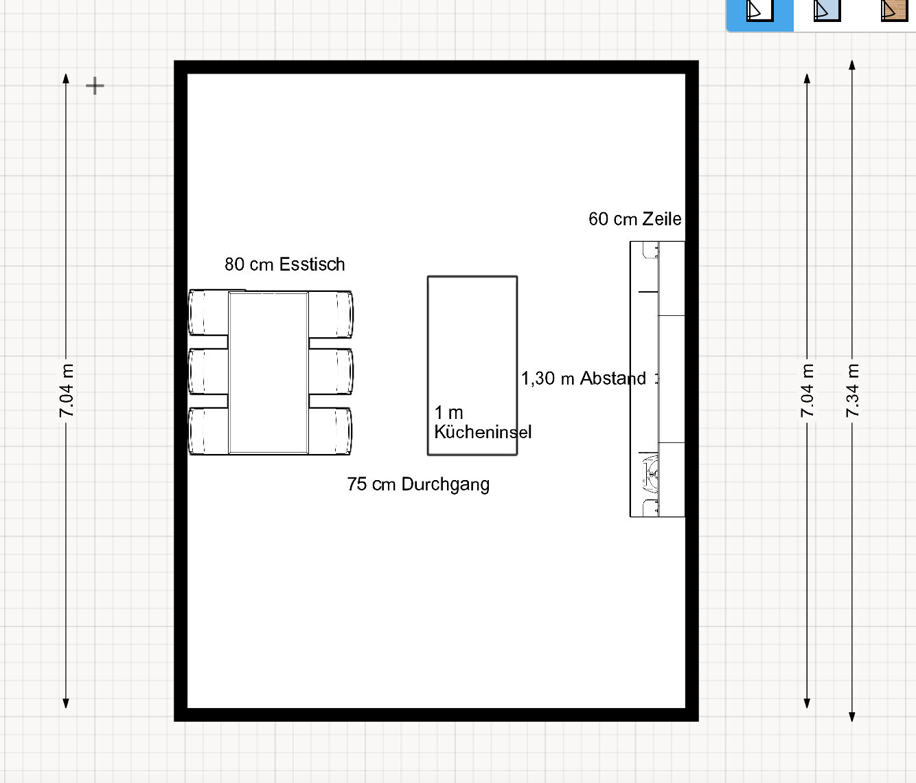

Myrna_Loy12 Jul 2022 20:47Myrna_Loy schrieb:
2.50 m (8 ft 2 in) is not enough space for a dining table.
And I wonder why people bother building a house where there is room for improvement, if the answer is always that “we have that too, and it doesn’t bother us.”
Our open-plan kitchen and living area is almost a meter longer than your layout and it still feels cramped. You constantly bump into furniture. If I were building, I wouldn’t design a kitchen with an island and dining area less than 6.50 m (21 ft 4 in) long. Come on, that’s not what he wants to hear. 😉
