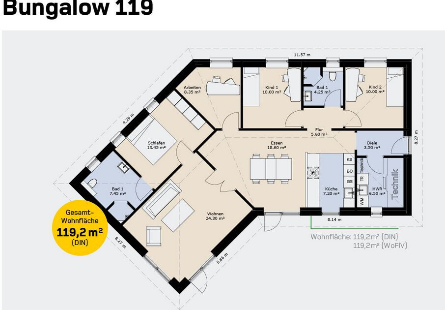

I searched through some of my saved floor plans...
Hauscompagnie ... everything a bit wider/deeper ... Child 1 and 2 as guest and office rooms, workspace combined with the sleeping/bathroom/walk-in closet area, technical room divided a bit more, possibly a smaller living area.

kbt09 schrieb:
HauscompagnieCool, desks matching the main structure of the house 😀 I actually like the sloped ceilings in the rooms – they have a certain charm!
dieselfalk23 Apr 2021 11:32@ kbt09
Thanks for the floor plans.
Both look very neat.
For the HC 119, there shouldn’t be a door between the living room and the kitchen—just a large open connection—and since there is one room “too many,” I would change the room layout.
I find the cramped small hallway at the entrance a bit awkward.
The Gussek house M. doesn’t have a pantry, and having to exit the room and go through two doors is inconvenient. So the kitchen area would need to be planned differently. It’s also bigger, but you don’t really gain much from that.
The guest wing is nicely separated; the study could be the room next to the master bathroom.
Otherwise, many good ideas.

HC119 – The hallway could be redesigned together with the two children’s areas and the bathroom. The separation between the dining and living areas is definitely flexible, although it does have its advantages. One person can read or watch TV in the living area while another chats in the kitchen with a guest. A wide sliding door between the spaces allows them to be combined or separated as needed.
In general, both floor plans were intended only as concept sketches. After all, the property needs to be secured first 😉.
