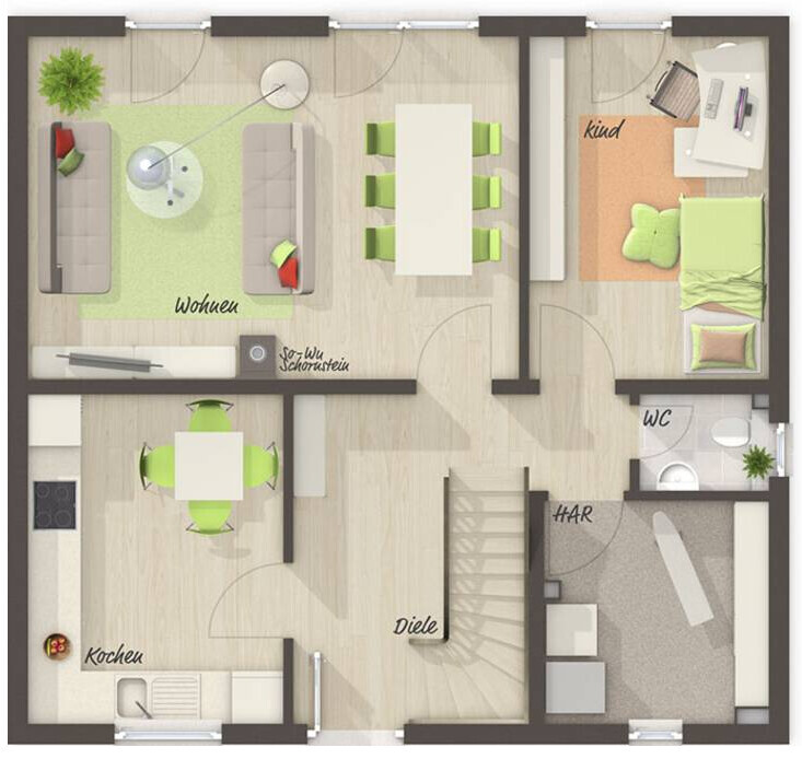

Has anyone ever suggested a version of the Flair 152 from Town & Country? The floor plan is quite similar and comes with 3 or 4 rooms plus a bathroom upstairs... you don’t always have to reinvent the wheel.

Considered the Flair 152 from Town & Country? The floor plan is quite similar and is available upstairs with 3 or 4 rooms plus a bathroom... you don’t always need to reinvent the wheel.
Thank you for the suggestion, it is indeed similar to the Solution 151.

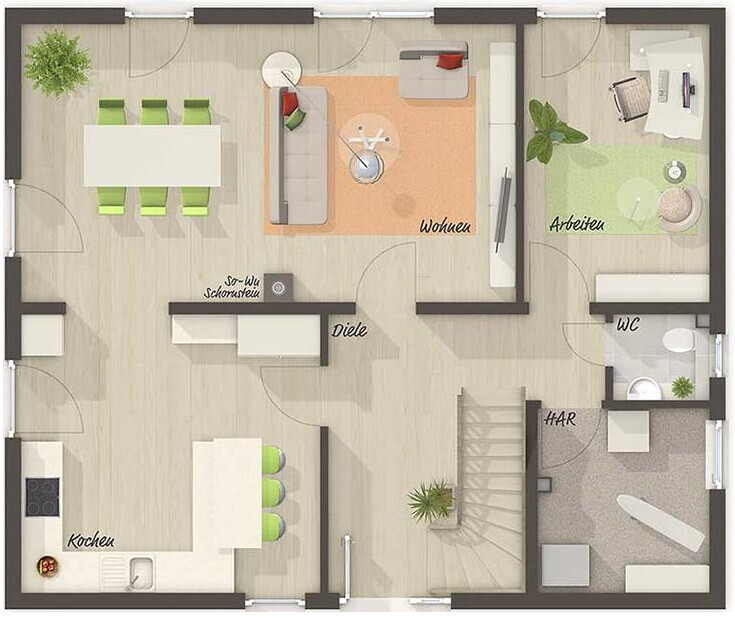

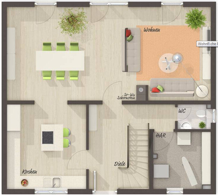

Whether Flair or Danwood: I see the same issue with both, that when squeezed into a 10.00 m width (33 ft), they no longer function well.
That’s exactly what I don’t quite understand.
You can simply reduce the already generous kitchen in the Flair 152 by 50 centimeters (20 inches) on the left. Conversely, the living room can get 25 centimeters (10 inches) deeper.
Or you take the Flair 125, which is 9.75 meters (32 ft) wide.
Or the Flair 110 at 9.13 meters (30 ft).
If you place all three Flairs side by side, it seems the right half (utility room, toilet, study) is always similar in size. So, only the left half becomes more spacious depending on the house type.

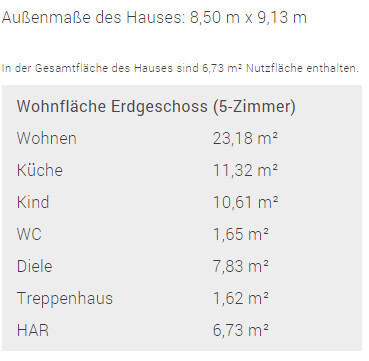

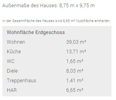

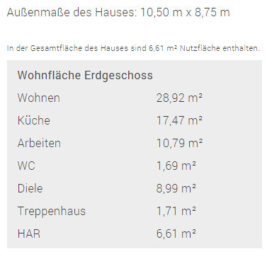

Flair 152:
Open layout with kitchen, dining area, living room, study, hallway, toilet, utility room, and staircase.
Ground floor plan of a house with living room, kitchen, study, hallway, toilet, and stairwell
Flair 125 (without study):
Floor plan of a modern apartment with kitchen, dining area, living room, hallway, toilet, and utility room.
Overview of ground floor living areas with living room, kitchen, toilet, hallway, stairwell, and utility room
Flair 110:
Floor plan of an apartment with living room, kitchen, dining area, corridor, child’s room, toilet, and hallway
2D ground floor plan of a house with living room, kitchen, child’s room, and stairwell
