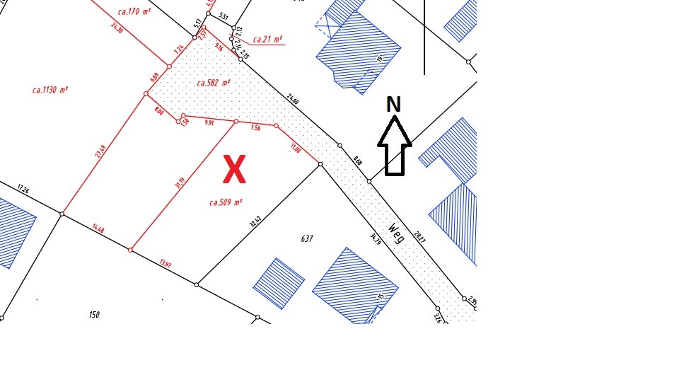

SubwklooferWe would like to build a nice, small, somewhat traditional single-family home on the mentioned plot of land.
Due to the dimensions, the width will probably be limited to about 8.50 m (28 feet).
Since I do not have a measurement program, I can only make rough estimates.
The original idea was to build without a basement and still have a guest bathroom with a toilet and a small guest/workroom of around 10 sqm (108 sq ft) on the ground floor.
However, because of the limited width, we were advised against this, and now we are considering whether adding a basement would make more sense to avoid squeezing everything in.
The upper floor is planned to have the usual three bedrooms (possibly with a small dressing room) and a bathroom including a bathtub.
A real challenge at the moment is the knee wall height of 0.5 m (20 inches).
After inquiries at the building authority, it may be possible to submit a preliminary request regarding a two-story construction.
Maybe you have some good advice or suggestions about what makes the most sense regarding cost-effectiveness.
We are completely open regarding heating technology and ventilation systems.
Underfloor heating is fixed.
Unfortunately, we have not yet found the perfect floor plan. (Preferably, the living rooms would face south, and the kitchen and guest WC would be on the north side.)
Is our plan feasible with this plot? What should be especially considered when working with an architect or builder?

Roof type: GD pitched roofs 30-50°That basically leaves almost everything open for you, doesn’t it?!Well, everything is only partially fixed; I have almost exclusively seen knee walls (dormer side walls) of 100–150 cm (39–59 inches) in the technical catalogs or model homes. That really makes you think about what can actually fit in when half the room has a sloped ceiling.
Using a ruler was a good starting point, and I also came up with 9–8.5 m (30–28 feet). As a pessimist, I assumed 8.5 m (28 feet). Since the plot narrows as well, the usable length decreases even more.
Even an architect started to groan after reviewing the plans. Quote: "This won’t be larger than 120 sqm (1,292 sq ft), you’ll need a basement for the utility room."

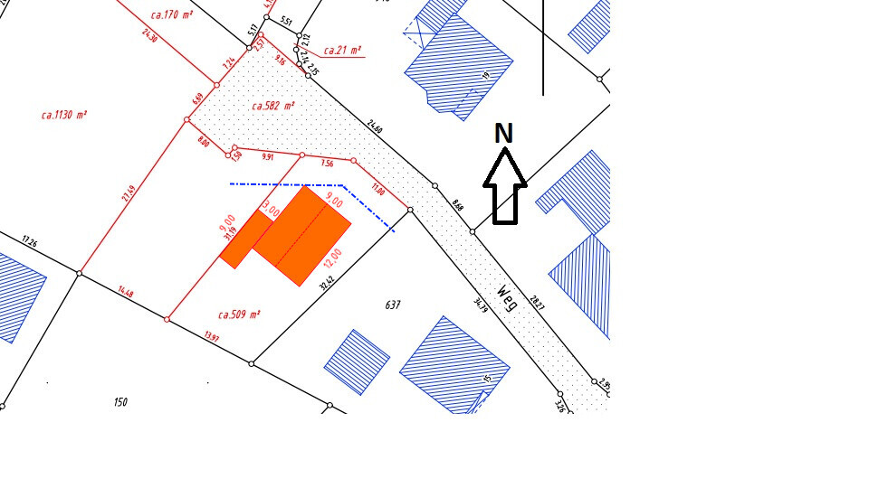

Is our project feasible on this plot? Yes. The plot is quite good. It faces southwest and is large enough. Whether it is suitable for a modular or catalogue house due to the unfavorable building limits and roof design restrictions, I am not sure. The low knee wall (called “Drempel” here) can be compensated with dormers. With the note about the preliminary building inquiry, I see a possibility to disregard the full-storey rule when sizing the dormers. Here is one option:
With custom planning, aligning the building along the southeast border and cutting off the north corner due to the angled building limit could bring the building closer to the street and gain garden space. Ultimately, this will probably be a question of cost.
