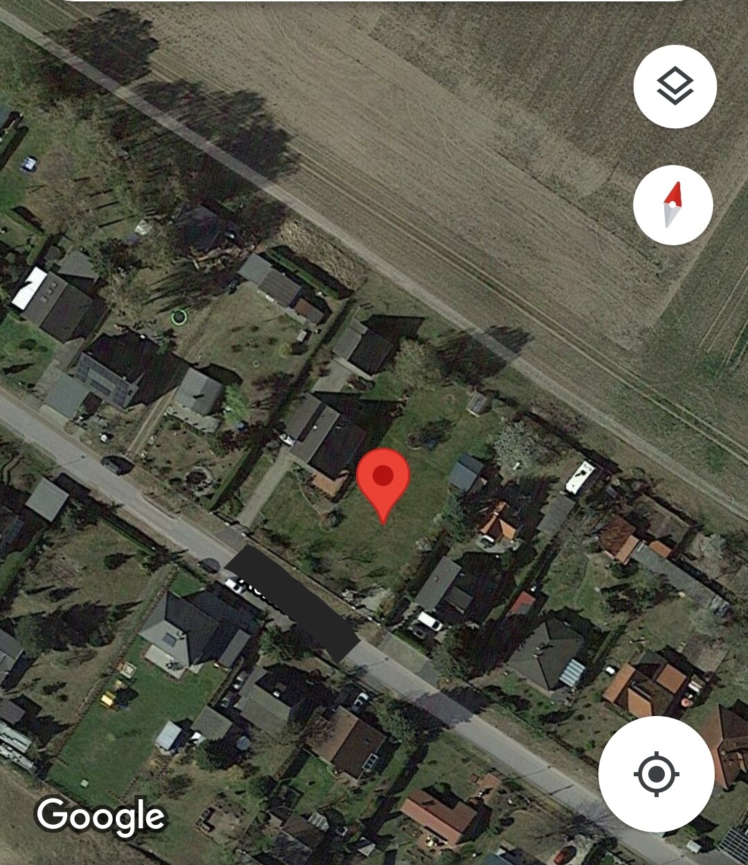

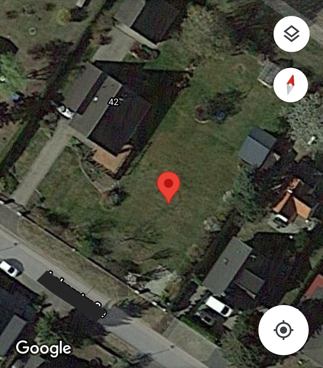

Would you actually rotate the house counterclockwise so that the staircase is at the top of the plan? Please provide more details on the neighboring buildings, for example the height of the house to the west (which is perceived as a disturbance).

hanghaus20002 Jul 2021 22:13You have put yourself at a disadvantage due to a lack of knowledge. Now, the intention is to start with the basics to avoid making the same mistake. Then you respond with "I only want my floor plan to be evaluated." In that case, I’m out. In my opinion, everyone should first be aware of all the conditions. This includes the preliminary site analysis. I like to begin with the location of the house on the plot. Where will the garage be placed? What setback regulations apply to parking spaces? And so on. Thank you for your patience.
Normally, a plan is provided by the person asking the question, so you don’t have to spend a lot of time trying to figure out how the house is actually positioned.
What do you think will happen if there is a local ordinance or regulation you haven’t read, and then you get the next rejection? Everyone does things their own way.
