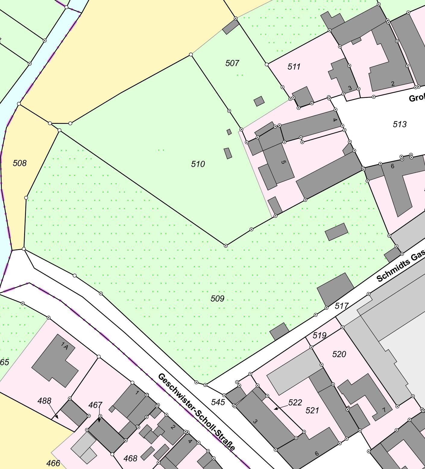

Some key data about the plot: the south border (street side) is about 20 m (66 ft), the access road to the property must be here. The middle of the plot is about 21 m (69 ft) wide, and the northern border about 23 m (75 ft), surveying was done last week. The plot is bordered on the south and east by a wall; the other two boundaries will still be built. There is an opening in the wall on the east side leading to a lane, so we would like to create a short access path to the property and house there.

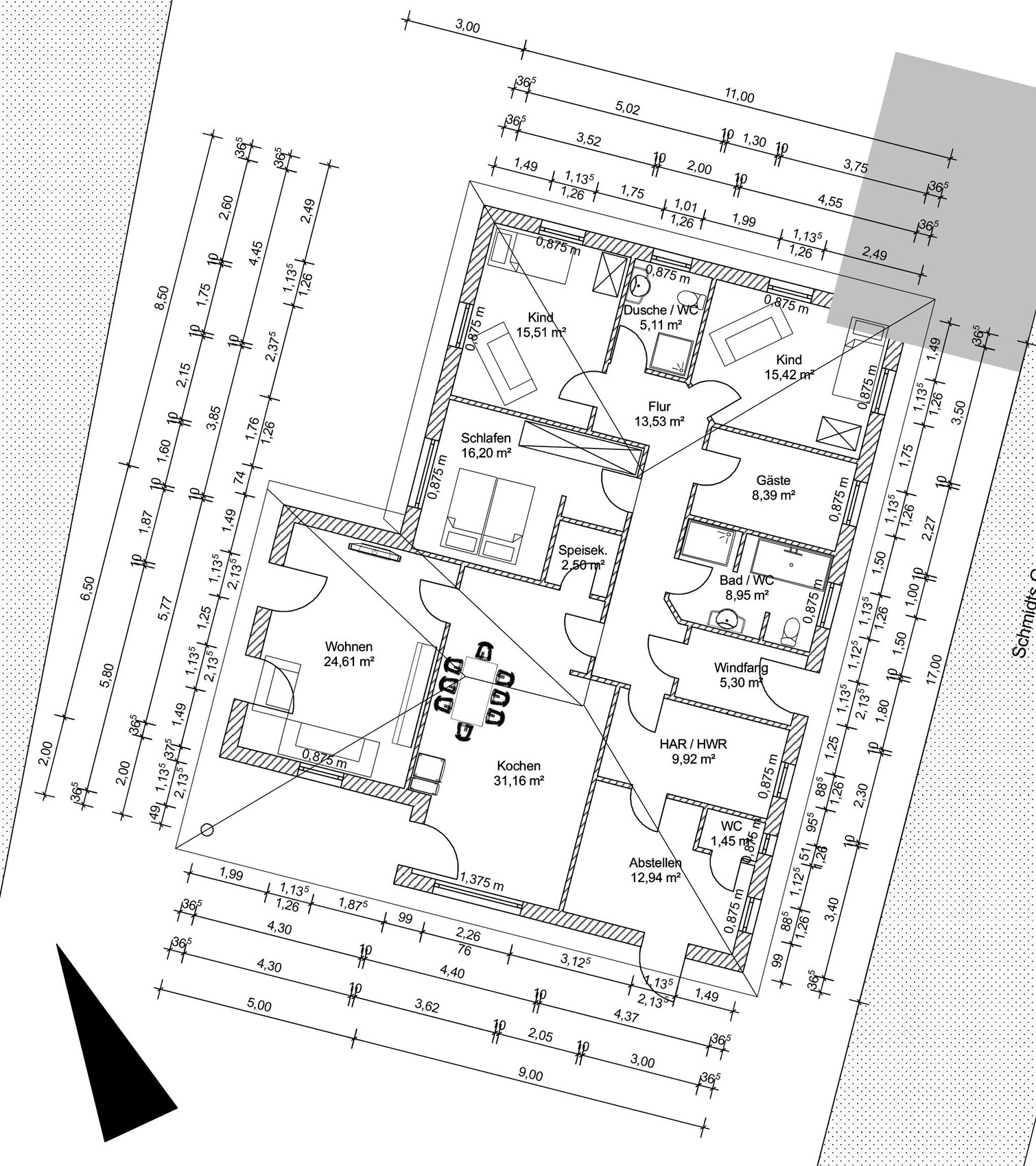

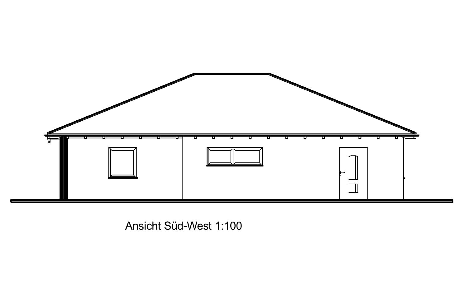

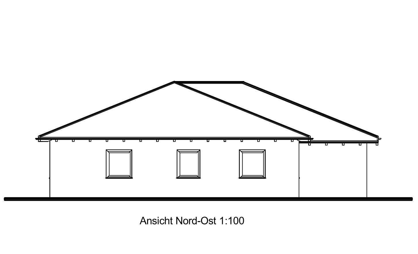

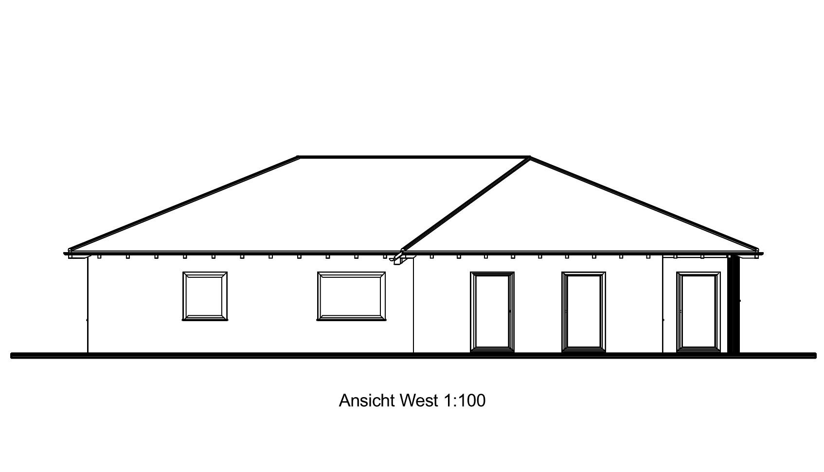

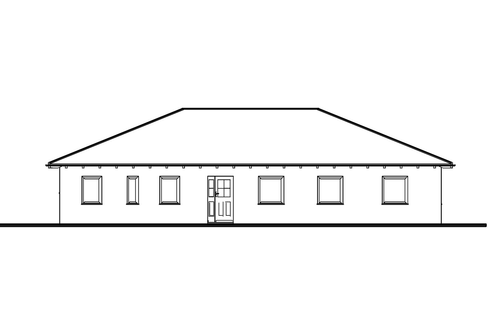

The floor plan was basically determined by the number of rooms, all of which must be included. However, I am concerned that the roof over the terrace and the narrow window will make the kitchen too dark. Otherwise, I would also like improvements in the entrance area and bathroom; I imagine a T-shaped layout rather than the current arrangement. The layout of the children’s rooms with the shower bathroom is more or less fixed, as is the distance between the parents’ area and the terrace.
Any ideas what could be changed? I keep going in circles. I have made a whole stack of sketches but keep returning to this layout. There is no development plan. We have submitted a building code pre-application; the land was previously classified as garden land, and building permission was granted under §34.

Think differently. Imagine the house has a 35-degree roof pitch instead of the 30 degrees your software suggests. This way, you can comfortably walk around on the upper floor. Now combine the kitchen and storage room, and create space in the middle for an L-shaped staircase leading to the basement. That will be your cellar. The kitchen, now in a different location, has two windows and is brighter. Where the small WC used to be, place the pantry instead, which should be unheated.
Another thing I noticed is that the bathroom with the bathtub feels too cramped. There is no space for a cabinet to store towels and similar items. Since you already have another shower, why have two? One bathroom with a shower and one with a bathtub would be better, or alternatively make the bathroom larger.
There is space under the L-shaped staircase for coats and similar items.
I think separating cooking, dining, and living areas is the right approach. I’m not a fan of those large open-plan "railway station halls" that are popular now, combining kitchen, dining, and TV zones. Karsten
Thank you very much for the initial suggestions. Unfortunately, the storage room on the ground floor has to stay, as my husband is self-employed and occasionally needs to store materials or prepare something for the end customer. Some changes definitely still need to be made in the bathroom, but we do need two showers because of our children. Yes, the separation between the kitchen and living room is very, very important to us and will remain.
