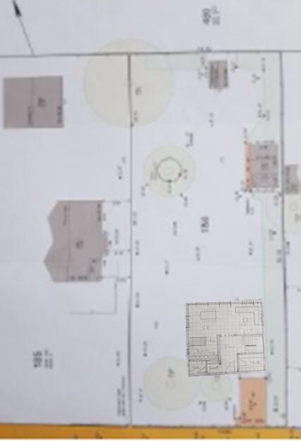

If I understand correctly, it is supposed to be planned this way?
Site plan of a plot: two buildings, garden areas, round tree symbols, dimension details.
Sorry that everything is off, unfortunately the foundations are no better.
I don’t understand why the open-plan living area is designed to face north.
An architect who does not deliver should be dismissed.

@hanghaus2000, yes, that’s exactly how the house should be, you understood correctly.
An open-plan room facing the neighbors doesn’t make sense for us.
If I could terminate someone, I would ... but that’s not possible, so we have to work it out ourselves in a sensible way...

@hanghaus2000 ,yes, that’s exactly how the house should be, you understood correctly.
If I could evict someone, I would ... but since that’s not possible, we have to work out a reasonable solution ourselves...
Instead, you prefer to sit in the dark? Privacy can be created through landscaping or shutters/venetian blinds—whatever works. I would definitely mirror the house.
