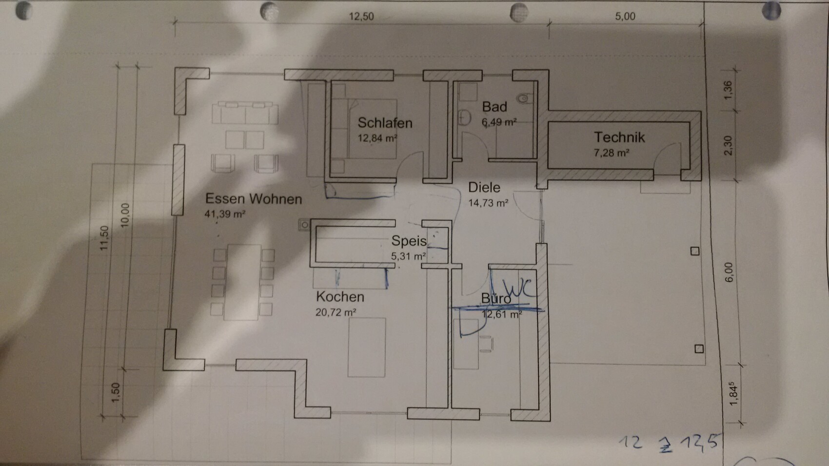

ᐅ Floor plan of a bungalow on a slab foundation, approximately 110 square meters

What kind of oddball is this?
If you subtract the guest WC and hallway from the 12-something area, only 6-something remains for the office. The T-shape layout is not feasible space-wise, and the pantry, given its proportions, is too shallow to be walk-in, let alone for operating a washing machine there.
The hallway is unnecessarily large.
Considering the room proportions, the living areas and kitchen are thoughtlessly oversized – it seems the planner doesn’t really understand appropriate room sizes, does he?

Good evening,
everyone has a bad day sometimes. Welcome here, and be sure to be polite to the women. 😉
A bungalow on a building permit/planning permission without a basement and with 110 sqm (1,184 sq ft) is ambitious, basically like our ground floor. I’d have to check, but it should be roughly that size. You can take a look at our ground floor plan; besides the usual living/dining/kitchen areas, we’ve also included a bathroom, bedroom, and office.
Having the entrance under the carport wouldn’t work for me. Is the carport on the property boundary? Then there are probably regulations regarding the technical installations; I have my doubts about that. Even a garage with a roof terrace loses its status and is not allowed to be built right on the boundary.
If you’re going with a bungalow, plan everything to be accessible without barriers — we all get older. That means at least 1m (3 ft 3 in) wide doors for the main passages.

Portoalegre5 Feb 2016 22:48ypg schrieb:
What kind of character is this?
If you subtract the guest bathroom plus hallway from the total 12 point something, 6 remain for the office. The T-layout simply doesn't work in terms of space, and the pantry is not deep enough to walk into based on the proportions. It's even less practical to operate a washing machine there.
Considering the room proportions, the living areas and kitchen are thoughtlessly too big — it seems the master builder isn’t familiar with proper room sizes, right?
Whether educated or not: practical experience should be applied. Even if geography was the only subject studied.

Best regards, Bauexperte I think we may have been talking past each other. I’ll try to be more specific: My garage is built with 17.5 cm (7 inches) masonry on the boundary line and is allowed. Would masonry of 36.5 cm (14 inches) have been prohibited—because of insulation? If so, where is the limit?
If 36.5 cm (14 inches) is not forbidden, then technically I would have a sufficiently insulated room for the technical equipment. Or where is my misunderstanding?
