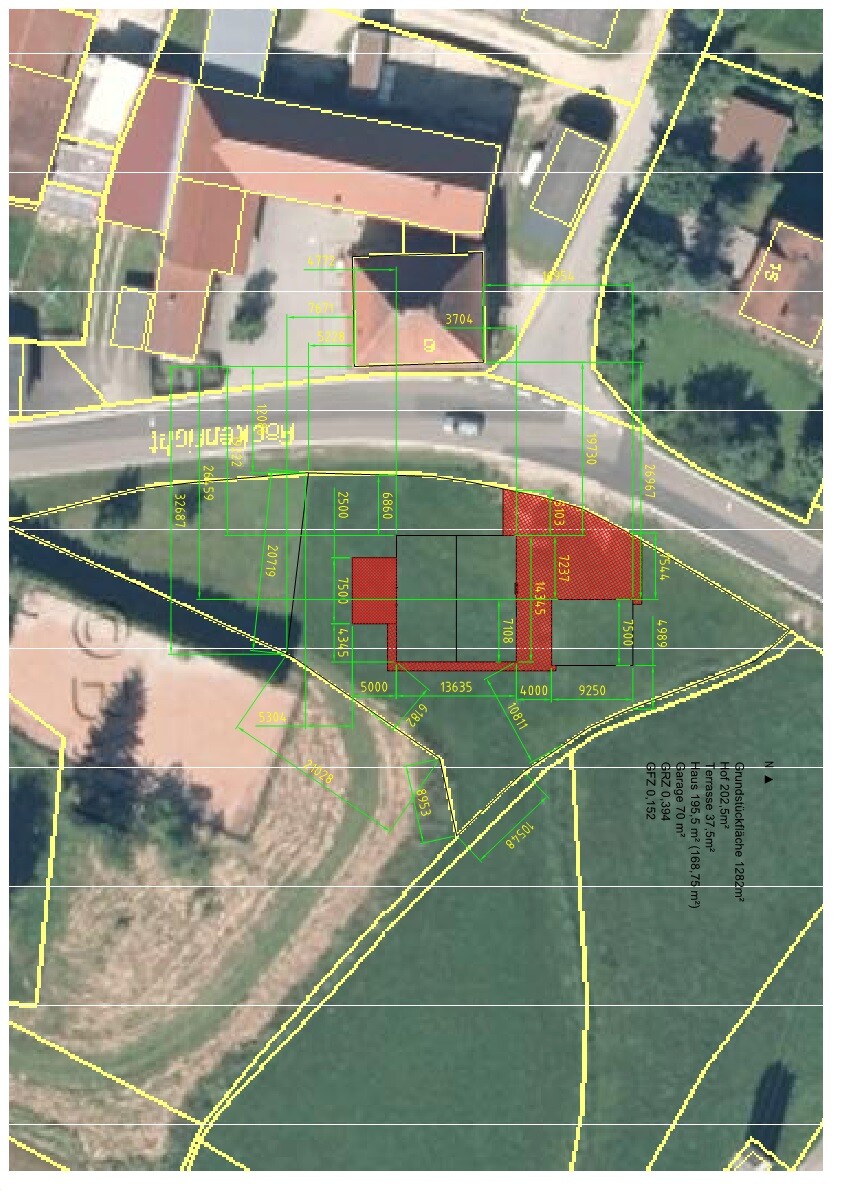

I would like to present my floor plan here for discussion.
Here are the details:
Zoning Plan/Restrictions
Plot size: 1282 m² (approximately 13,800 sq ft)
Slope: Yes, estimated 2 m to 2.5 m (6.5 ft to 8 ft) from southwest to northeast
Site coverage ratio: —
Floor area ratio: —
Building envelope, building line and boundary: No zoning plan available; preliminary building inquiry clarifies all of this.
Edge development: No zoning plan available; preliminary building inquiry clarifies all of this.
Number of floors: 1
Roof type: Gable roof, 22° pitch, ridge orientation east-west
Architectural style: Bungalow
Orientation: Ridge runs east-west
Maximum heights/limits: No zoning plan available; preliminary building inquiry clarifies all of this.
Other requirements: No zoning plan available; preliminary building inquiry clarifies all of this.
Homeowners’ Requirements
Style, roof type, building type: Bungalow, gable roof 22°, ridge east-west
Basement, number of stories: Yes, one story
Number of occupants, ages: 3 persons (30, 29, 15 months); one child planned
Space requirements on ground floor and upper floor: Ground floor at least 140 m² (1,500 sq ft)
Office: Family use rather than home office
Overnight guests per year: 1–2
Open or closed architecture: Rather closed
Conservative or modern construction: More conservative
Open kitchen with island: Closed kitchen
Number of dining seats: 8
Fireplace: Not initially, as district heating is available
Music/sound wall: No
Balcony, roof terrace: No
Garage, carport: Garage
Utility garden, greenhouse: Small utility area
Additional wishes/special features/daily routine, also reasons why certain things should or should not be done
Who designed it: Do-it-yourself
-Planner from a construction company
-Architect
-Do-it-yourself
What do you especially like? Why?
What do you not like? Why? The cloakroom, because there is no space for it
Cost estimate by architect/planner: None asked yet
Personal price limit for the house, including equipment: €450,000 (all costs included)
Preferred heating technology: District heating, about 50 m (165 ft) pipeline from in-laws
If you have to give up anything, which details or additions
-You can give up: Some square meters in the right places
-You cannot give up: —
Why did the design turn out the way it did? For example:
What makes it in your opinion especially good or bad?
The design developed this way. The good part is that everything needed for daily life is on one level; the disadvantage is the cloakroom situation.
I am still working on the basement layout. Rooms planned are office, utility room, heating room, workshop (hobby: model building), storage, possibly a party room.
I would appreciate your opinions and suggestions.
If you have questions or uncertainties (there are surely many), please feel free to ask.
Thank you and best regards,
Benedikt

Why is a 22° roof pitch specified when there is no development plan yet?
My immediate thought when looking at the floor plan with these dimensions: it’s affordable with two chief physician salaries—otherwise, I expect there will be budget cuts.
