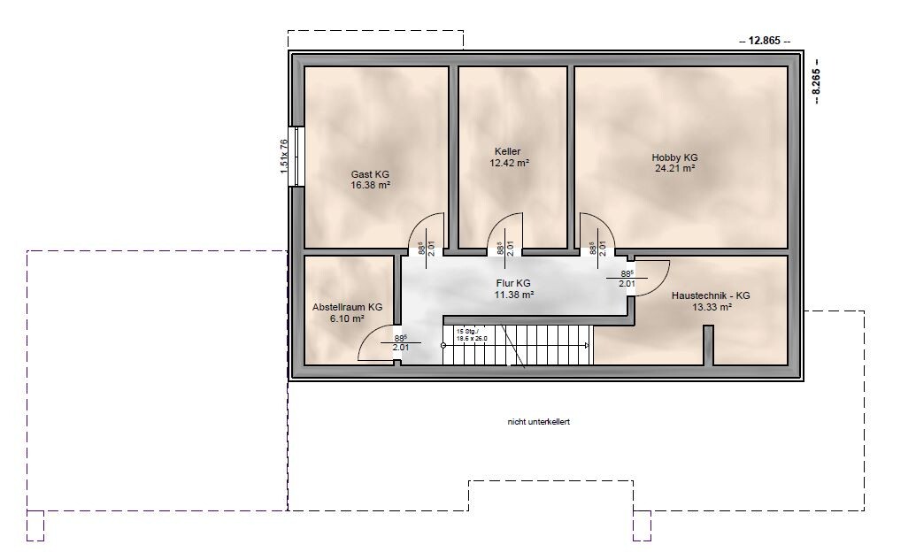

Basement: I think everything is fine there.

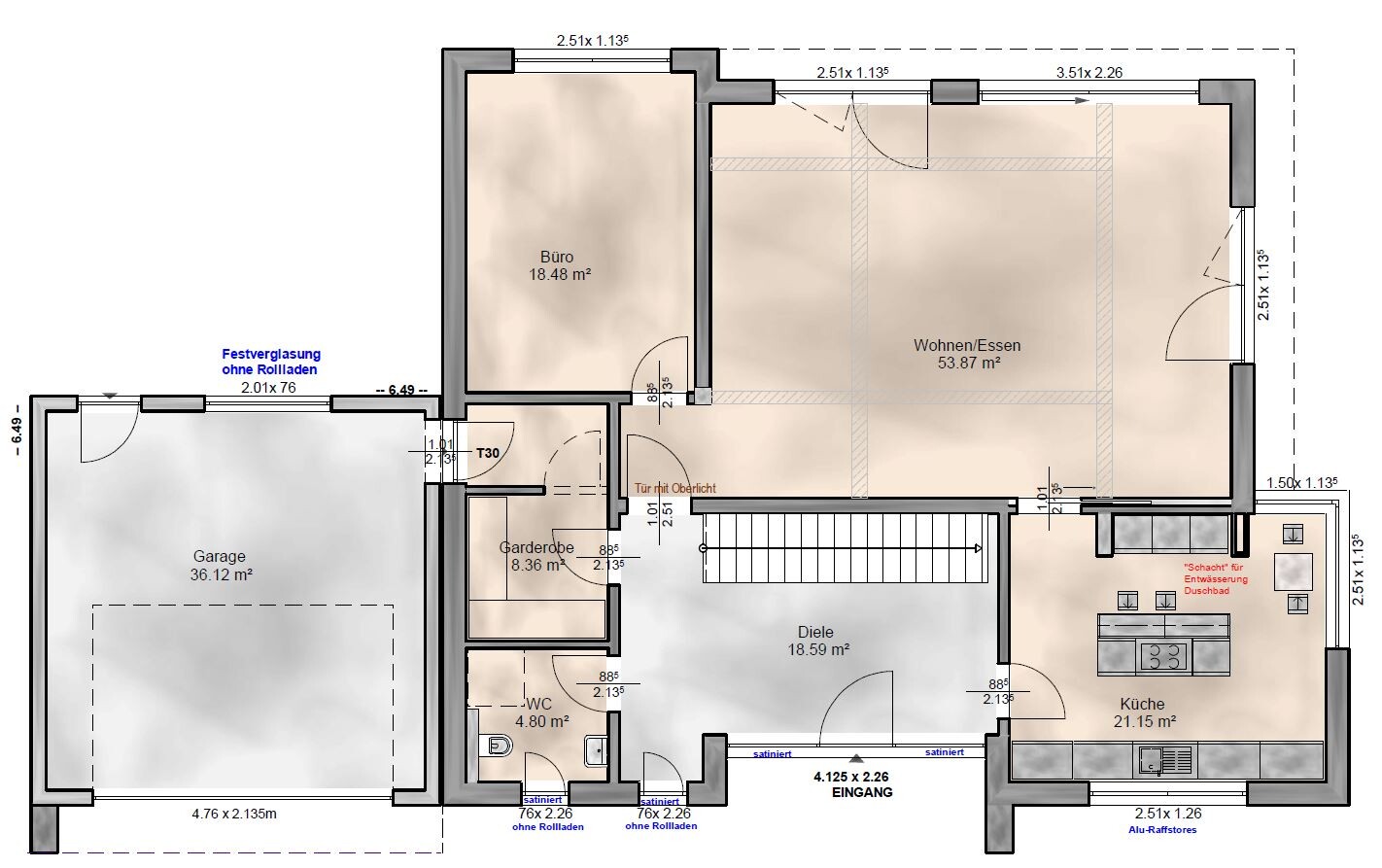

Ground floor:
1) I really don’t like the shaft for the shower drainage in the kitchen. It takes away the option to place a normal kitchen table next to the corner window. Having only a bar where two people can sit is not ideal in my opinion. I’m sure the drainage can be solved differently. The furniture layout with the cabinets was just roughly sketched and was not based on our wishes.
Also, it was originally agreed that the window facing the street in the kitchen would not be so tall but rather a wider, flatter one. We might still want to have that changed.
2) Otherwise, the only things bothering us on the ground floor are the floor-to-ceiling windows in the hallway (partly) – but at least the one in the WC. Sure, they could be frosted, but somehow that doesn’t sit well with us. In the last meeting with the architect, we had also visualized smaller windows, but that didn’t look very good on the facade. Maybe someone else has an idea... especially the WC window really bothers us quite a lot.
3) The small suggested wall next to the garage entrance could be removed if the door is properly clad and instead of seeing a metal door, it looks more homely.

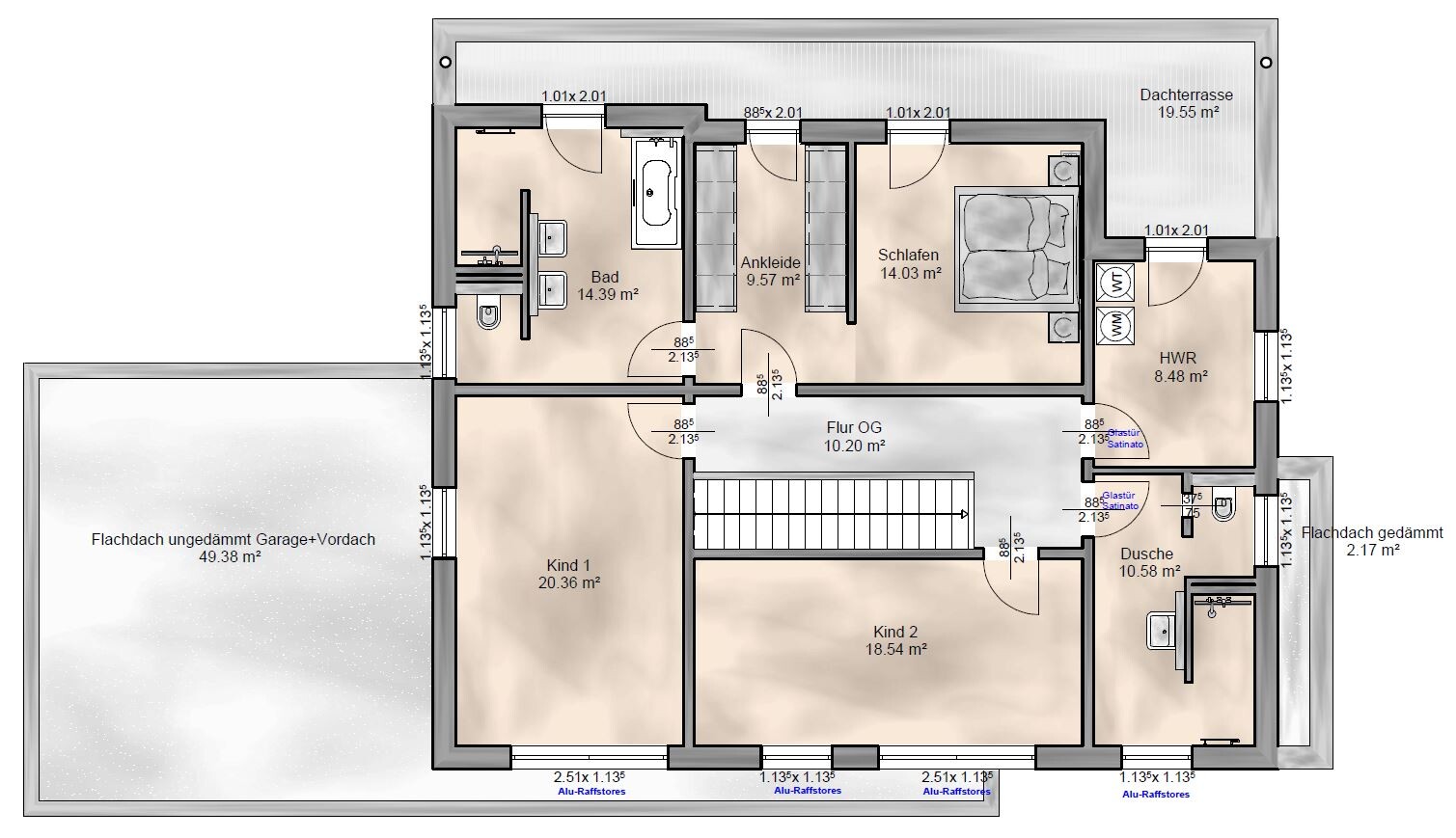

First floor:
4) The window arrangement on the facade has been changed. That doesn’t bother me much, but I wonder if the middle room in the children’s bedrooms is really necessary. In the interior visualization, it doesn’t look very appealing, and I don’t know whether it’s necessary for the exterior appearance either. We had a completely different window arrangement before and did not actually discuss making changes here. I will ask tomorrow why this was done.
5) For the left children’s room, we’re still considering whether the window next to the garage should be removed due to burglary risk. I think it would be a security advantage to leave it out. Or alternatively, equip it with RC 3 security class or install bars. But does that really make sense? I’m not sure.
6) We still need to plan the bathrooms. The furnishing, orientation of showers, WCs, etc., are just roughly drawn in. We want to work those out in detail with the plumbing specialist. I’m not a fan of the partition walls where the sinks are mounted on. Especially in the children’s bathroom, that feels somewhat cramped. And a bathtub will definitely make sense there.
It’s a pity that there are no dimensions included. I would have liked to see how much space there is in the dressing room from cabinet to cabinet.

kaho67414 Sep 2017 21:43
What I keep noticing is that the washing machine is placed practically right next to the bed. I can't imagine that you wouldn't hear it through the wall. I also always thought it was never running when you’re lying in bed. But that’s not the case.
