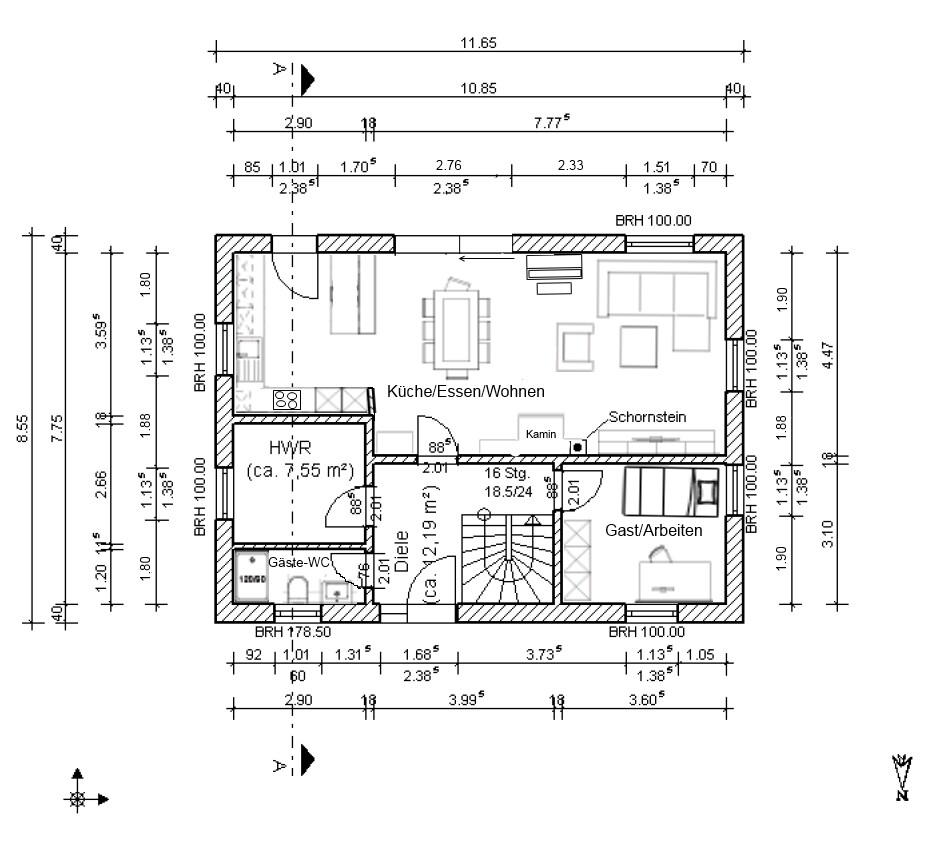

Grundriss: Kochen/Essen/Wohnen, HWR, WC, Diele, Gast, Treppenhaus, Schornstein.

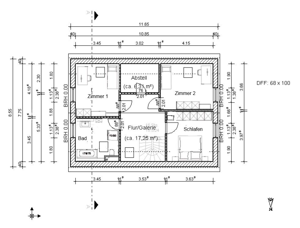

Grundriss Obergeschoss: Zimmer 1, Zimmer 2, Schlafen, Bad, Flur/Galerie, Abstell, Schornstein.

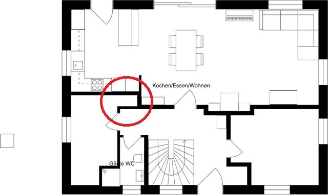

Open kitchen/living area; red marking shows the door between kitchen and living room.
kaho67421 Feb 2018 11:19
chrisw81 schrieb:
And where is the square footage wasted? Whether I have the wardrobe cabinet elongated or more square-shaped, the square footage is the same. Although you don’t have to create a perfectly square wardrobe niche here—you can also make it more elongated with less depth.
So you always want to have built-in closets custom made by a carpenter? Or do you think you can just find a closet with 1m (39 inches) depth in stores? Good luck with that!
Or will you just put some shelves between the concrete walls and hang a door in front? If that suits you...
I personally always plan so that the closets can also be purchased somewhere. A standard depth is 60cm (24 inches) for large closets or 45-50cm (18-20 inches) depth for wardrobes. It’s best if you already start selecting your furniture now.
chrisw81 schrieb:
Whether the staircase is located on the right or left side of the room upstairs shouldn’t be a problem. But of course, you would have to adjust accordingly.
Oh yes, that is always a problem. Especially with sloping ceilings, you always have to think first about the usable space for closets and the shower. Your first draft was not exactly brilliant in this regard.
chrisw81 schrieb:
That would only be for emergencies. I actually don’t want to use it as a bedroom. When the time comes, you’ll adapt—you won’t need a huge room anymore...
Are you planning and building properly or only for emergencies? In an emergency, you could also sleep in a tent outside.

I keep the seasonal wardrobe in the storage room upstairs (which somehow got lost in all these drafts, but it definitely should be there, opposite the staircase upstairs). It should be about 6-7 m² (65-75 sq ft), big enough for several wardrobes for winter coats, also the vacuum cleaner, etc.
What got lost? You first had a draft. This is the 2nd and 3rd without the upper floor.
With 6-7 m² (65-75 sq ft) upstairs, you can fit about one closet in there. The rest will be a few low dressers. Always keep the sloping ceilings in mind. Or do you fold your jackets to fit into drawers?

kaho674 schrieb:
So you always want to have built-in wardrobes custom-made by a carpenter? Or do you think you can easily find a wardrobe with a 1m depth anywhere on the market? Well, good luck with that! Or are you just planning to put some boards between the concrete walls and a door in front? If you like that...
For my part, I always plan so that the wardrobes can also be bought somewhere. A common depth is 60cm (24 inches) for large wardrobes or 45-50cm (18-20 inches) depth for coat storage. It’s best if you pick out the furniture now.
For the niche “in” the guest room, if it really is about 80x90cm (31x35 inches), I wouldn’t install a wardrobe there either, but just a rail for coats. There is also a chest of drawers/tall cabinet in the other corner for gloves, shoes, etc. I also find 45-50cm (18-20 inches) quite shallow for coat storage. Jackets in our home take up about 60-70cm (24-28 inches) in depth if they are not compressed. Therefore, a closed wardrobe is rather unsuitable for coats.

What has been dropped? You had a first draft just recently. This is the second and third draft without the upper floor. A wardrobe will fit in about 6-7m² (65-75 sq ft) on the upper floor pretty exactly. The rest consists of a few low chests of drawers. Always keep the sloping ceilings in mind. Or do you fold your jackets for the drawers?
The storage room was omitted in many designs by other forum members. That one wardrobe would be for coats. Otherwise, only small items would fit there, like Christmas decorations, vacuum cleaner, etc.
I will provide the upper floor plans later.
