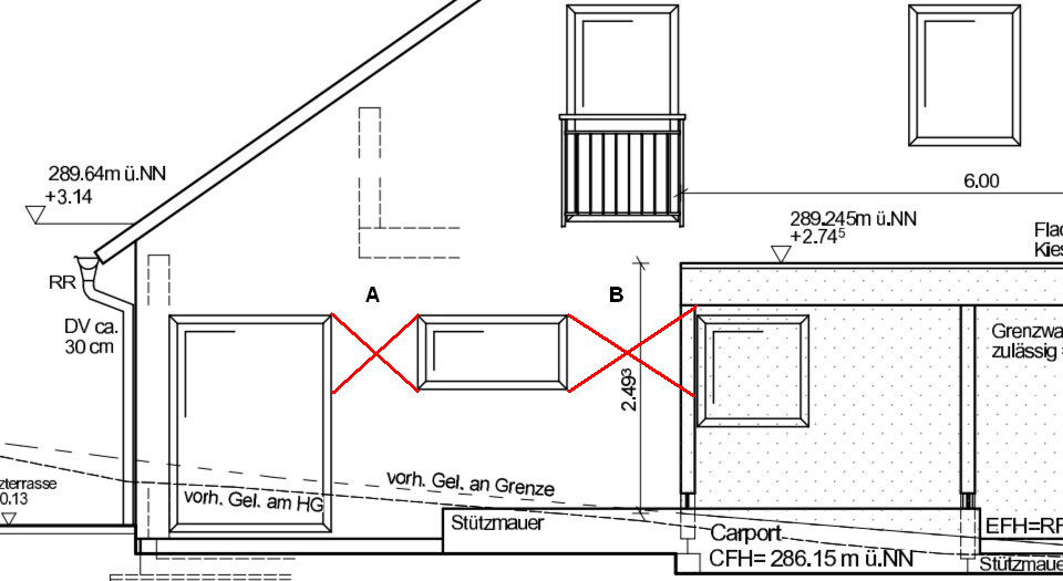

I would soften the stepped junction at the supporting beam and preferably either widen the kitchen or narrow the bay window so that the load-bearing walls align in a straight line:
Regarding the windows, I would
2. not combine them:
neither (A) in the dining area, since they are on two different sides of the roof slope;
nor (B) in the kitchen, because the post of the carport stands between them; and
1. generally rearrange them again,
as currently planned the window distribution on the facade creates a visually unbalanced structure:

I’m willing to accept a less attractive exterior if it means better-lit rooms and improved well-being while working in the kitchen. Window heights can be adjusted. I will probably move the two kitchen windows and the narrow one closer together and visually adapt them.
