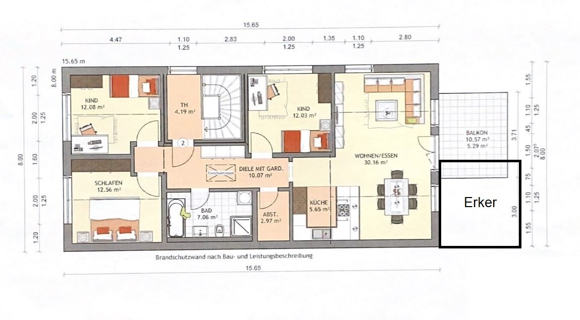

My brother and I are currently planning a duplex. We have now received the first floor plan, but we are not completely satisfied yet. Due to the available plot, we can only build 8 meters (26 feet) wide, but we can extend as far to the back as we want. Additionally, we have to build up to the boundary, which results in a very long party wall. Unfortunately, this means there will be rooms without windows.
In the floor plan below, I think the bathroom is too small, and we wanted to add one more room. Our advisor suggested adding a bay window to the living/dining area for this purpose. The washing machine should be placed in the storage room.
If anyone has any suggestions for improvement, I would be grateful.

@TE please tell us more. Why choose an apartment solution instead of a semi-detached house?
Are children planned or not? The children’s rooms are partly designed as offices?
Could you imagine an unconventional layout or room distribution?
Which room would you like to have more of, and in which apartment?
The bay window on both the upper and ground floors is intended to create an additional room, either a children’s room or an office. So far, we have assumed that a semi-detached house would fit the plot even less well than this.
We welcome any ideas.

I'm not so sure about that. The building services are brighter than the office/children's room. The staircase has natural daylight, the bathroom does not. One apartment only has a balcony. The garden is part of the planning and is a living space, especially with children.
