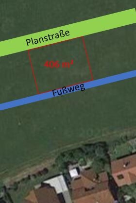

we have made it to the final candidates for a plot of land. Since it is not one of the plots we prioritized in the residential area (3 were allowed to be named), we initially did not consider these plots.
We would appreciate suggestions on how to make efficient use of this rather small plot, to help us decide if the plot is suitable for us in case we are awarded the bid. We are laypeople, and our first idea might not be optimal – perhaps someone here has good ideas and arguments, possibly also for a more westerly orientation?
Our idea: as narrow and wide as possible (e.g., 7m x 12m (23 ft x 39 ft)), with large windows facing SSE, positioning the living room and children’s rooms towards the garden, set as far north as possible so there is still some garden left. Is it advantageous (lower cost) to simply build a pitched roof, or is it better to use the space under the roof – for example, as a sleeping loft for the children’s rooms or as a workspace?
It is not yet known how the neighbor on the adjacent western plot will build, but the plot has a comparable shape.
The orientation of the plan view is north-oriented. Access to the plot is from the north via the planned street (6m wide (20 ft), without a sidewalk, serving only as an access road for about 15 adjacent plots); to the south there is a footpath. On the opposite side of the footpath, there is undeveloped green space up to existing buildings.
Luftbild eines Grundstücksplans mit rotem Umriss, Planstraße grün, Fußweg blau
The plot measures 18m x 22m (59 ft x 72 ft) (long side parallel to the street), approx. 406 m² (4,370 sq ft). A 2.5m (8 ft) setback is required on the north and south sides. The development plan allows for two full stories and a pitched roof with a 30–40° slope.

I would also prefer the house to be long and narrow, but rather 8 x 11 m (26 x 36 ft) instead of 7 x 12 m (23 x 39 ft). With 7 meters (23 ft), the floor plan is more challenging because it’s hard to fit two decent rooms side by side. After subtracting the walls, each room would be just under 3 m (10 ft) wide. And you might not really notice that extra meter in the garden. I would place a single garage only on the east side and add another parking space in front of or to the west side of the house. This can be done without its own access path, meaning it can be directly adjacent to the street. Then the house can be shifted further east, and you benefit from a nice west-facing garden. How far you position the house from the street is up to you. If I had all living and sleeping rooms facing the garden, I would build as close to the street as possible. Even an area of 2.5 x x meters (feet) can accommodate many flowering perennials.
Würfel*
28 Oct 2020 15:31
Oh yes, and definitely have the entrance facing north. This is definitely advisable with an elongated house shape and orientation. Also, this way the mail carrier and others won’t have to walk far into your property or squeeze past your car.
11ant28 Oct 2020 15:45
Würfel* schrieb:
I would also envision the house as long and narrow, but rather than 7 x 12 m (23 x 39 ft), make it more like 8 x 11 m (26 x 36 ft). With 7 meters (23 ft), the floor plan is more difficult because you hardly get two decent rooms side by side. After subtracting walls, they only have about 3 m (10 ft) in width. And you don’t necessarily notice the extra meter in the garden.
You will definitely feel a shortage of one meter inside the house more painfully than you will enjoy having it in the garden. A 7 x 12 m (23 x 39 ft) compared to 8 x 11 m (26 x 36 ft) is roughly a ratio of 1.71:1 versus 1.38:1, meaning that seven by twelve conceptually creates a “single-axis” house (for a rough idea, Google “linear village” compared to “cluster village”), similar to a courtyard house with one roof or – which you would have to be crazy to build as a detached building – similar to a terraced middle house (not quite a “bowling alley,” but not far from it either). Without a constraint like a tight building plot, I would not limit myself to such a format when planning, but rather develop the floor plan freely first.

We have been considering placing the house, approximately 8 m (26 feet) in size, in the far northeast corner for some time now, and we really like that idea. We also like the layout of the garage and parking space.
