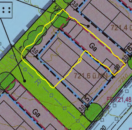

After much consideration, we have decided to build a house with a granny flat (accessory apartment).
Recently, I received the floor plan draft from our architect. Due to the small plot size and my lack of experience, I would like to ask for your assessment and suggestions for improvements.
Building Plan / Restrictions
Plot size: 435m² (about 4,681 sq ft)
Slope: no, but has to be filled to be flush with the street
Site occupancy index (floor area ratio): 0.25
Floor space index (plot ratio): 0.55
Building envelope, building line and boundary: 9 x 12.11m (about 30 x 40 ft)
Edge development: garage -> yes
Roof shape: symmetrical gable roof
Architectural style: open
Orientation
Maximum height / limitations
Other requirements

I’m not sure if you’re allowed to build that large. There are additional ancillary structures as well. @Escroda, could you please take a look?
According to the architect, we are within the building envelope (see pictures).

The building window is not the floor area ratio. The floor area ratio can be exceeded. I am not exactly sure how it is calculated or what is included under it.
