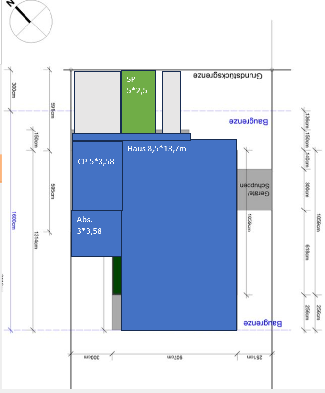

we are currently planning our single-family home. We now have the first draft of our floor plan, but it is not perfect yet. So I thought I’d ask for your advice on what we could still change or improve. Everything is still possible at this stage.
Plot size: 450 m² (4,844 sq ft)
Slope: no
Floor area ratio (FAR): 0.3
Site coverage ratio: 0.6
Building envelope, building line, and boundary: see plan
Edge development: not yet present, as the building area is currently being developed
Number of full stories: 2
Roof type: flat roof with mandatory green roofing
Architectural style: modern
Orientation: south
Maximum heights / limits
Other requirements: 10.5 m (34 ft 5 in) maximum height, Hessian building regulations (Hesse, Germany), new: 2.5 m (8 ft 2 in) setback from neighboring property.
Modern house for 2 adults and two children aged 4 and 6, including basement, 2 full floors.
Space requirements on the ground floor: office, kitchen, pantry, dining area, living room, guest bathroom with shower. Upper floor: 2 children’s bedrooms, master bedroom with walk-in closet, bathroom with bathtub and double sinks. Basement: technical room, utility room, second office, creativity room for crafts, playing, or making music.
Office use: family use or home office? Home office; both parents work three days per week from home.
Number of overnight guests per year: 6, regular overnight visitors.
Open or closed layout:
Conventional or modern construction:
Open kitchen with cooking island: yes
Number of dining places: usually 4, more for guests, birthdays, etc.
Fireplace: no
Music / stereo wall: only TV wall
Balcony or roof terrace: no
Garage or carport: garage plus bike storage
Vegetable garden or greenhouse: yes, vegetable garden
Other wishes / special features / daily routine preferences, including reasons why something should or should not be included: built-in closet in the entrance hall, lots of storage space.
Planner: (interior) architect
Window seat in the kitchen, living room somewhat separated in the bay window, space for an outdoor kitchen on the covered terrace.
What don’t you like? Why?
Location of the shed, we would prefer the staircase as a platform staircase or with straight steps, we wonder if the kitchen is large enough and provides enough storage space. The utility room is too small. Instead of the skylight, we would rather plan a window in the stairwell.
Cost estimate according to the architect/planner: unknown
Personal budget for the house including fittings: 650,000
Why was the design developed this way? Needs analysis with the architect, after which she created the first draft.
Which wishes were implemented by the architect? From the sofa, there should be a view of the garden, lots of storage, master bed 1.60 m x 2 m (5 ft 3 in x 6 ft 7 in) (no need for 2 m x 2 m bed), walk-in closet accessible from the bedroom, covered terrace, covered entrance gate.
What do you think makes it particularly good or bad? We find the layout basically good but not yet perfect.

hanghaus202312 Nov 2025 12:27In short: the white areas are tall cabinets.
10sqm (108 sq ft) is not suitable as a bedroom for elderly people. The guest toilet is also not appropriate as a bathroom for old age or as the main bathroom.
If I were you—and I advise every home builder to do this—I would familiarize myself with the building codes, including the planning permission (or building permit) regulations. We don’t even have these documents from you. Alternatively, consult an experienced architect who can explain your options and apply the state laws correctly. Of course, some members here can help interpret your planning permission, if you have one. However, this is your responsibility. There are planning permissions that are very restrictive and others that offer more freedom. Usually, there are clear reasons behind the various legal paragraphs.
House planning starts with the plot and the planning permission. Then you look at your budget and plan based on your financial possibilities, i.e. how many sqm (sq ft) you can afford. How can I best fit my room program?
650,000 € is a considerable amount. After deducting incidental building costs and the kitchen, the budget is roughly 580,000 €. Subtract garage, shed, paving, and landscaping, and you still have about 530,000 €. Given the design preferences — flat roof, large windows, covered areas — I estimate around 3,300 €/sqm (307 sq ft) and arrive at approximately 160 sqm (1,722 sq ft).
I have the impression that there is a conceptual gap here. Since you initially planned independently without a specialist, you went down the wrong path with the basement and ended up with a mix of “nice-to-haves.” Landing stairs, mudroom, window seats, T-shaped layout, pantry, covered entrance/garage, 3 offices or creative rooms, covered terrace for an outdoor kitchen, ground-floor bedroom for old age, garden view from the sofa, walk-in closet, and so on. Life isn’t quite so simple.
I would actually start with just the basic building shell including parking on the property so that the essentials for living are covered. @hanghaus2023 already gave a good introduction on how to begin in post #47.
What is possible with this and where are the limits? What options do the 160 sqm (or maybe 180 sqm (1,938 sq ft), if you’re in a state where building is cheaper) floor area give you? Room layout: 2 children’s bedrooms, toilet, bathroom, office, kitchen, living and dining area, parents’ bedroom, technical room. Is there space for more rooms? Do the children ride their bikes every day? The narrow lot already imposes a strong grid.
Then it comes down to orientation: technical room east or west, children’s rooms facing south. If you end up with a bare floor plan including stairs, the question is whether you can optimize to include the mudroom, views, or natural light. What is absolutely desired — pantry, window seat — and what can you do without, so that the house doesn’t get longer, exceeding the budget, or require an additional floor?
Have you already spoken to production home builders? Visited model homes and looked at their prices?

Okay, then I don’t understand the garage situation. So the 5 meters (16 ft) of space is only required in front of the garage exit?

hanghaus2023 schrieb:
Then you still have a bit more space.Is your orientation correct, Matthias? If so, I would probably also place the parking spot in the NW.ypg schrieb:

The narrow plot already creates quite a strict grid.
Then it’s about the layout orientations: technical room facing east or west, children’s rooms to the south. If you only have a bare floor plan with stairs, then the question is whether optimizations can be made — for example, focusing on the mudroom, visibility, or lighting. What must be prioritized — pantry, window seat — and what can or must be sacrificed without extending the house beyond the budget, or adding another floor?
Have you already talked to speculative homebuilders? Visited show homes and checked their prices? Of course, at first you start with all your wishes in mind. In reality, we expected to consider feasibility and distinguish between wishful thinking and reality. We appreciate every feedback here and welcome all designs and opinions, but now we’re quite uncertain about how to proceed or what the house can look like... 🙂
Our plan was initially to design a house based on our needs and wishes, and then approach various prefabricated home providers to get comparable offers based on the design.
What are the green areas (P3, P4)?
And is detached housing permitted? I was just thinking of "linked townhouses."P3 and P4 are public green spaces. Only single-family houses are allowed in area 7.
