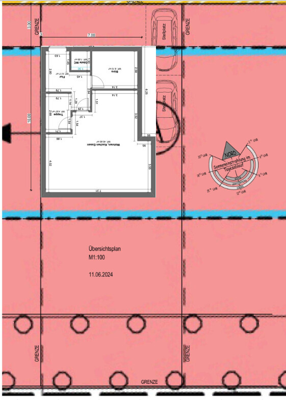

philipp01311 Oct 2024 10:15Do you happen to have an example floor plan or something similar? According to the planner, that wouldn’t make sense, so we had excluded it.
hanghaus202311 Oct 2024 11:43Hello, I have integrated the floor plan into the plot.
You can also see the north arrow there.
However, what is also visible is that the bay window is within the setback area. I am not sure if there is a similar regulation in Baden-Württemberg that might allow this. In my opinion, this is not considered a subordinate structure.
philipp01311 Oct 2024 11:57kbt09 schrieb:
I already showed you a floor plan in post 2 that demonstrates the concept. It even included the idea of moving some of the technical equipment into the attic and completely omitting a basement, mainly for cost reasons. Oh, right, sorry, that’s true. I like that idea, but it causes some issues with our small building envelope. If I understand correctly, the house would have to be reduced again to 10m (33 feet), and we would be entirely dependent on getting a waiver for the terrace—and we would need to discuss this with the neighbor, who currently has different plans.
hanghaus2023 schrieb:
What can also be seen is that the bay window is within the setback area. I’m not sure if there is a rule like that in Baden-Württemberg that would allow this. In my opinion, it’s not a subordinate structure. Thanks. That’s correct. The state building code of Baden-Württemberg classifies bay windows as projections, which are allowed in the setback area up to 5 x 1.5m (16 x 5 feet) provided there is a minimum distance of 2m (6.5 feet) from the neighboring property.
philipp013 schrieb:
I like that, but it does cause some issues with our small building plot. If I’m reading it correctly, the house would have to be shortened again to 10m (33 feet) and The house in post 2 is only 10 m (33 feet) long. However, unlike the plan there, you would probably need to place one parking space lengthwise in front of the house and one on the side.
I’m not sure how you plan to fit the 10.5 m (34.5 feet) house length (or possibly 11 m (36 feet) as discussed) from post 12, plus the “only 3 m” (10 feet) in front of the building plot for the parking spaces so that none of the cars is trapped. That’s why, with such small plots, it’s always better to show the plans laid out within the actual property boundaries.
