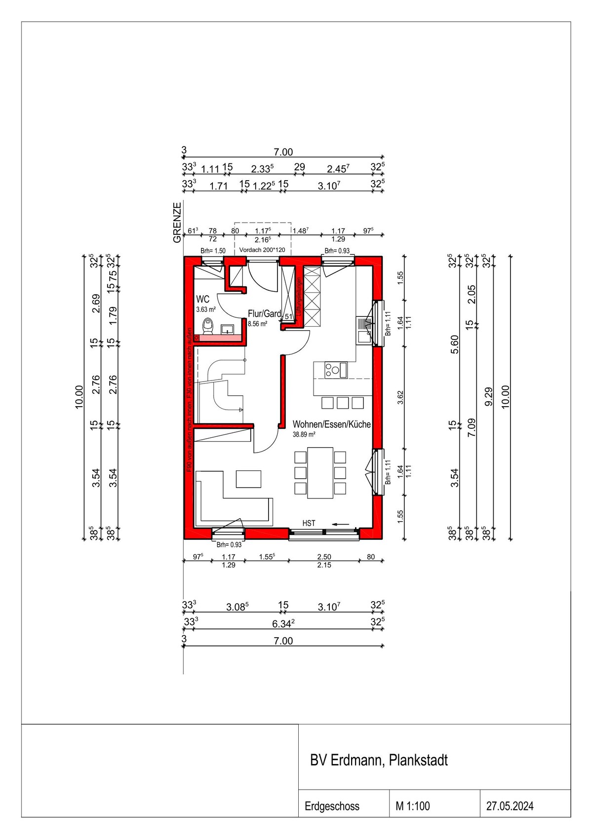

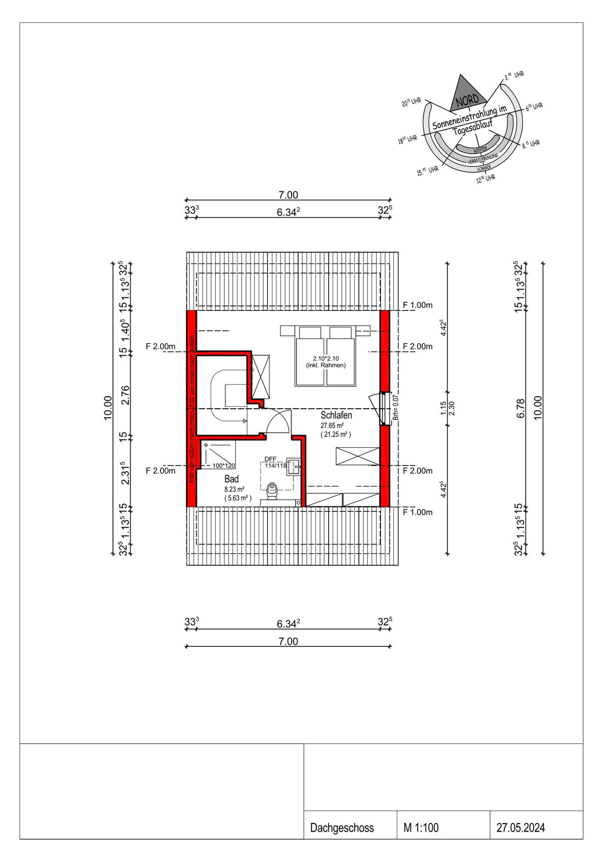

ᐅ Floor Plan Design for a Semi-Detached House for a Single Family (4 People) on a Small Plot
Created on: 1 Aug 2024 00:05
philipp013P
philipp0131 Aug 2024 00:05Hello,

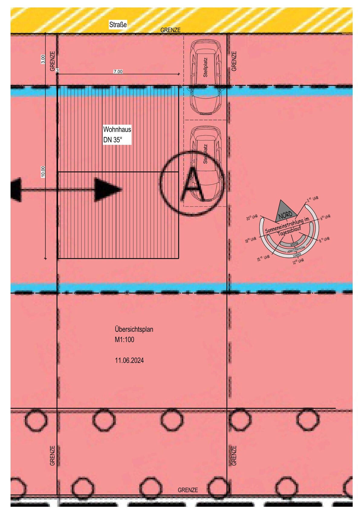

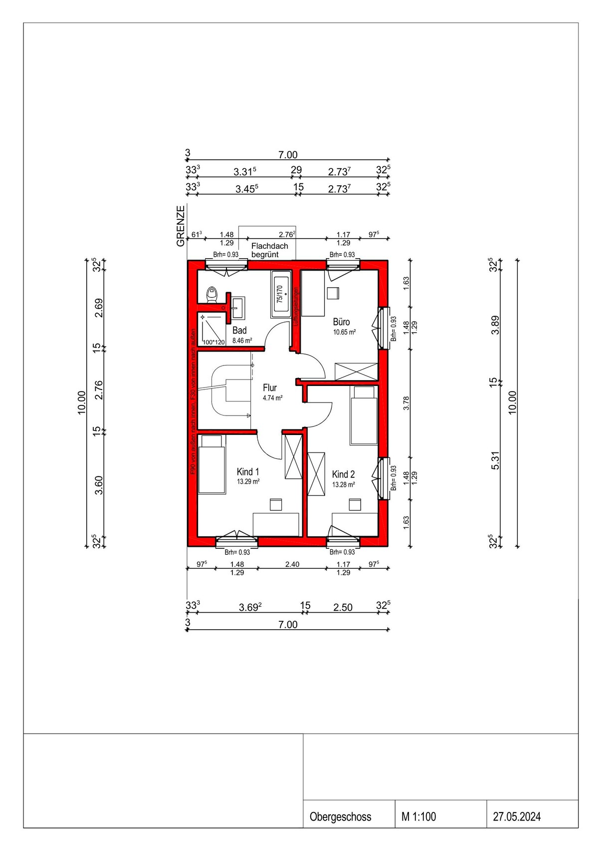

we will be building next year. We have found and purchased a small plot and have already chosen a house provider (we are still waiting for funding, so progress is currently on hold). Regarding the planning, the initial draft from the prefab house consultant is, in my opinion, just a suggestion and far from optimal, so I hope to benefit from the collective knowledge and experience here in the forum. I have attached anonymized floor plans as images.
My main topics right now are the following:
How should we arrange the children’s and parents’ bedrooms?
Where should the home office be located?
How can we fit two nice bathrooms into a small space, one focused on the children, the other more for us?
What alternatives are there for the kitchen-living-dining area, possibly not fully open plan?
Here is more information:
Plot size: 270m² (approximately 2900 sq ft) – 27 x 10 m (89 x 33 ft)
Slope: no, but a slope bank; the street is about 1.4 m (4.6 ft) higher than the rest of the lot.
Floor space index: 0.4
Building window, building line and boundary: 12 x 10 m (39 x 33 ft) building window, 3 m (10 ft) from the street, sketch attached
Edge development mandatory, as it is a semi-detached house (see plan)
Parking spaces: 2

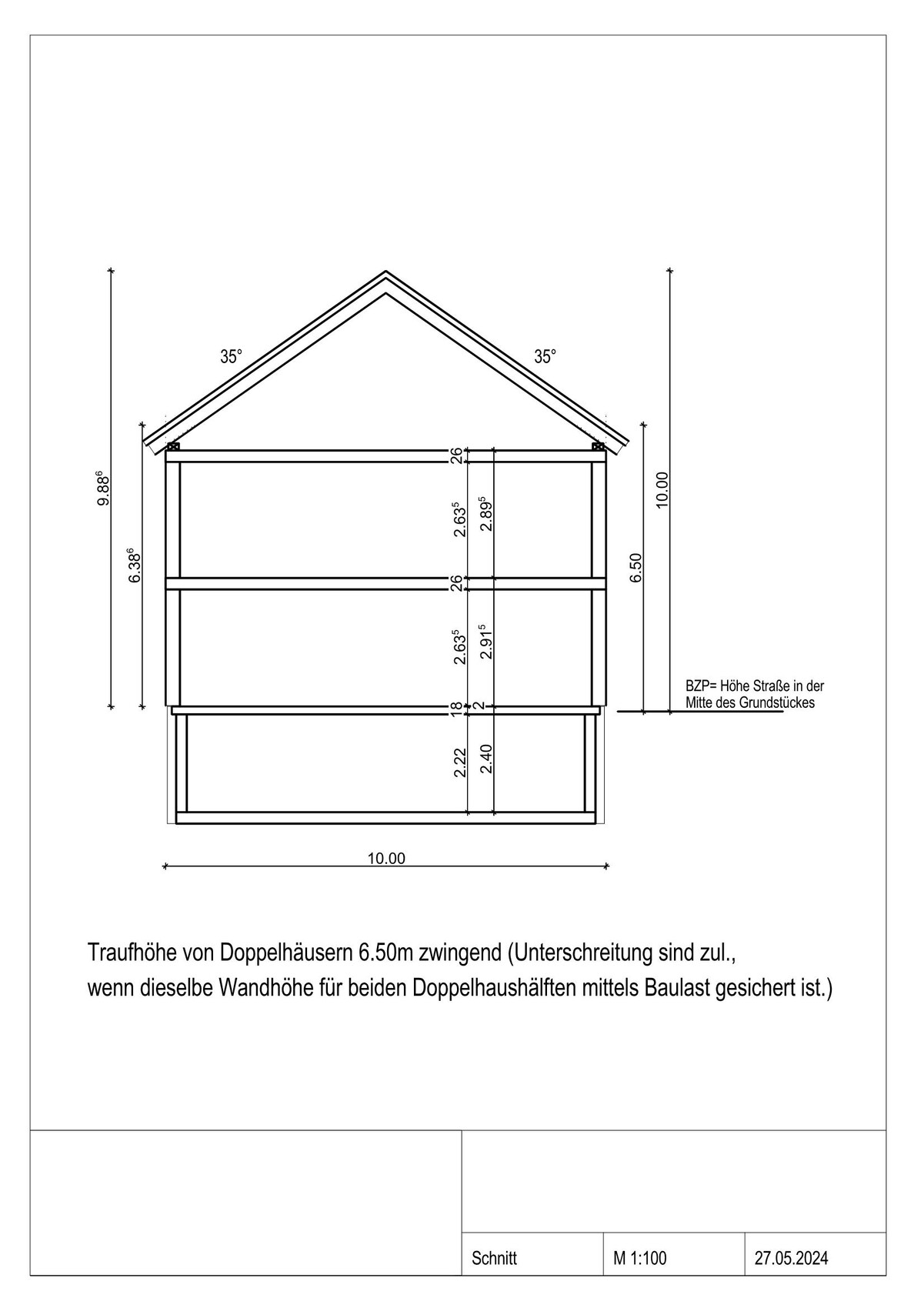

Number of floors: 2.5 (2 full floors required, 6.5 m (21 ft) eaves height mandatory, also a maximum building height of 10 m (33 ft) from street level)
Roof type: 35° pitched roof
Style: classic?
Orientation: north-south
Maximum heights / limits: see above, 10 m (33 ft) max, exactly 6.5 m (21 ft) eaves height
Homeowners’ requirements
Basement, floors: Due to the slope and small area, we want a usable basement. We also want to finish the attic (now or later).
Number of people, ages: 2 adults, late 30s, 2 children (0 and 3 years old)
Space requirements on ground and upper floors: Basement: laundry and utility room, hobby room, possibly with a separate outdoor staircase; Ground floor: living, dining, kitchen, guest WC, possibly home office; Upper floor: 2 children’s rooms (ideally about 14–15 m² (150–160 sq ft) each), bathroom, possibly home office or guest room or parents’ bedroom (I think that might be too tight but open to suggestions!), Attic: an additional bathroom (unclear whether a bathroom with bathtub should be in the upper or attic floor), parents’ bedroom, possibly home office (we don’t actually need a huge bedroom, hence the considerations). Because of the children’s ages, we would prefer to live on one floor with them, but I am struggling to create a good layout that fits three bedrooms and a bathroom.
Office: family use or home office? A home office is essential, at least a small one.
Open or closed architecture? It can be open, but for example, despite an open living-kitchen-dining area, we want the staircase separated to reduce noise (from children, for example) or cooking smells. Open to suggestions!
Conservative or modern architecture: I’d say rather modern but simple.
Open kitchen, kitchen island: Open kitchen preferred; thinking of an L-shape with a small breakfast bar. We like cooking a lot, so this area is important.
Number of dining seats: 6–8 seats, one dining table. If kitchen and living-dining area are separated, then probably a second eating area in the kitchen.
Fireplace: no
Music / stereo wall: not needed
Garage, carport: Carport planned, possibly with a storage room.
Utility garden, greenhouse: not planned
Further wishes / special features / daily routine, including reasons why certain things are or are not preferred:
Since the second child is not yet born, we are not 100% sure about the daily routine. We currently live in a 4-room apartment. Ideally, we would like all bedrooms on one floor (maybe we would move then, so we might live on one floor for the first years and then move to the attic?). My wife definitely wants a WC or, preferably, a shower bathroom on the sleeping floor. We spend a lot of time in the kitchen and dining area; we rarely sit on the sofa, so the kitchen-dining area feels more central to us than the living room seating.
I often work from home, so the office must be more than just a small closet, but only needs a desk and some storage for files, etc. It should also allow me to retreat (e.g., working in the evening on the computer). My wife also occasionally works from home (she is a teacher), so two desks would be ideal; we know this might be tight.
Who designed the plan: House seller/"planner" prefab house company
What do you particularly like and why? The fairly large children’s rooms, as they are more important for us than the parents’ bedroom (only bed and wardrobe needed there).
An office with good lighting so that working is enjoyable.
Lots of windows (especially on the ground floor), hopefully providing enough natural light.
Lots of space on the ground floor since much family life will happen there in the coming years.
What do you not like and why?
The "large" bathroom on the upper floor if we live in the attic, because we would prefer the comfort of a bathtub, which the children probably wouldn’t care about.
The attic window on the south side should be removed, so the bathroom should be moved to the north side – the south side should be fully covered with photovoltaic panels. Currently, because of the staircase position, everything would be shifted, and I don’t understand how the rooms would look then or how else to solve this.
Possibly the office on the upper floor, if the children get noisy and I have appointments…
The feeling that the spacious ground floor wastes space and may not offer any retreat areas or similar.
Price estimate according to architect/planner: approx. 415,000 euros
Personal budget limit for the house including equipment: approx. 425,000 euros
Preferred heating technology: heat pump, air-to-air, indoor installation, underfloor heating
If you have to give up items / expansions
- What you can do without: guest room, significantly larger bathroom, huge office, huge parents’ bedroom
- What you cannot do without: two children’s bedrooms with at least about 14 m² (150 sq ft), two bathrooms (shower or bathtub), guest WC
Why is the current design like it is?
It is strongly based on the standard with a few wishes, such as larger children’s rooms. Overall, there hasn’t really been much thought given yet to what makes sense and what will feel comfortable to live in.
Style: classic?

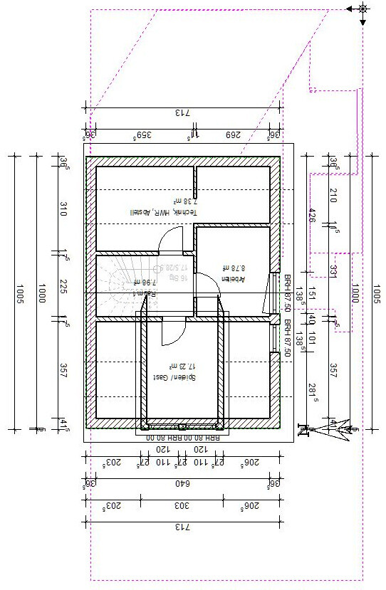

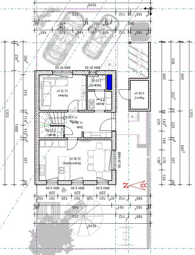

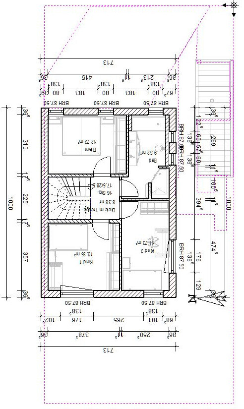

This reminds me of Goalkeeper; the thread is definitely worth reading, also because of the issues that can arise with a second client: https://www.hausbau-forum.de/threads/grundrissplanung-reh-mit-ca-145qm.31278/
425,000 euros for the house including the basement seems ambitious.
For Goalkeeper, I once created a design that planned the technical rooms in the attic, with angled parking spaces side by side in front of the house. On the right side of the house, on the property boundary, there is a kind of garden shed with a lockable extension for bicycles.
This may make the garden behind the house somewhat smaller, but fully usable. A conveniently accessible place for bicycles should definitely be planned. The kitchen is located nicely right next to the garden, while the living area serves more as a retreat for TV, reading, etc.
Side entrance... here are just the pictures without further comment.
hanghaus20231 Aug 2024 12:27Is the builder for the other semi-detached house already available?
philipp013 schrieb:
The attic window on the south side should be removed, so the bathroom should be moved to the north side.Moving the bathroom towards the top of the plan makes sense because toilets drain through the roof (all of them), so it’s more practical to stack them, and nobody wants the drain pipe in the living room on the ground floor.philipp013 schrieb:
The position of the staircase shifts the whole thing,There’s hardly any flexibility here due to the roof heights. I would keep the staircase as is and adjust the bathroom accordingly.philipp013 schrieb:
no private retreat spacesHow much space do you need? You have the attic floor for yourselves, right? However, I would swap the living room with the kitchen. Then make the toilet narrower, move the wardrobe to the left side of the plan, and use the room as a private retreat. The kitchen would then be adjacent to the terrace, thus separating the living area from the quiet zone.
hanghaus20231 Aug 2024 20:29ypg schrieb:
Moving the bathroom to the top of the plan makes sense because toilets are drained through the roof entwässern You don’t really mean that, do you? Or is that autocorrect? More likely you meant venting.
The budget is extremely tight and, in my opinion, doesn’t really match your expectations. You can tell because the planner is already very close to your maximum budget, and they tend to underestimate costs. By my calculations, there’s just enough for two floors and a basement. The roof will be quite limited. If I’m reading this correctly, you could actually build 7 x 12 meters (23 x 39 feet), but the funds only allow for 7 x 10 meters (23 x 33 feet), right? Unfortunately, that’s not very encouraging. Under these circumstances, I also don’t see any possibility for 15 square meter (161 square feet) children’s rooms. The sketches clearly show there’s hardly any space left to take away from other rooms to give to the children. However, I think 13 square meters (140 square feet) for children’s rooms is perfectly fine.
Overall, I fear you may need to lower your expectations a bit or increase your budget.
