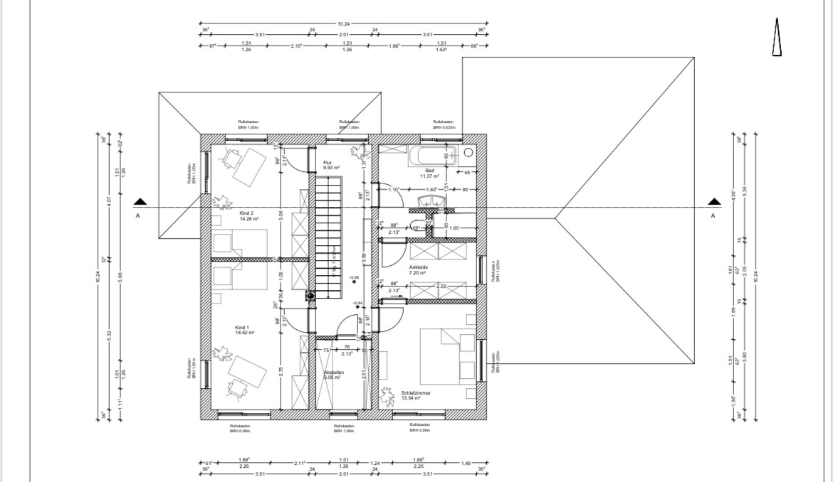

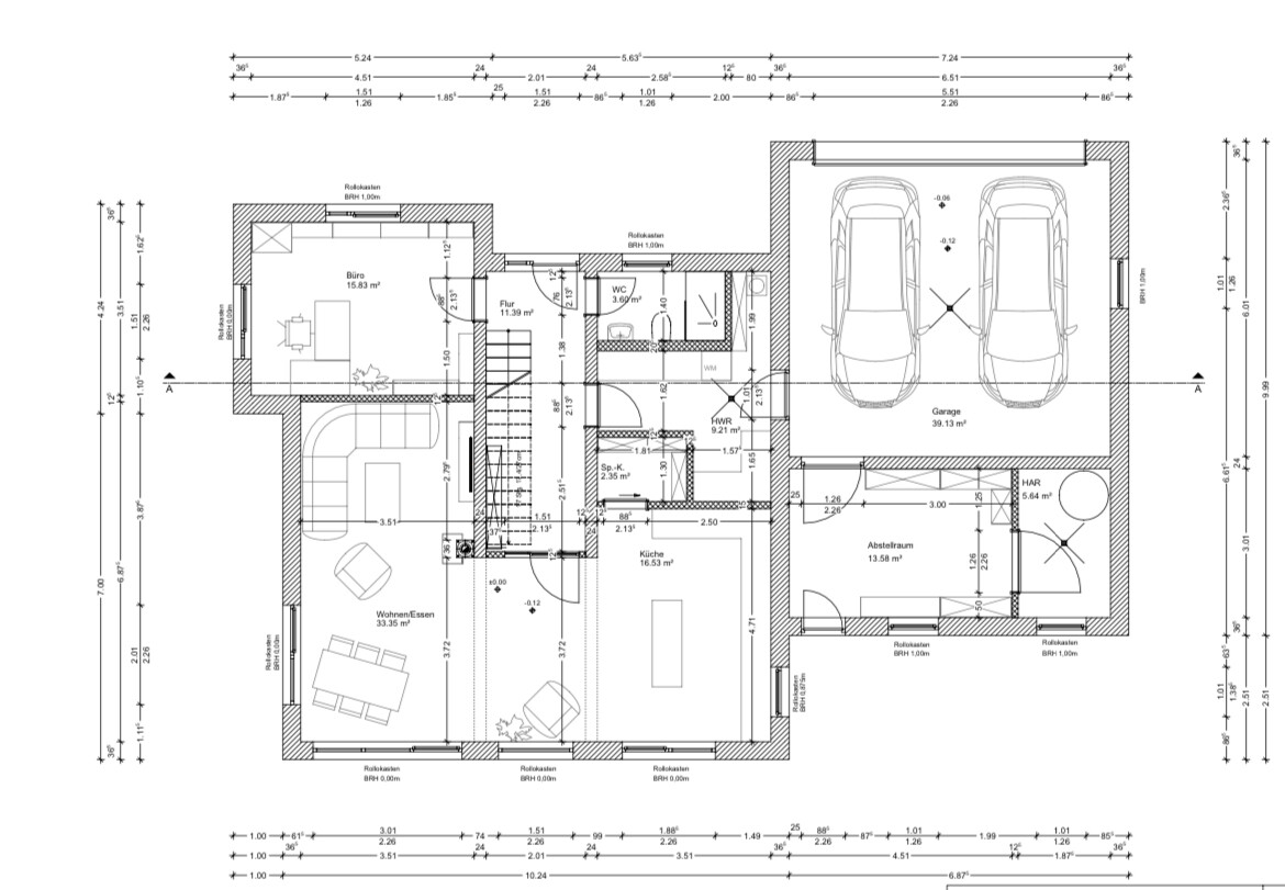

Single-family home – urban villa with 170m2 (1,830 sq ft) including garage, no basement – dissatisfied with floor plan design
We have been planning our floor plan for over a year now. Unfortunately, after the fifth draft, I am still not satisfied—at least with the ground floor. In my opinion, the upper floor turned out really well.
Maybe you can help me/us. We have the following issues:
- Too narrow distance between sofa and TV
- Long walking distances due to straight staircase
- No cloakroom (due to the narrow hallway, placing one under the stairs is not an option)
Do you have any suggestions for improvement?
We also don’t want to start completely from scratch again.

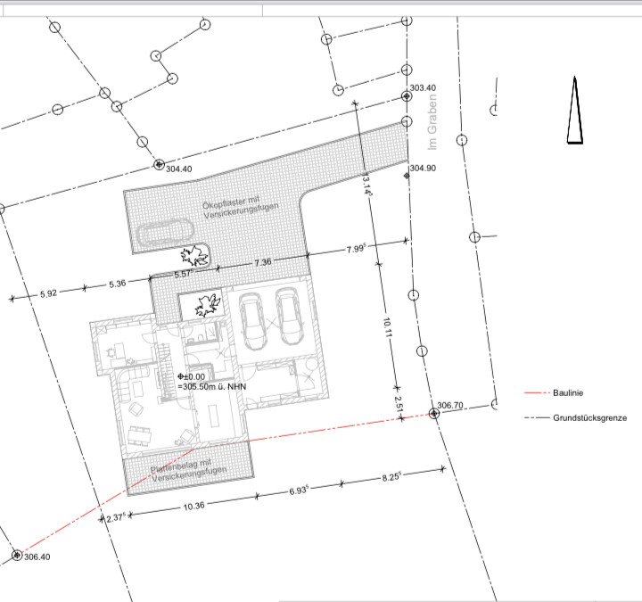

Now I also understand why nothing is progressing. Neither the information nor the budget is sufficient, and no one can identify the property boundaries. On top of that, the oversized design with a massive driveway and a paved courtyard seems excessive. In my opinion, all of this is quite unrealistic.

- Architect: yesThis worries me on your behalf.If I open the front door and almost fall down the stairs (okay, a slight exaggeration), and there is no coat rack in sight, I don’t need to worry about anything else because this is already a dead end.

Without a budget, the floor plan can’t be properly evaluated. As it stands, you could only build a house half that size. So you would have to try to reduce everything drastically. The budget is a crucial piece of information.

You are only allowed to build this way, and the site conditions don’t allow anything else. That wasn’t my question... I’m only asking about the floor plan... Allowed to build only this way? There’s no information about the zoning or building regulations. Do you want help or not?
