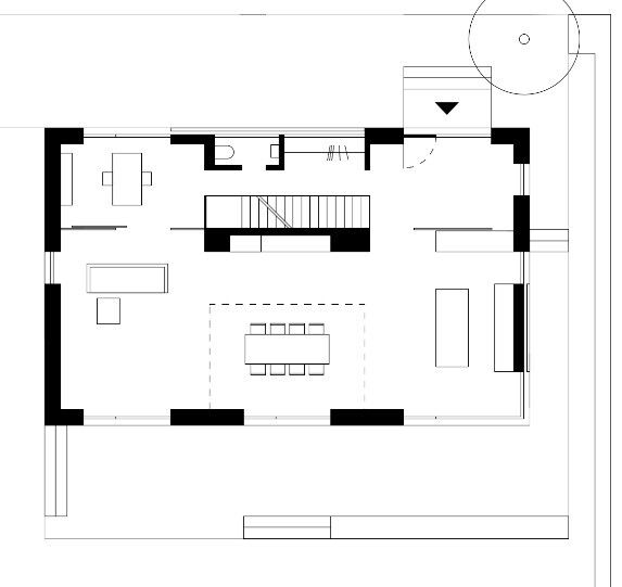

Yes, the space needs to be furnishable. I never claimed that the floor plan is good. On the contrary, I did not praise it at all. My point was solely about the dogma that a gallery space is bad or only feasible from 250 sqm (2690 sq ft) upwards. It remains a matter of personal taste. Some prefer a large bedroom with en-suite bathroom and walk-in closet; others want a gallery. I agree with you that it should be possible to furnish it. But I hope we don’t have to start a fundamental debate.
@ OP:
Here is a floor plan from a well-known architect in Hamburg. Maybe it will serve as inspiration.
EDIT: The technical rooms are located in the basement.
If the thread is closed, I of course have no objection.

Much has already been said! What I don’t understand is why the original poster (OP) doesn’t want to work on the floor plan with the forum. But well, everyone is entitled to their own preferences.
I would consider such a large gallery reasonable only under these three conditions:
1. The house would be built larger.
2. The bay window would be removed.
3. The entire south side would be glazed using a post-and-beam facade, from floor to roof.
For me, point 3 alone would be the reason to want such a “mega” gallery.
Then I would have a beautiful catalog house that would put a smile on my face every day because of the view, but unfortunately nothing practical for everyday use.
Apparently, the OP doesn’t have a TV because there’s no wall space for it. :-p

I already wish the children a lot of fun and effective antidepressants. In return, they will be rewarded with a 50 m² (540 sq ft) gallery; you have to set priorities. In my opinion, the bay window should also have a full-width lift-and-slide door.
Bookstar
17 Sep 2018 14:51
The floor plan was definitely drawn by the homeowner. No architect would commit such a crime... or would they?
South17 Sep 2018 15:03
If this concerns the floor plan I posted: The house was built for clients in Hamburg/Blankenese and has received several awards. I’m not sure if a link would violate forum rules, but it can also be found on Google using the keywords.
If you are indeed referring to the posted floor plan, here is my conclusion:
1. Tastes can be very different
2. "Crime"... I feel like I’m in the green forum.
haydee
17 Sep 2018 15:30
Awards don’t mean much.
Our neighbor’s house has also received multiple awards.
Shooting slots instead of windows
Leaky roof
Tiny rooms
But visually, it’s really something different.
South, the floor plan you showed is leagues better than the one from the OP.
