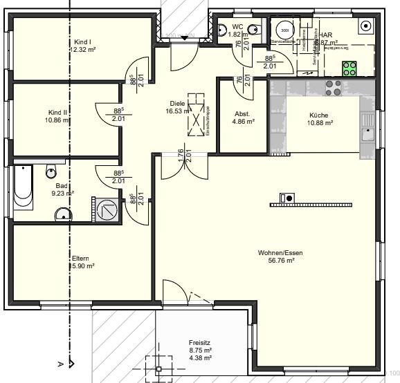

I came across this forum and would like to share my floor plan with you.
To briefly explain my building project and myself: I am 28 years old, currently single, and no children are planned. It will be a bungalow because I simply like them and find them cozy. My total budget is fully used up at €330,000. Therefore, I am initially leaving out a carport, garden/tool shed, and landscaping.
A carport will be added later on the right side of the house.
I look forward to ideas or suggestions for improvement.
Please excuse my rough sketch, as I do not yet have a floor plan from the architect at this stage.
Plot size: 736 sqm (7,922 sq ft)

What do I like most? Why?
The overall layout—I have thought a lot and considered many aspects
What do I not like? Why?
I’m a bit worried it might be too small if a partner moves in (children are not planned)
Cost estimate according to architect/planner: €243,000 for technical completion, solid construction
Personal price limit for the house including fixtures: budget fully exhausted
Preferred heating technology: air-to-water heat pump without ventilation system
If you have to give something up...:
I think I’ve already given up everything non-essential 😀
The design is based on the budget. This is the maximum that could be achieved. That’s also why, for example, the carport will come later.

Since we also have a bungalow:
Roof: Even under a cold roof, you can store things very well. Don’t underestimate the storage space; you will definitely need it. By the way, we built a half-hipped roof and gained a really nice amount of space.
Utility room: Avoid placing it next to a bedroom. When the heating turns on or the washing machine is running, it can be quite disturbing. A thick wall won’t help much; the noise travels right through the door. Also, it tends to get quite warm there. A dryer can heat the room up quickly. It’s not advisable to store food there.
Hallway: Personally, I’m a big fan of “rounded” hallways. This way, you don’t have to rush your guests through a narrow corridor, and you have some space to set down groceries or other items without having to step over them. Don’t forget your coat storage!
Bathroom: Whether you really need a guest bathroom is debatable. I just find it nicer not to have to put away my bra when visitors come.
You might also want to consider if the square layout is really necessary. An L-shaped floor plan is much easier to furnish and often includes a covered terrace.
I’ve attached our floor plan so you can see what I mean by a rounded hallway.

Puschel92 schrieb:
I also liked the idea of a shed roof, but it was rejected again. Because of the costs and because you would have to build it so steep that a second floor is created, or otherwise you don’t get much benefit except for a high ceiling.
Was that decision made by you or by WHOM? A GC might reject it quickly because it’s not a standard design. It doesn’t have to be so steep to create a full second floor. An open living space gives a completely different living experience, more light, and more design options. If the sleeping area needs to be dark, such a mezzanine can be used differently.
I would try to keep the interior more open, flexible, and free without necessarily increasing the overall cost.
But of course, it has to suit YOUR personal taste; maybe it’s worth taking your time and planning again, maybe even in parallel or with adjustments.
Take a look at the floor plan or partly open construction style from [USER=51599]@Nida35a or the floor plans from the Scandinavian company EBK. An open living area or other design elements aren’t really “necessary,” but then, what really is? At least I find it great.

To clarify briefly, I am a woman 🙂 so if a man comes into my life, I’m the woman with the house 😀
The company is already decided, and the contract is signed. The floor plan is basically set too, although I’m probably a bit late with my considerations that could change everything.
@Evolith I actually wanted an L-shaped layout at first, but for cost reasons it unfortunately became a rectangle. Whether a prefab house or a solid build, an L-shape was always beyond my budget.
I’ll take a look at your ideas—maybe I can still incorporate some of them.

Zoning: Swap the utility room and bathroom. At the end of the hallway, include a separate storage room. Ensure there is 70 cm (28 inches) of space behind the bedroom door to place the wardrobe there.
Puschel92
4 Jan 2021 14:43
@ypg The idea is good, but there is a door from the utility room leading outside under the carport. That would be removed, and I did not want to give that up.
