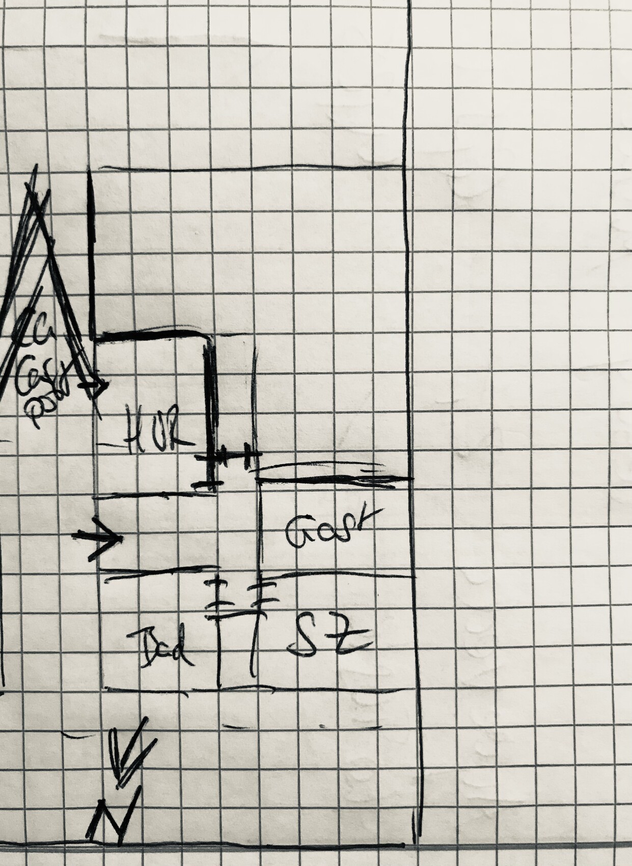

I came across this forum and would like to share my floor plan with you.
To briefly explain my building project and myself: I am 28 years old, currently single, and no children are planned. It will be a bungalow because I simply like them and find them cozy. My total budget is fully used up at €330,000. Therefore, I am initially leaving out a carport, garden/tool shed, and landscaping.
A carport will be added later on the right side of the house.
I look forward to ideas or suggestions for improvement.
Please excuse my rough sketch, as I do not yet have a floor plan from the architect at this stage.
Plot size: 736 sqm (7,922 sq ft)

Orientation: north, see picture, front of house should be parallel to the street

The overall layout—I have thought a lot and considered many aspects
What do I not like? Why?
I’m a bit worried it might be too small if a partner moves in (children are not planned)

The design is based on the budget. This is the maximum that could be achieved. That’s also why, for example, the carport will come later.

The door from the utility room to the future carport is extremely important to me, With a passage!
The utility room with an external door was justified and implemented by our architect as follows:
- short distance to the drying rack,
- tradespeople don’t have to walk through the house 20 times, and the van can park right outside with the side door open,
- bulky hardware store purchases can be brought straight inside.
All these points are valid, and this door is worth it to us.

I’m adding a sketch here: Does this fit the plot? I see south = street on the right side of the plan – is that correct?

hampshire schrieb:
@Puschel92: I often wonder why some houses have only one main entrance.Because the main entrance is now only used for special occasions. In our house, it goes unused for days. Everything is accessed through the garage or utility area. Not very attractive, but practical.
Strollers and kids’ gear stay dry this way.
