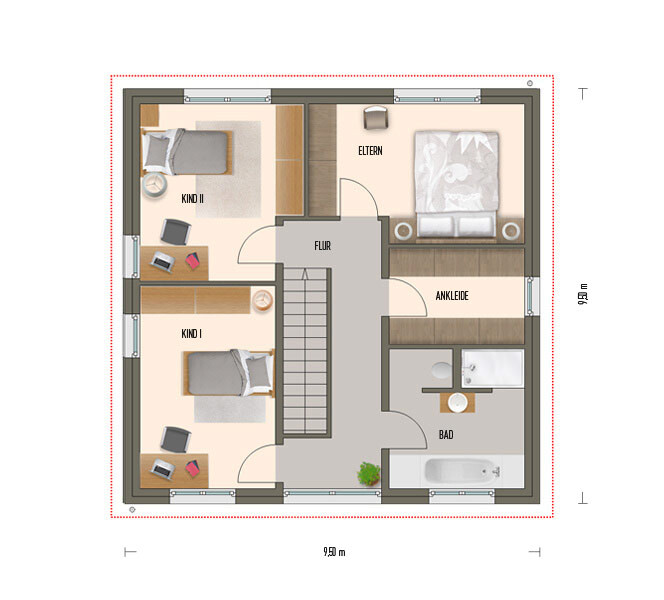

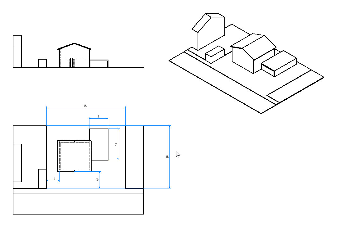

Technical drawings: side view, isometric of houses on plot, floor plan with dimensions
Floor plan of upper floor with hallway, master bedroom, walk-in closet, bathroom, and two children’s bedrooms.
House floor plan with terrace; living/dining area, kitchen, office, WC, hallway.

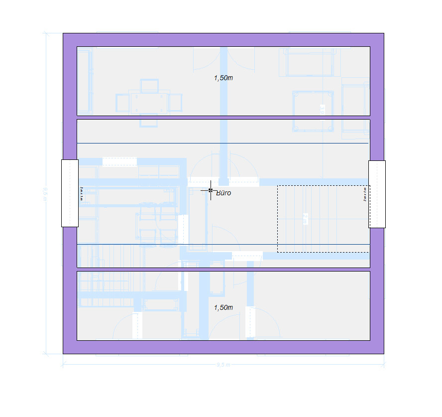

...the staircase leads up to the attic, where a small office could be set up. The attic could be finished as a DIY project to keep costs down. Additional storage space could be created under the staircase on the ground floor.
I also like the idea of using the attic as an expansion option in the shell stage for the office.
Here is the 35° pitch version with a knee wall of 1.50m (5 feet):
Floor plan of an office building with several rooms, central corridor, labeled office.

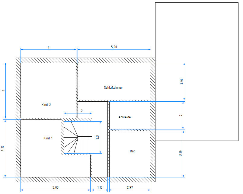

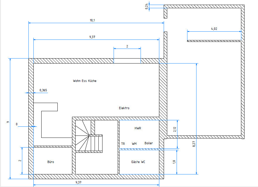

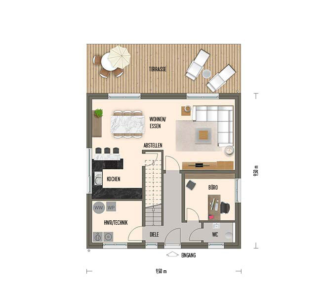

I found a better floor plan. The requirement is that the staircase fits within 2 x 2 meters (6.6 x 6.6 feet).
Grundriss eines Obergeschosses: Schlafzimmer, Ankleide, Bad, zwei Kinderzimmer und Treppenhaus.
Grundriss eines Hauses: Wohn/Essküche, Büro, Gäste-WC, HWR, Treppe, Boiler, Technikraum.

I recently saw a floor plan measuring 950x950 that I quite liked.
Finally, something reasonable: most alternative villa models with a side length of 950 avoid floor area-appropriate stair layouts like the devil avoids holy water.
kaho674 schrieb:
However, there is no office there.
There is never an office — just a leftover space that is often labeled as "office" or "guest room." Bismarck supposedly said it was good that people didn’t know exactly how sausages and laws were made — this can also apply to urban villa floor plans: 1. take an area (90 sqm (970 sqft)) and calculate the square root > 2. you get the side length (950) > 3. place the garden side at the top of the plan, orienting the living room towards it, and the street side at the bottom > 4. since the average mass-market tourist equates aesthetics with symmetry, a straight, single-flight staircase is placed in the center > 5. the leftover area is then called either an office or guest room > 6. the model is shown in a "3D" rendering on an endless meadow, with a popular company car parked beside it; additional decoration is a pretty young wife admiring the proud homeowner. DONE!

hegi___ schrieb:
I have found a better floor plan. Provided the staircase fits in a 2 x 2 meter (6.5 x 6.5 feet) space.
Are you aware that your living area will hardly receive any sunlight throughout the year? With a northeast orientation, you might catch a bit of the morning sun from the east, but that won’t be possible if there is a garage located there.
If the garage stays there (but even if it could be moved), I would at least rotate the floor plan 90 degrees counterclockwise so that the front door is next to the garage door. This way, both children’s rooms would get more sunlight. Since children live there and need natural daylight, it’s best to avoid north-facing bedrooms if possible. The kitchen would also get much more daylight with southwest-facing windows.
If possible—I don’t know the neighboring plots or their views—I would even consider rotating the ground floor 180 degrees toward the sun. However, that would require redesigning the entrance area and at least the adjacent rooms.

I have already addressed this and now created a draft with a spiral staircase. As someone suggested, this also provides more space for the wardrobe and for welcoming guests.
ltenzer schrieb:
Personally, I would prefer to orient my living spaces towards the sun. Northeast is rather unfavorable. Are there reasons why you didn’t do this, for example regarding the view or privacy?
I understand the issue with sun orientation. The reason we have chosen the current layout is that there is a main road running along the garage side. The house and garage should shield the noise from the garden and living areas, which are located between the kitchen and the garage. We will also install a ventilation system, so the windows will mostly remain closed.
