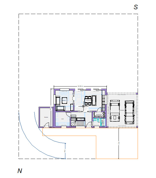

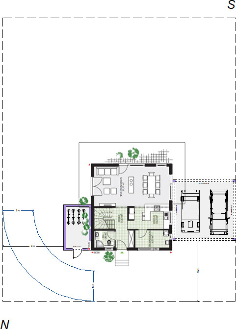

K a t j a28 Jun 2022 19:07
My plan would look something like this:
Floor plan of a house with living room, kitchen, dining area, bathroom, garage for two cars
Are you allowed to change the external dimensions if the gross floor area remains the same?

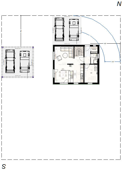

I would place the house in the north corner and have two parking spaces in front. This way, you would have an amazing garden facing southwest. If you really want a carport, I would place it like Katja did, on the west side. But not directly attached to the house, so you keep light and views there.
Grundriss und Lageplan eines Grundstücks mit Haus, Parkplätzen und Zufahrt

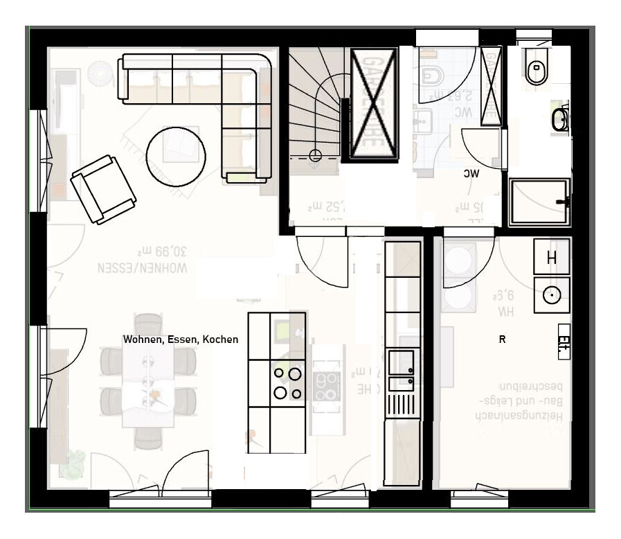

Regarding the ground floor layout: Regardless of structural considerations, I would use the space under the stairs for a built-in wardrobe. That way, the WC and utility room could be longer and narrower, allowing more space for the kitchen. I also think a door between the living room and stairs is never a bad idea, especially if there are children in the house. The upper floor can remain as it is.
Offener Grundriss mit Wohn-/Ess-/Kochbereich, Insel, Sofa und Esstisch; Bad, WC und weitere Räume.

I would position the house in the north corner and place two parking spaces in front. That way, you would have an amazing garden facing southwest. If you really want a carport as well, I would place it on the west side like Katja suggested. But not directly attached to the house, so you can keep light and views.
We are also leaning toward placing the house in the north corner. We would reserve the northwest corner for the future carport. However, to avoid building two separate driveways (= parking spaces), we would place the driveway directly in front of the planned carport.

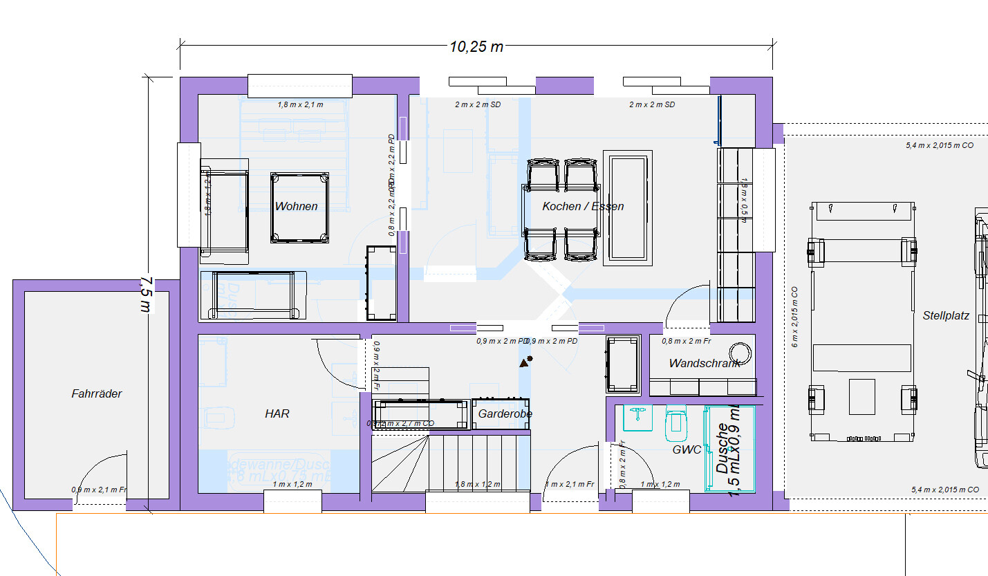

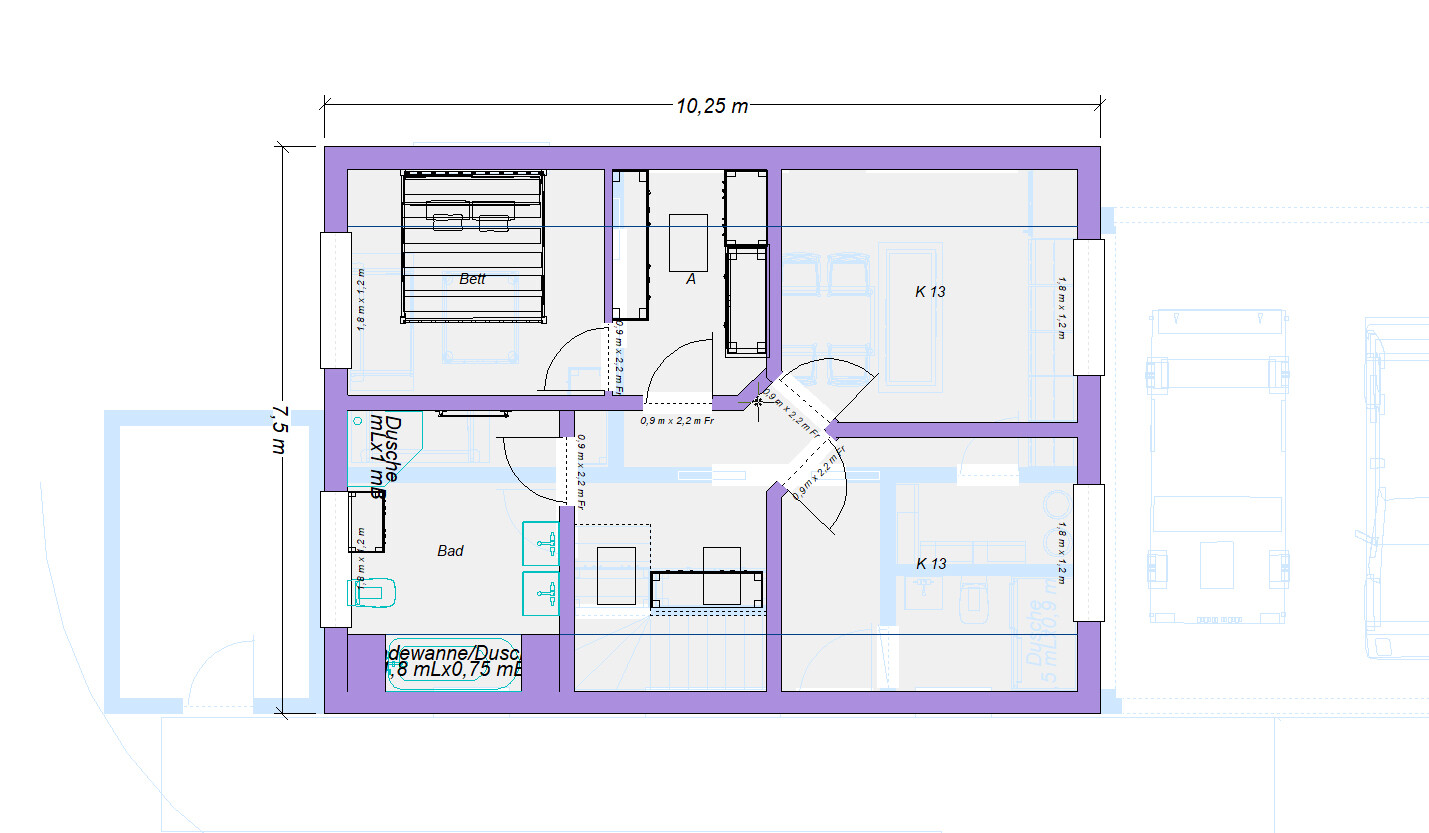

For example, like this:
Floor plan of a house with living room, kitchen, bathroom; garage for two cars, and property boundary.
Floor plan of a house: living, cooking/dining, bathroom, cloakroom, utility room, bicycles, parking space.
Floor plan of a building with bedroom (bed), bathroom, kitchen (K 13), and hallway; doors visible.
The double casement windows are not exact—they are just roughly indicated.
