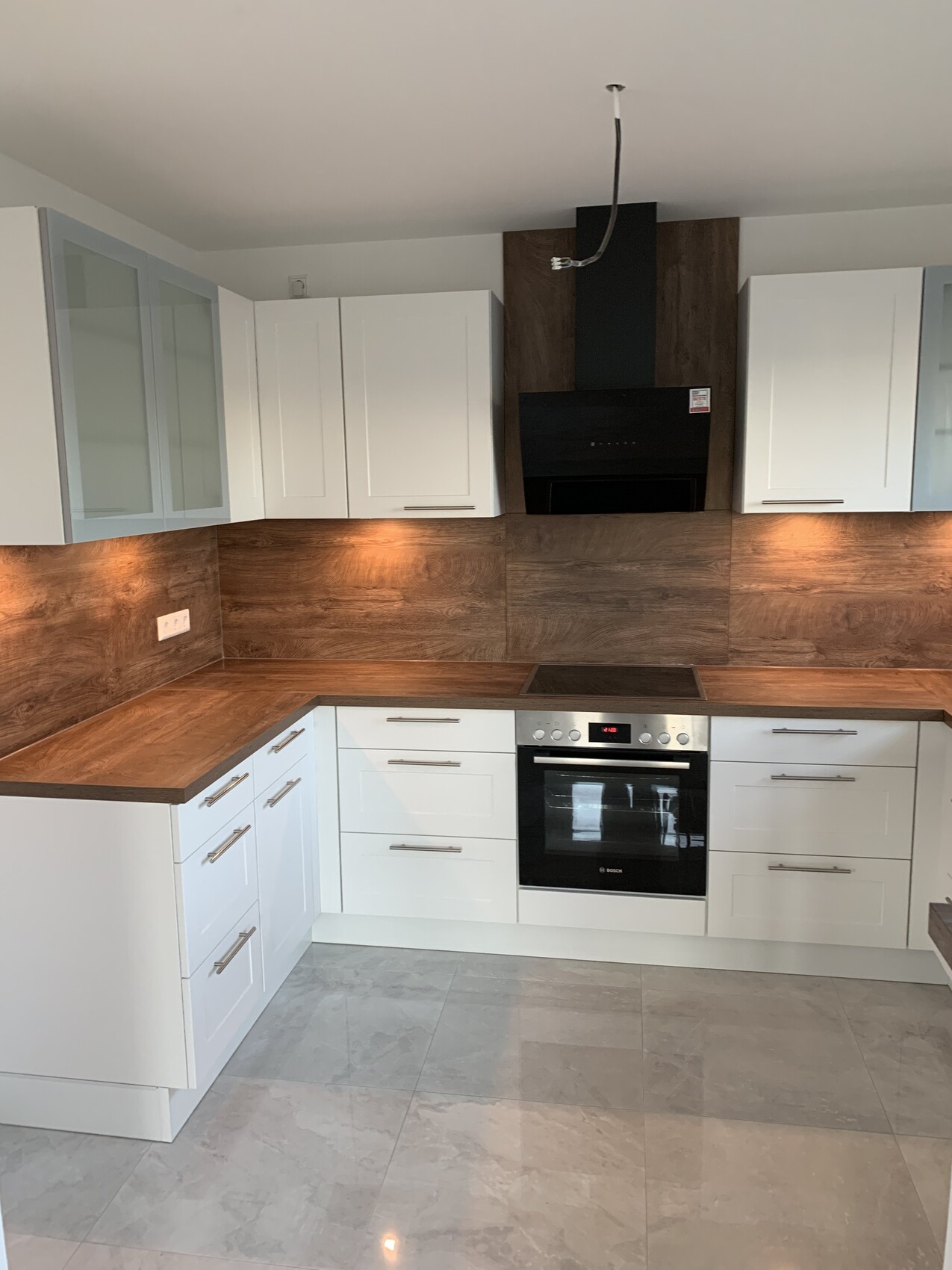

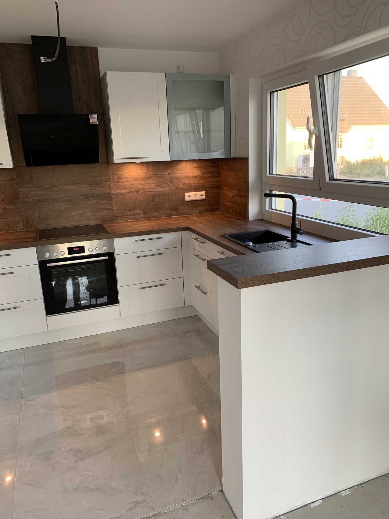

@Wattfraß
My exterior dimensions are almost the same, 7.7 m x 9.7 m (25.3 ft x 31.8 ft).
Attached is my floor plan. I also have only 100 m² (1,076 sq ft), but maybe you can use some ideas from it. To be honest, I find your staircase a bit unsuitable for the floor plan. I have a quarter-turn staircase. Otherwise, your layout is very similar. Living/dining/high area in an L shape. The kitchen is open as well. But an island… hmm…

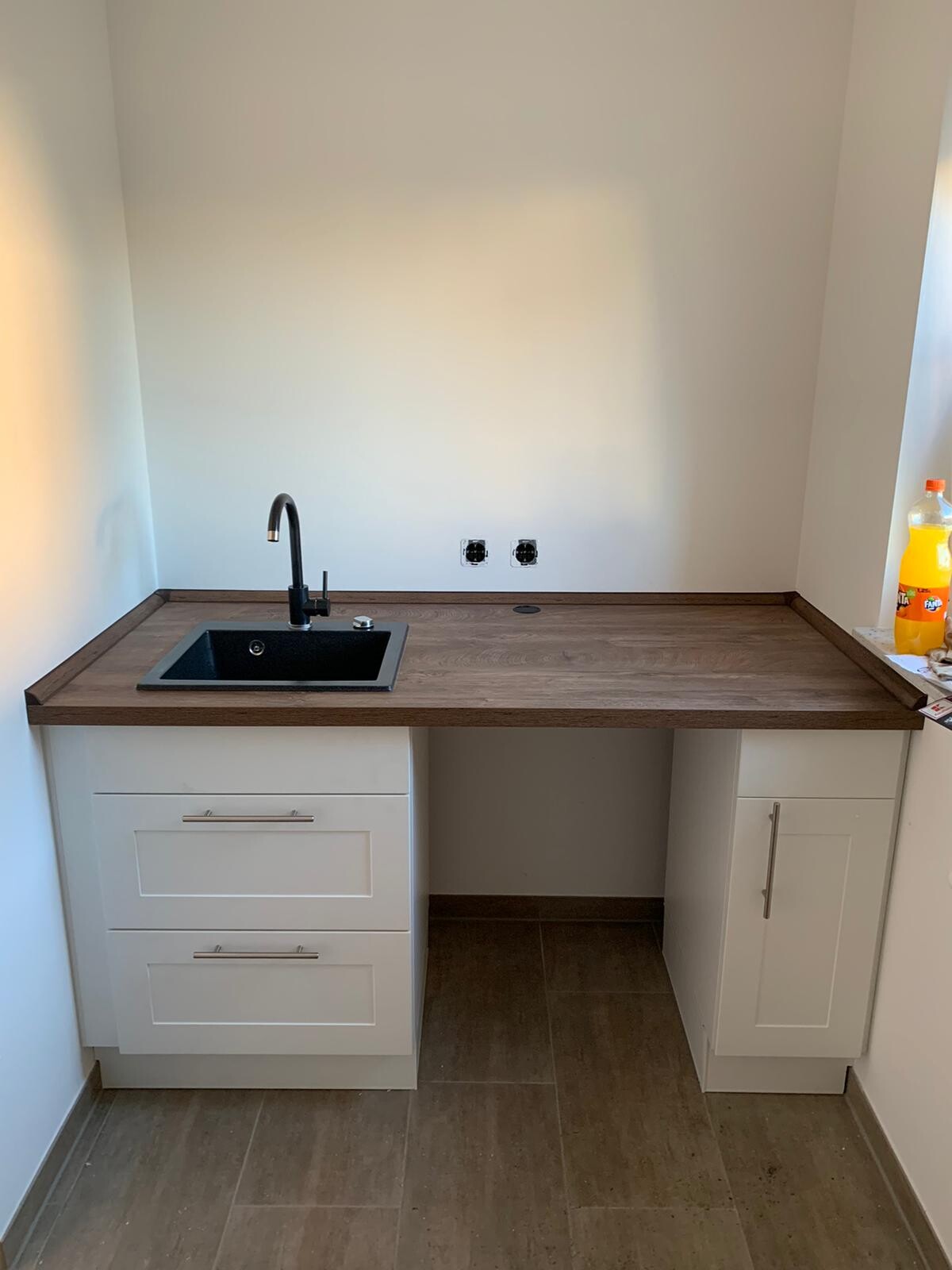

The single sink is in the “laundry room” within the utility room, on the left side in the niche when you enter.

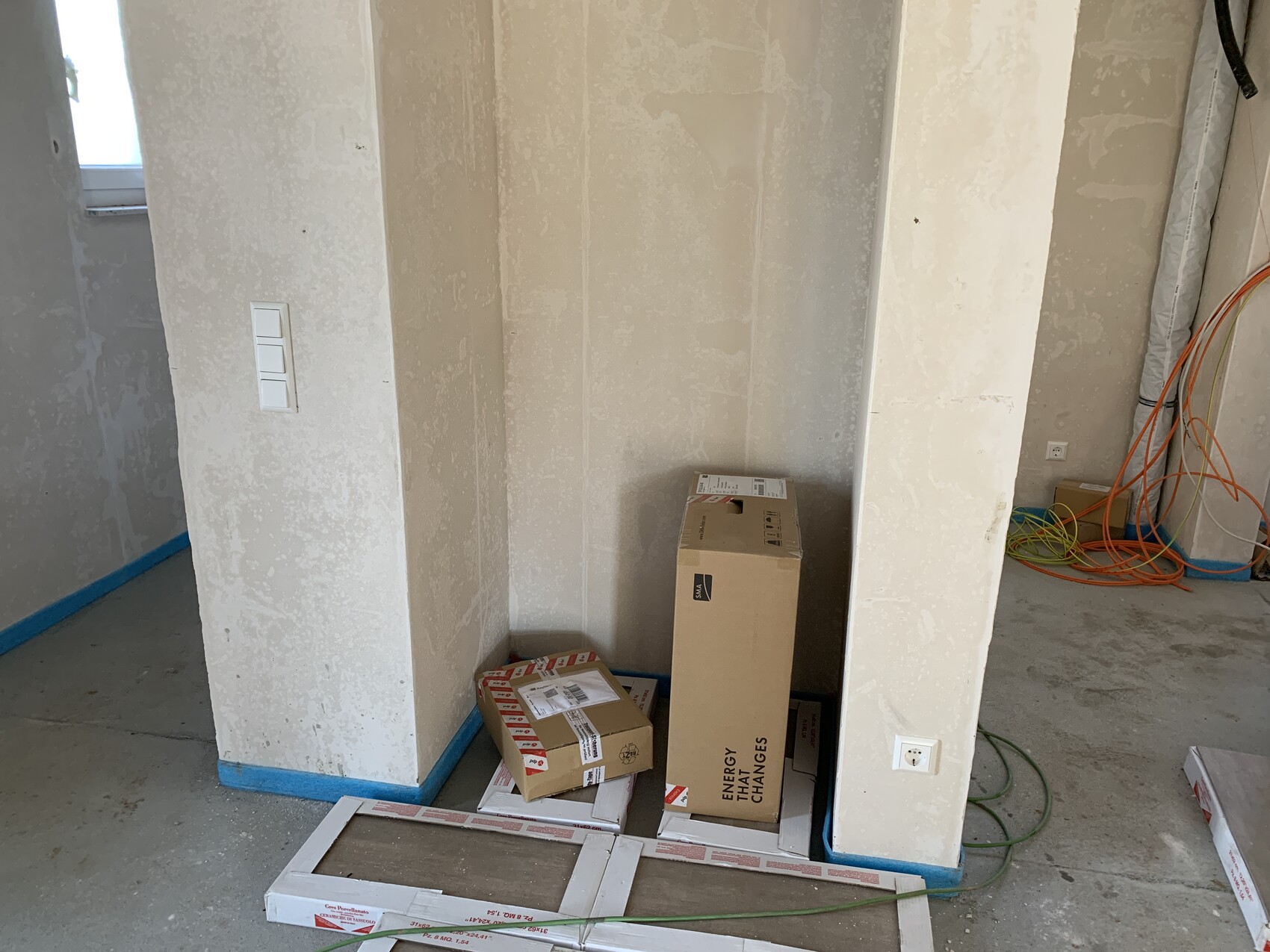

The last picture shows the niche for the cloakroom, between the guest toilet and the utility room.
