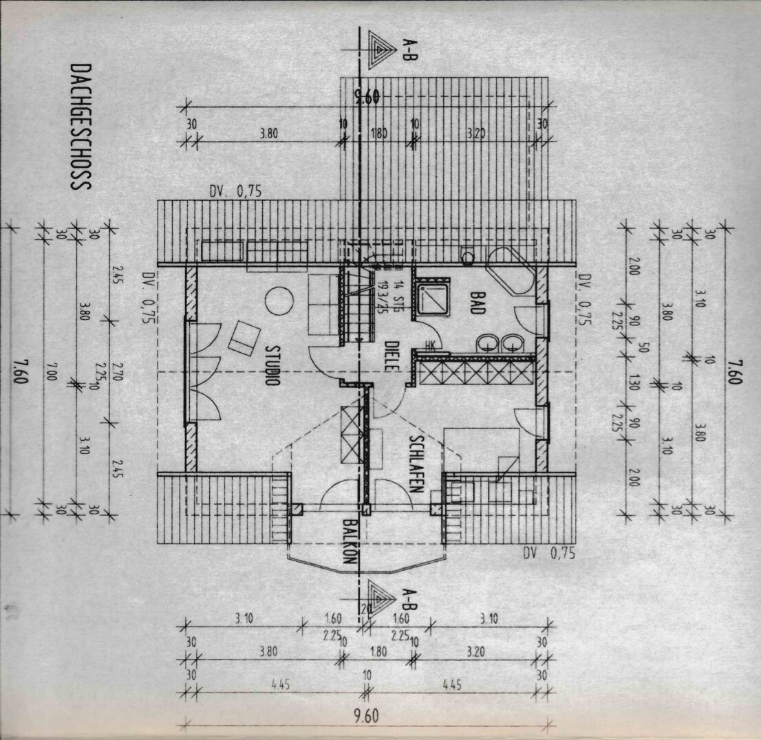

Two years ago, we bought an existing house with roughly the same external dimensions and orientation. I’ve attached the floor plans for the ground floor and upper floor. North is at the top of the plan by the entrance. On the upper floor, you would need to divide the studio into two rooms and adjust the hallway slightly.
On the ground floor, there is only a toilet without a shower. You should also consider whether you really need a shower there, especially if space is already tight.
Even though many say the staircase shouldn’t be directly at the entrance, when space is limited, this is often the most space-saving solution.
