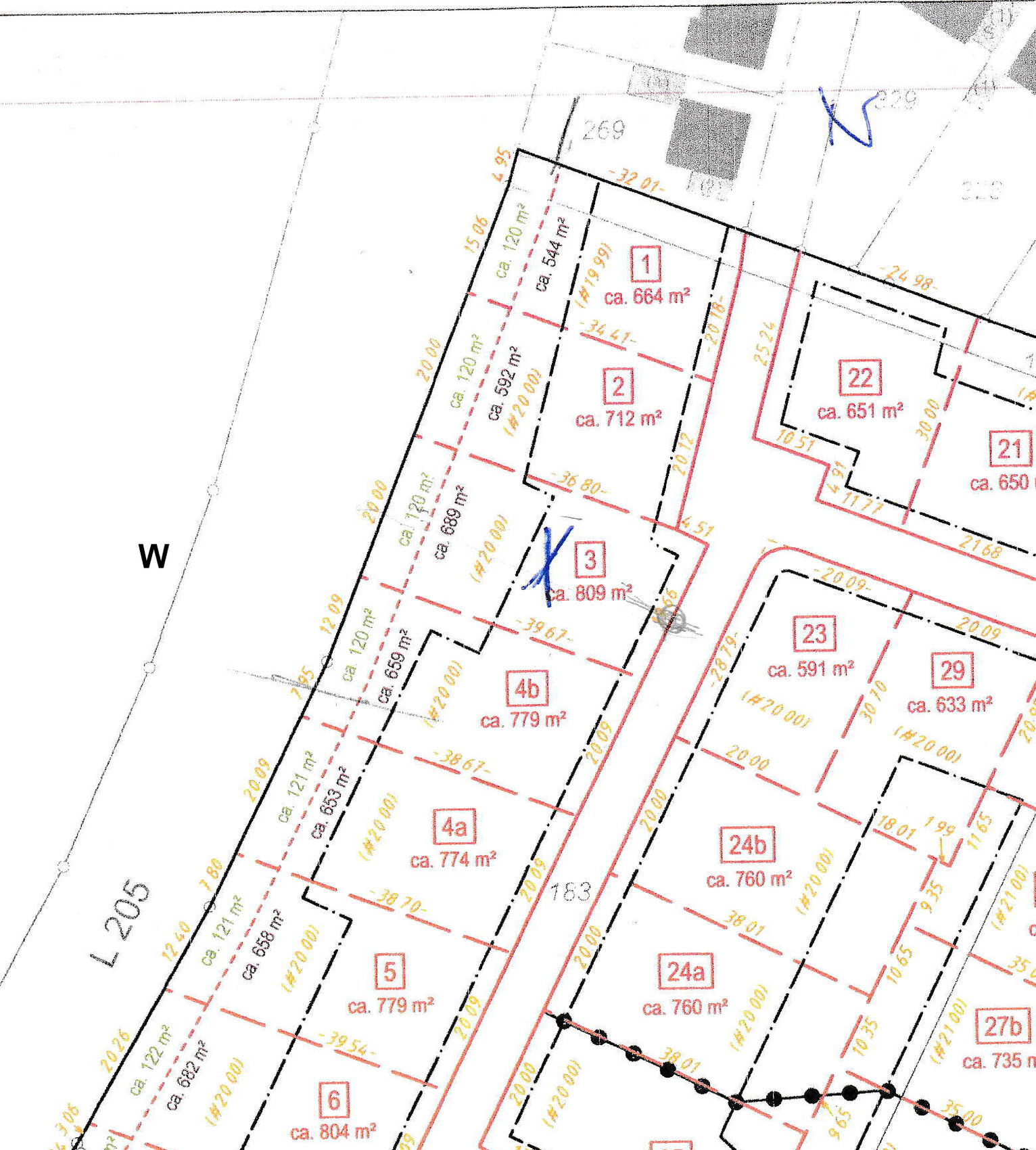

I’m attaching the site plan again because not many people can open PDFs:
Regarding your enclosed terrace: it will be a dark, uncomfortable space. At first glance, a caveman might think, "Great, a cave." But that feeling quickly fades once the family realizes it's much nicer to sunbathe in the sunlight.
I wasn’t thinking of moving the entrance – just considering a different staircase option.

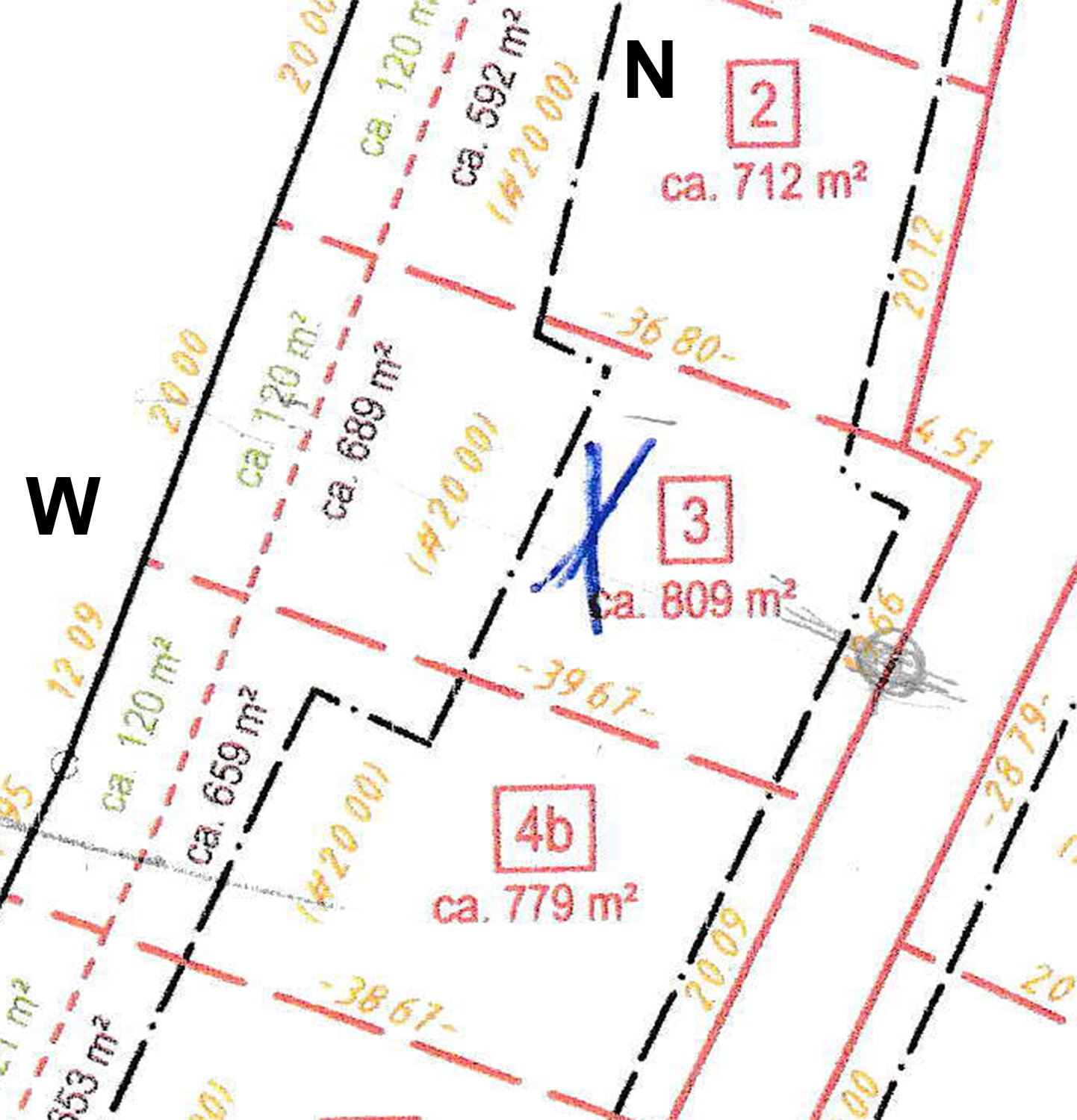

Could I please get the site plan as a jpg?
I can’t open it. Ah, I see. Here’s the zoomed-in section with the measurements again:

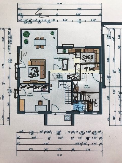

Regarding the ground floor, this partly reflects our preferences.
We wanted direct access from the utility room to both the kitchen and the hallway, so that when entering the house through the garage, you don’t have to walk all the way through the kitchen/living room to reach the cloakroom.
We are still looking for a solution. Moving the staircase to the rear and placing the entrance to the utility room close to the front door is one option.
And where would the cloakroom be? You are using the entire hallway going around the stairs, which isn’t practical.
I find the kitchen too long and therefore not very practical.
Living room: sofa placement feels cramped.
I agree with Katja about the hallway, utility room, and bathroom.
Regarding the bathroom: since part of it is above the entrance, the waste pipe positioning has to be planned very carefully. The pipe also needs to run inside the house on the ground floor. It probably shouldn’t be placed in front of the stairs, etc. There aren’t many options.
With three children, I wouldn’t want to give up the shower on the ground floor.
The conservatory faces west. Most of the wind comes from the west. For this reason, I would extend the garage closer to the street and enclose the corner with bushes, so the wind can pass through the leaves and no wind pockets (is that the right term?) form.
A door to the storage room on the terrace doesn’t work well; it’s better to place it out of sight around the corner.
I would shorten the kitchen, maybe add a prep island, and behind it, a pantry/backup kitchen. The utility room should be accessible from the front and also have wardrobe cabinets for five people. Count the number of your jackets and shoes for the whole year.
The WC with shower and window should be positioned so that cabinets can be installed as well.
I made a sketch:
... but I still don’t find it fully coherent — especially regarding the kitchen and cloakroom.
Unfortunately, it’s difficult to simply move a staircase by half a meter.
Better to opt for a complete redesign!
derJohnson2 Apr 2018 17:27Hello Yvonne,
Thank you very much for your detailed response and your drawing!
Unfortunately, I forgot to mention that the furniture/kitchen shown in the drawing is not planned by us. The sofa should be arranged as you suggested.
We are planning a U-shaped kitchen that runs along the upper end of the house, leaving the U open towards the utility room below.
What I just realized, which I honestly hadn’t measured before, is that the kitchen will actually be quite small.
The wall facing the garage is only about 3m (10 feet) long, which does seem quite limited for a U-shaped kitchen, or am I mistaken?
If I allow for a 1.50m (5 feet) walkway, that adds up to 6.50m (21 feet), of which approximately 2m (6.5 feet) is taken up by the stove, sink, and refrigerator, leaving an effective work surface of 4.50m (15 feet). That seems rather little to me. Our current rental apartment has only 50cm (20 inches) less countertop or kitchen space.
The wardrobe is currently planned under the stairs, which are designed to be open.
Regarding the pipes in the upstairs bathroom, I asked our builder, and he said it wouldn’t be an issue. I will check again just to be sure.
The note about the wind is also good; we haven’t considered that yet. I’ll need to have that checked, especially since it can be quite windy there.
About your drawing with the kitchen, utility room, and pantry: I discussed it with my wife. We’re not very fond of this idea because we want to use the full width of the house for the living area. The current proposal creates a large square room that will feel quite small due to the small wall to the left of the entrance. Without that wall, there would be no small separation for the “TV area.”
On the other hand, redesigning the ground floor bathroom with access to the utility room is definitely a great idea—that’s exactly what I meant in my previous post to Tanja. We had a similar suggestion from another builder.
The downside is that combined with our wish to use the entire width of the house for the kitchen and living area, the utility room becomes quite small.
What changes did you mean with the 4 crosses on the guest room side facing the living room?
Should the wall be moved?
derJohnson
