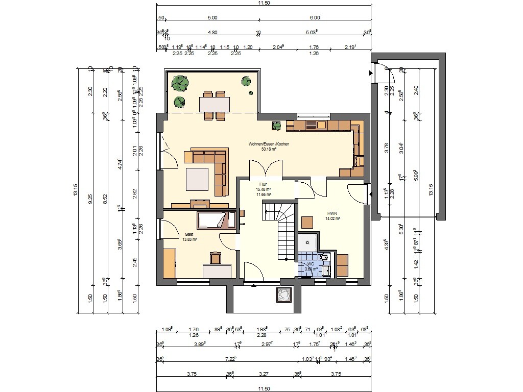

Currently 2 adults, both 30 years old, a 6-month-old daughter, and planning 2 more children within the next 4 years
Space requirements for ground floor and upper floor
No precise square meter expectations. Generally a very generous open living, dining, and kitchen area, as we believe most family life will happen there.
Currently used as a home office; in old age, it is planned to convert the office into the master bedroom for single-level living

Open living, dining, and kitchen area; otherwise closed architecture due to the expected noise level from 3 children
Conservative or modern construction
Rather conservative
Open kitchen, kitchen island
As mentioned above, not necessarily a kitchen island; prefer the stove against the wall
Number of dining seats
Kitchen with U-shape layout, breakfast bar extending into the living area
Main dining table in the conservatory

The wife works shifts, so access to the bedroom through the dressing room is preferred
Who is responsible for the planning?
What do you especially like? Why?
The highlight will be the spacious conservatory in the living area. Anyone who has visited the show home by Stommel Haus in the prefabricated house village in Frechen will understand – it inspired us because we were absolutely enthusiastic about it. My father is a carpenter and will install an open “fake” beam ceiling inside, which will then be finished with a pale whitewash.
What do you not like? Why?
Basement floor plan: Personally, I would prefer the shower access in the upstairs bathroom to be from the side, so water does not splash into the bathroom while showering.
Ground floor plan: Are there options to redesign the staircase (wall), so that one can look directly at the double doors to the living room from the entrance?

What is the most important/basic question about the desired floor plan, summarized in 130 characters?
As mentioned, I would like feedback on the "everyday practicality" of our floor plan idea. Suggestions for improving the upstairs bathroom and staircase position welcome.

derJohnson schrieb:
Okay, maybe this sounds a bit more dramatic than I actually intend.
In the utility room, besides the heating system, I want the washing machine, with the dryer stacked above it, and a shelf on the wall facing the kitchen for canned goods, jars, and other non-perishable items that you occasionally need while cooking.
That’s pretty much all I planned for the utility room—I didn’t want to include a proper pantry.
And definitely no workbench [emoji1]
But thanks to Katja’s suggestion, maybe I don’t need to, because there will now be a proper pantry [emoji1]Huh?
I think you’re probably imagining it will be easier than it actually will be.
You want to wash and temporarily store laundry for five people in the same area where you plan the internal entrance, which also gets traffic from dirty shoes. Plus a small shelf for food items.
Later on, there will be a freezer cabinet added. Then a tool cabinet for common tools, decorations for household use, mops, vacuum cleaner, all kinds of cleaning supplies. Empty bottles, beer and water crates, recycling bags, paper waste, and so on.
Most homeowners building over 150 sqm (1,615 sq ft) either plan a second utility room on the upper floor or a fixed staircase to the attic if they build without a basement.
Storage space is missing, and especially none for seasonal clothing.
At that point, the size of the freezer room doesn’t help much when everything is piled together in 10–12 sqm (108–129 sq ft).
Edit: The freezer room in our house is the coolest room because it’s built without underfloor heating. The beer stays at a perfect temperature.
Edit: The cold storage room is the coolest room in our house because it was built without underfloor heating. The beer is kept at a good temperature. Really? In our house, the geothermal heating system is located there, and all the pipes start in that room. That’s why it’s always cozy. It’s actually only cool in our pantry.kaho674 schrieb:
Really? In our house, the geothermal heating system is located there, and all the pipes start from that point. That’s why it’s always nice and warm there. It’s only really cool in our pantry.I have no experience with geothermal heating. We use gas. Do you have underfloor heating?
The underfloor heating controls are usually situated more centrally in the house. In our case, they are under the staircase, where the cloakroom is – the perfect spot for letting yeast dough rise [emoji4]
derJohnson5 Apr 2018 19:48ypg schrieb:
Huh?
I think you might be underestimating how complicated it will be.You might be right, ypg.
As I said, the proposed changes from Katja will actually free up quite a bit of space.
We also just talked to our home builder, and he said that if it’s structurally okay, then making changes like that is definitely possible without any issues.
Regarding the pantry, we might also leave out the heating there.
But something like a small ventilation flap—my parents have one in their closet—doesn’t work anymore with today’s insulation standards.
