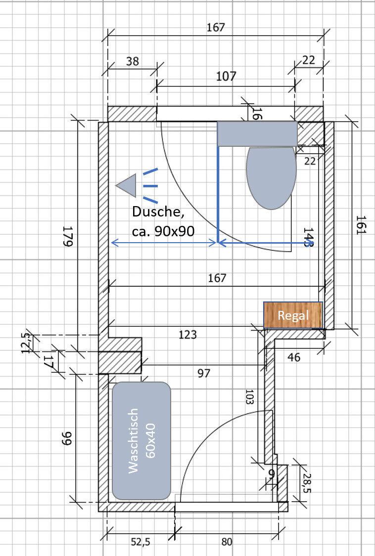

Bathroom floor plan with shower, toilet, washing machine, and shelf
The window as a double casement, but both sides operable, with a glass partition between the sashes in the middle. The glass partition can be connected and sealed to the window’s central mullion within the reveal using an additional aluminum profile or similar. A drywall construction with tiles might also be possible there. An operable window allows better ventilation, so it shouldn’t be fixed glazing. The gap between the sashes, where the mullion is visible and accessible, only allows for a narrow profile or a glass pane. You can avoid this by using two separate windows instead of a double casement, with a coupling profile in the middle. This makes installation and sealing much easier.
With about 90cm (35 inches) left for the shower, you still have a usable 70cm (28 inches) for the toilet. It’s not spacious, but comfortable enough for people of average build. The wall-hung frame system needs to be extra slim so the toilet is centered (I assume the drain line runs straight through the ceiling). The washbasin should be placed at the entrance, and the door should be reversed to open outwards.
